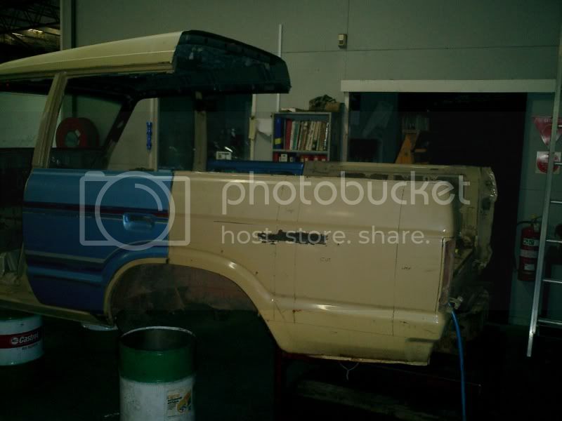

The engine i hope to get is just a long motor, no manifolds, so i have a bit of work ahead of me. If the plan goes right it will end up a turbo 1HZ bobbed single cab ute.

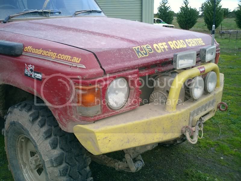

I like your bull/winch bar even though its a little close to the radiator.Is it off a 75 series?
How about some pics and info about the supercharged 2H?
The engine i have was free. It has injectors, pump, waterpump, etc. need manifolds and electrics. There easily come by.
The bull bar i made. The winch looks closer to the radiator in the pic. There is actually 4 inches clearance between the winch housing and the radiator. And before anyone ask's, No i wont make another one. It was a prick of a job.....
