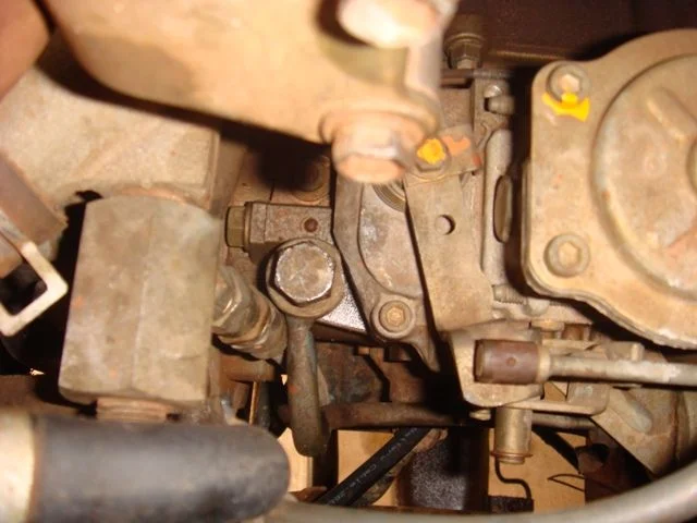

So I tried to pull the fuel intake where it joing the IP off. Couldnt get it to come apart. As I undo it the pipe also twists around. I tried pushing a screw driver between the intake pipe and the body of the IP (see photo) with no result.
I could feel it was a little loose, but the pipe seems to be stuck to the bolt. Is this normal?
Anyone got ideas how I could seperate them? Is there any sort of gauze filter in there? Im thinking if its not air its gotta be dirt.
I really dont want to bust that pipe off its mount....

Hi chris. There is a mesh filter under the banjo bolt(thats the one that is stuck) From memory they are supposed to be torqued down so you dont have this problem.
At this point I might leave it with a good diesel shop,they have probably done this before
