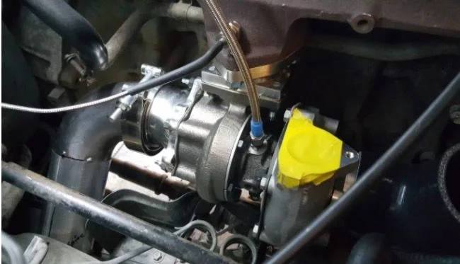

Ive thought about putting a turbo on it w/Intercooler. Not to make big towing power but in hopes of bringing a bit more efficiency to the engine but at 22:1 compression that spooks me.
Everything GTSSportcoupe said is spot on however if you don't have the budget for a 1HDT there are still options.
I've driven the exact same vehicle (77 Series + 1HZ). I drove it both normally aspirated and turbocharged / Intercooled. I have a 1.5 mile steady incline leading into my house and prior to the turbo I would see 1,100+ degree EGT's and a steady loss of speed. (Sound familiar?)
With a properly installed and tuned turbo (plus Intercooler and 2-1/2" - 3" exhaust) those temps dropped to 600-700 degrees and very little, if any drop off in speed. Perhaps not a cheap solution but a solution none the less.

No wonder.... you push more air and add more fuel to get more power... More air = cooler EGTs. As long as you don't add too much fuel you have more power and cooler EGTs.
Without turbo to get more power you add more fuel your AFR drops and your EGTs are climbing... you keep choking it with fuel and it slows down even more...

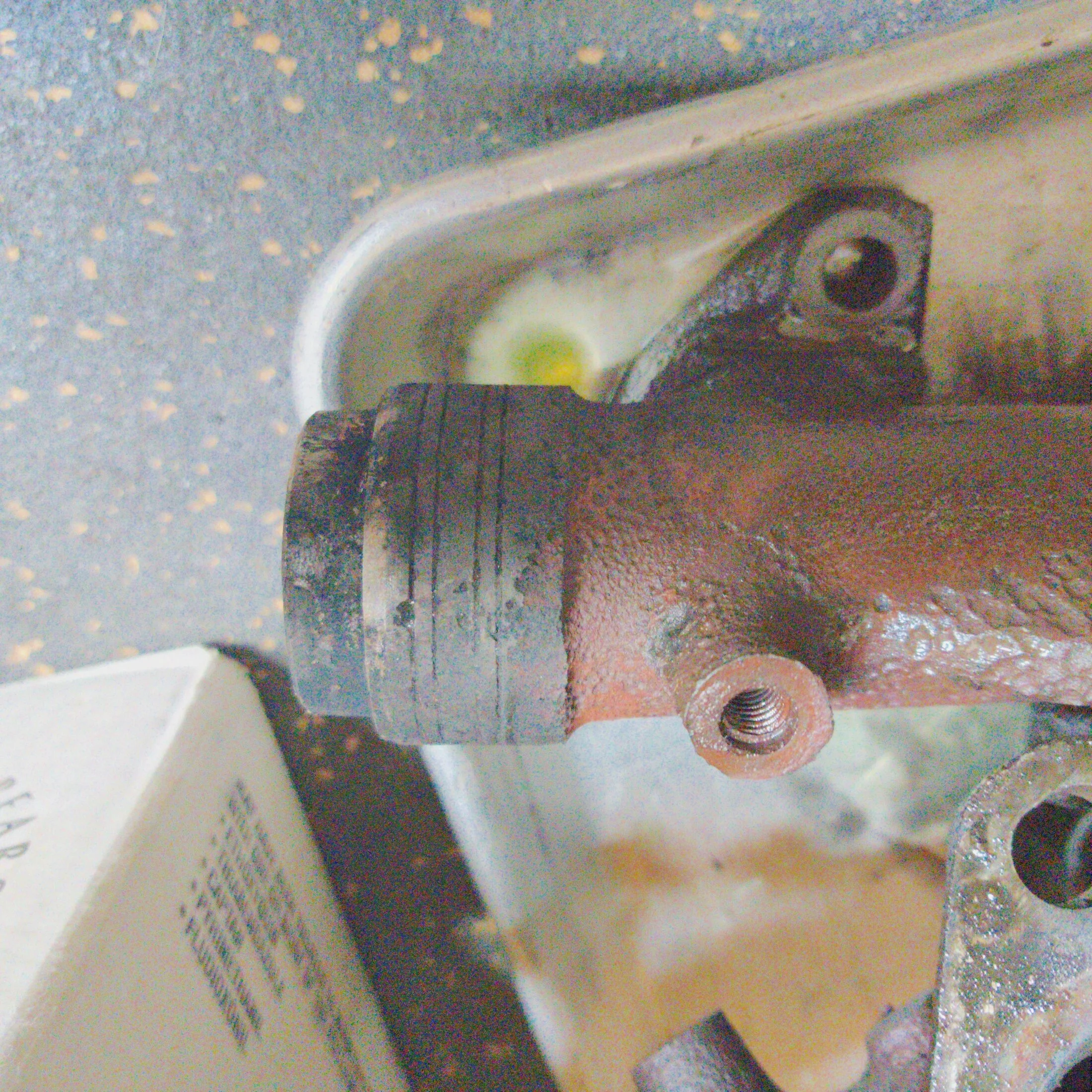

I have a 1991 HDJ81w/1HDT and am installing a Gturbo 350 and PDI Intercooler kit. My exhaust manifolds are in decent condition, the small one is pitted and should be replaced. Do you have a suggestion for a decent not overly expensive header? And a replacement radiator? Is aluminum the way to go?
