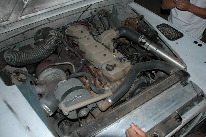

Hey Rob, nice to see you are thinking of doing a Rover swap. I have messed around with these trucks for a long time.
Although I agree that the 2.5L Rover or the HS2.8 is the easiest swap, I have found that a 6 cylinder engine fits just fine with some minor mods. This is a 109, leaf sprung, but it's very similar to a D90/110... I am sure the 1HZ would fit just fine if you moved the trans back a bit. I have been saving a 1PZ for a Rover build, I think it would fit in a stock series (with the short nose).
6BT109...
6BT109...

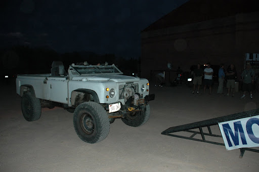

How much lift have you got in there? Looks like 6-8 inches.
Mine is about 2 inches over a factory 1 tonner, although on a 90 you would need about 4 inches of lift. This is with the deep BT engine, with a 1HZ you would have scads of room... But the cyl head would have to be up against the firewall, like a factory 2.6 6 cyl 109.
Note the location of the rim and the bottom of the door, it's not as tall as people think. The 6BT fits really well in a Series/defender, it's all the rest that can't stand the torque...
The 6 cylinder firewall was a series part only, none of the defenders have them, the defenders were only V8 or 4 cyl diesel. Did you have the 6 cyl firewall already?
I'm looking at the distance from your hub centre to the top of the front wings. It looks like you're 6-8 inches up on stock.
There are a couple of 4BT series swaps on 4btswaps.com, I can't remember how much lift they were running. The Isuzu needs no lift in a defender, in a RRC or disco it's 1 inch either body lift or pack the front bottomout bumpers.
My truck runs a 4 cyl bulkhead...
A 6 fits fine - I have proof, you have, um, an opinion?
