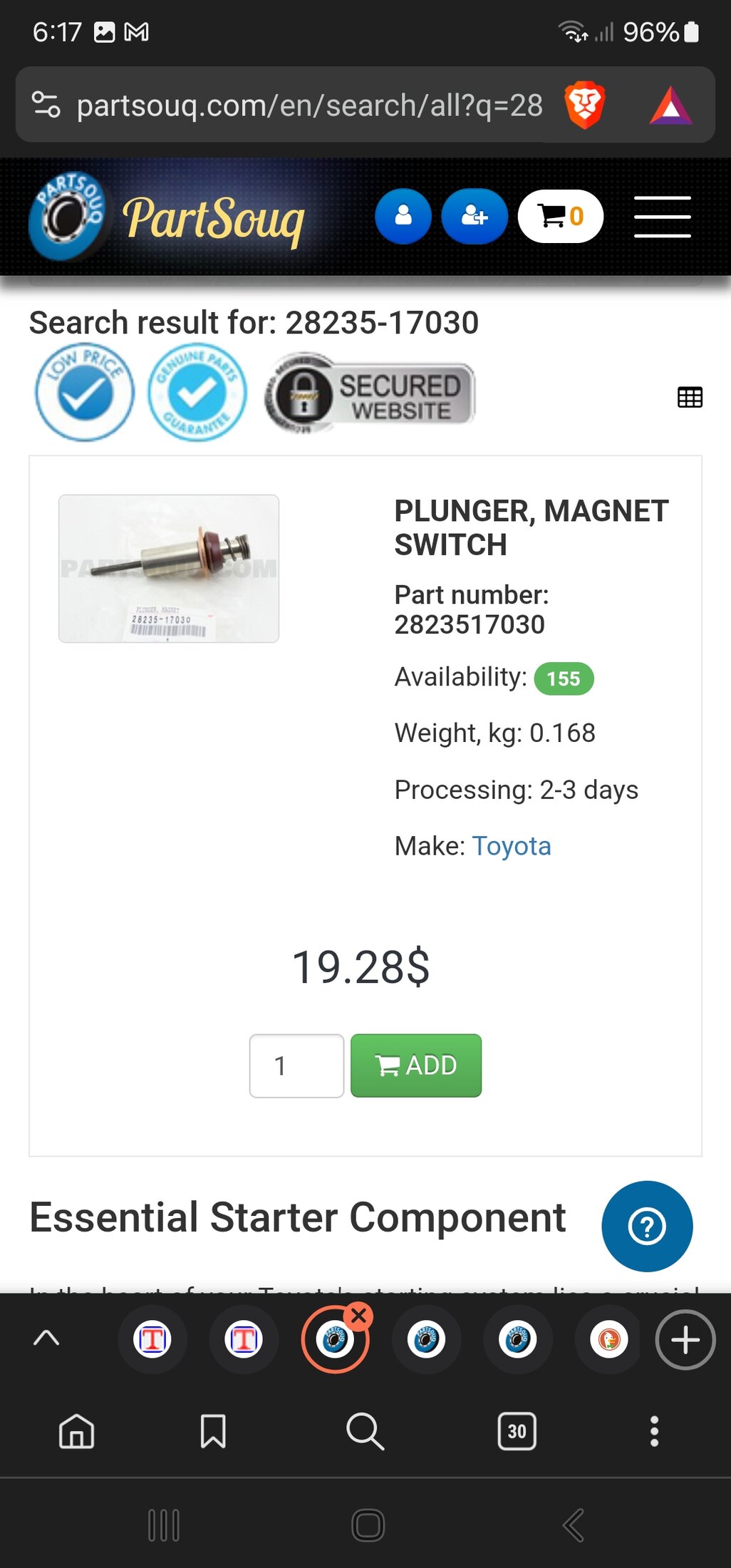

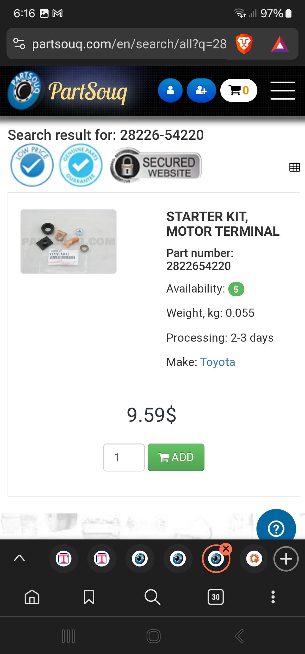

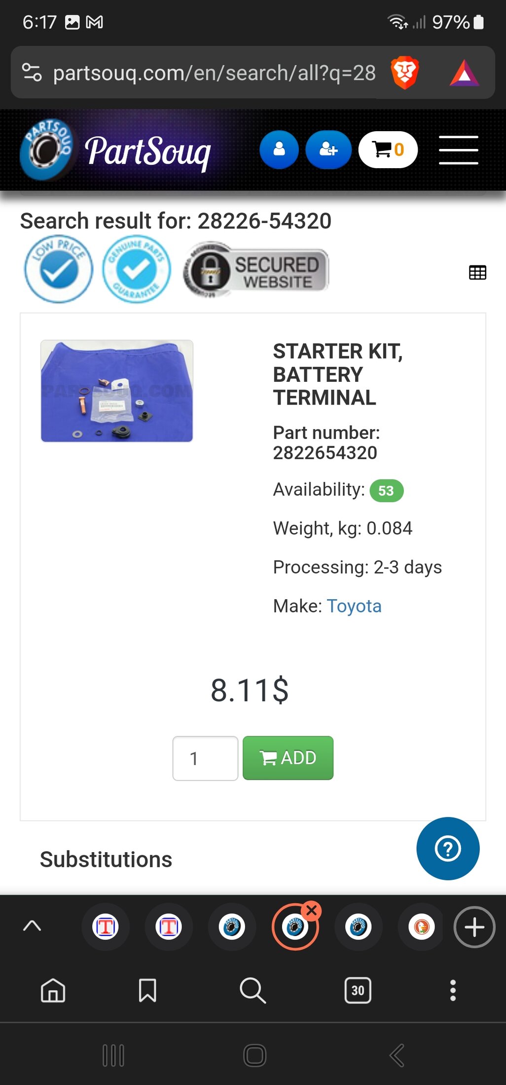

While you have it out, replace the plunger and terminals. $40 bucks worth of parts plus shipping. You've done the hard part in pulling it out. Even if it's not your problem, fresh plunger and terminals is a good idea.

View attachment 3682651View attachment 3682652View attachment 3682653
