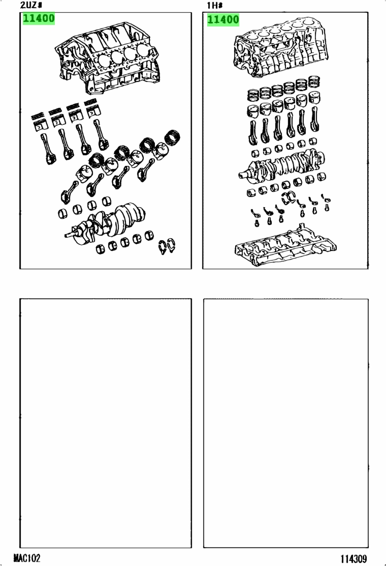

And for anyone interested, here is the short block,
And here is partial engine assembly,
