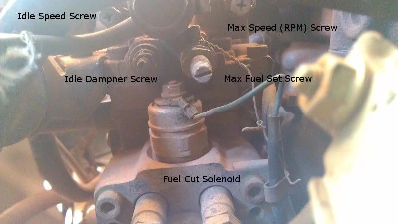

A quick way to set it is to have the truck warmed up and idling, turn the idle down to just below (100-200rpm)where it should be via the idle lever stop screw. The dash pot should be adjusted out all the way while doing this.
Then adjust your dash pot "in" to bump the idle back up to where you want it. Give the lever a couple stabs with each turn to stabilize the setting. This should get you dangerously close.
Another thing to note is that upon reassembly of the top cover to pump housing, the bumper tip can be ignored and snapped off when tightening down the top cover. The throttle lever inside must be moved forward to allow the bumper to slip in. Ask me how I know. Its entirely possible some of these pumps no longer have a intact dash pot bumper. Lol.
Hi yotahead.... have I labelled this photo correctly?
Pretty sure its a 1HDT pump courtesy of crankycruiser :)
