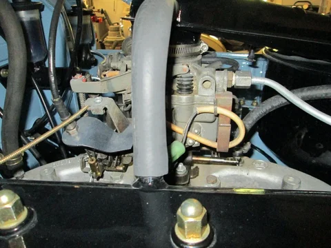

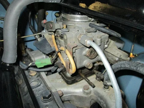

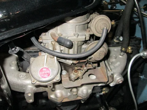

Fish...sorry it took so long to grab some pics. The pic of the cables shows the vinyl coated accelerator cable and the choke cable is the yellow zinc one. If you follow the black cable you can see the cable adaptor I made. Hope these help.

My 1970 F has a one barrel carburetor with an adapter underneath it that adapts to the two barrel manifold and came that way from the factory according the parts diagrams I have seen. So I wonder how early the manifold was only for a one barrel carb?
