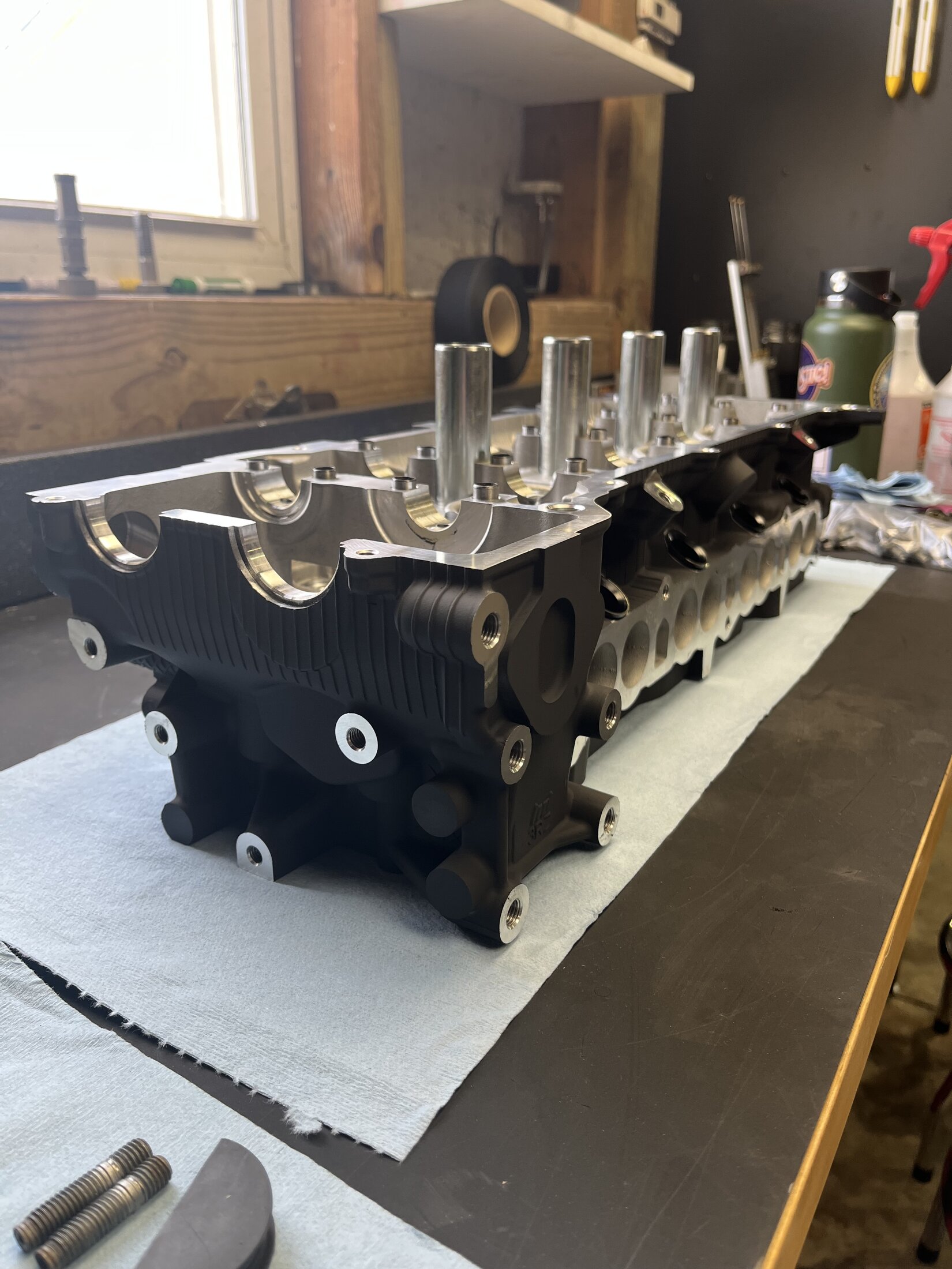

Finally got to doing a leak down test which has led me to believe it is a blown head gasket between cylinders 2 and 3. I decided to buy a new remanufactured head with all new gaskets. Idk if there’s any issues with existing within my current head, but better safe than sorry. If my current head turns out to be good then I’ll just keep it as a back up. The new head is set to arrive tomorrow so I’m hoping to begin work this week. We’re finally getting snow here so I’d really like to have my 4x4 through the winter as much as possible. Wish me luck on this removal/install! Any tips going into this are welcome and appreciated, thanks.

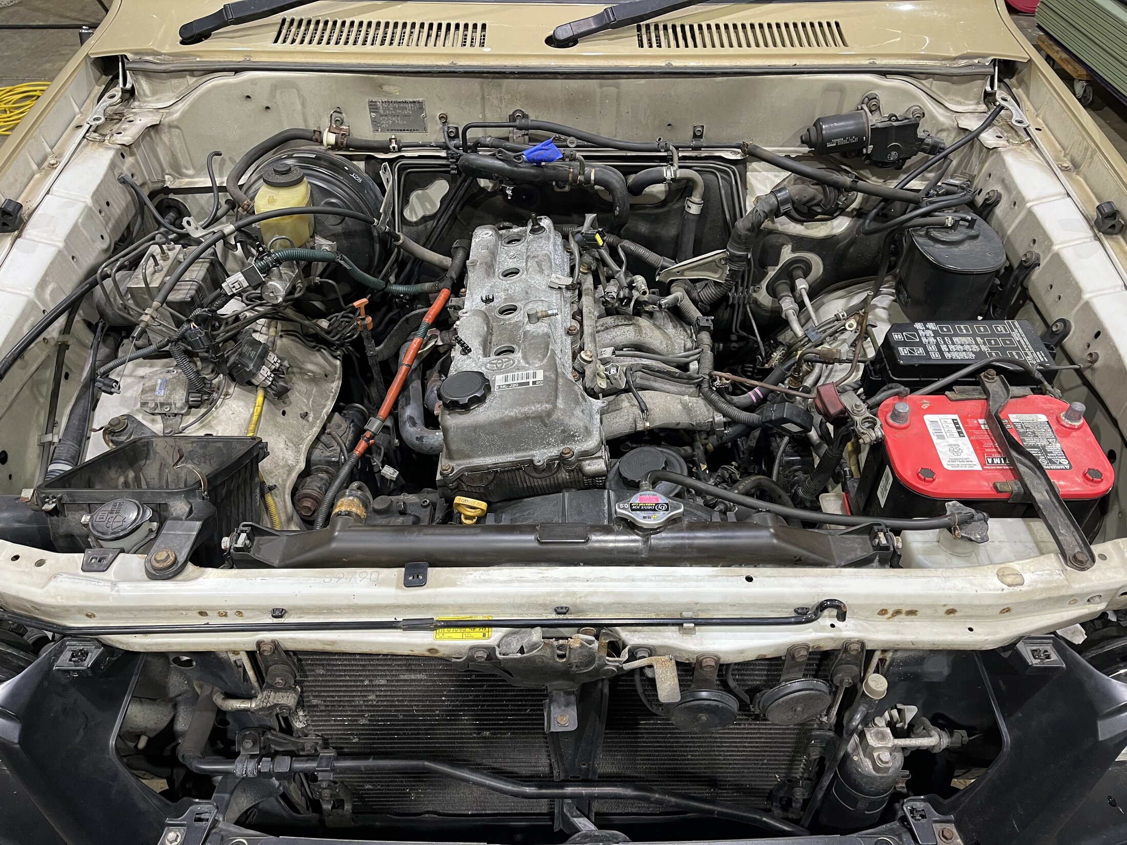

The tear down has officially begun today! I’m fortunate enough to be able to utilize my shop space at work to accomplish this, I’ll be putting in as much time as I can on this each day, optimistically 4-5 hours a day with lunch time and staying after working hours. Hopefully that means it won’t take too many days! Planning to paint my valve cover while I have it off too, excited to get some feedback on it 😎
Managed to get the head off today just before cleaning up and heading home. The gasket looked fine at a glance, but I’ll inspect more closely tomorrow

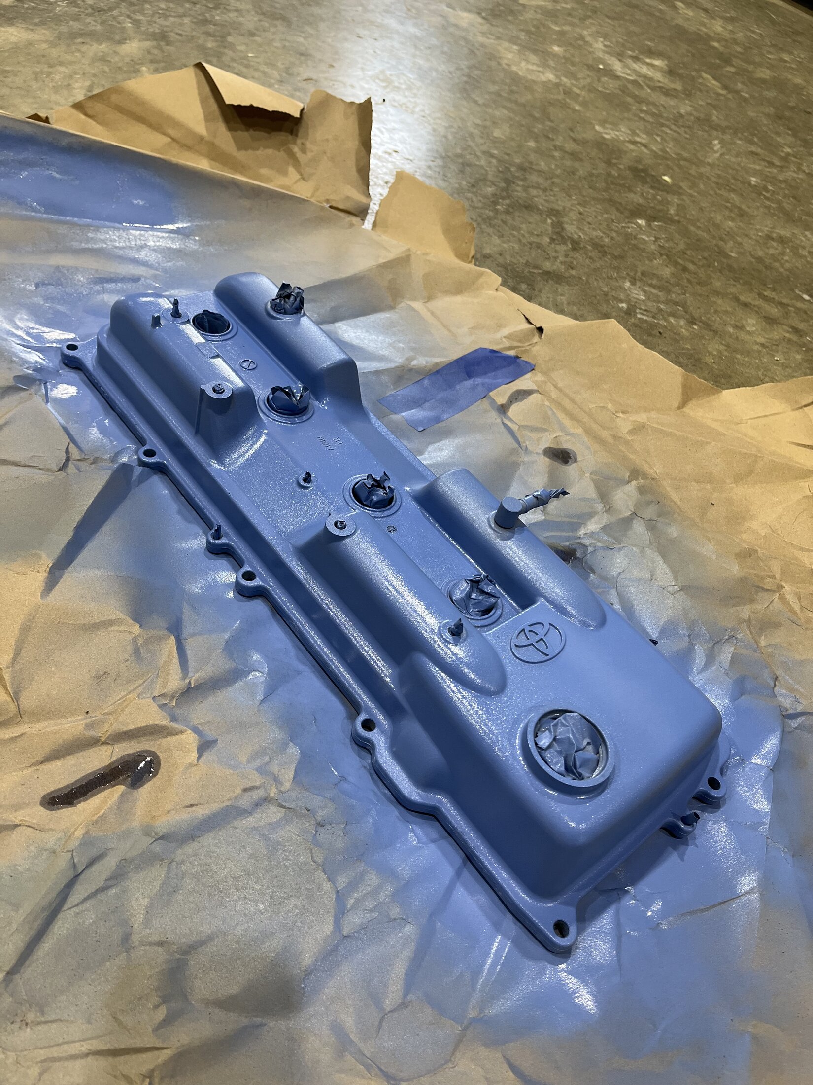

Less progress today, but managed to clean the pistons and block surface with a scraper and honing stone. Also replaced my thermostat because more and more I’m thinking this was an over heating issue. After inspecting the old head and the old gasket I think the head simply warped, thermostat was sticking so I didn’t know. Also got paint and clear coat on the valve cover! Color reveal!
Wasn’t able to do much this morning, I need to chase the bolt holes on the block but my shop didn’t have the proper size tap. Next week I’ll resume with hopefully nothing to stop me. I got some pictures of the final look of the valve cover after clear coat and curing. Lmk what yall think! I’m pretty happy with how it turned out. Its gonna be really bold in my engine bay!

The head gaslet didn't look obviously blown, but hard to tell from a single picture.
You mention a shop. What have they done? Did they confirm the head was warped and skim it? Have they had the valves out to check the valve seats and margins? Or at least tested the valve seal in the head?
Hopefully they have done these, but if not, I certainly wouldn;t be rebuilding that engine until it was clear what caused the low compression on two adjacent cylinders.
The shop only did a compression and leak down test for me, I bought a fully built brand new head to put in it, the old head hasn’t been tested in any way yet.

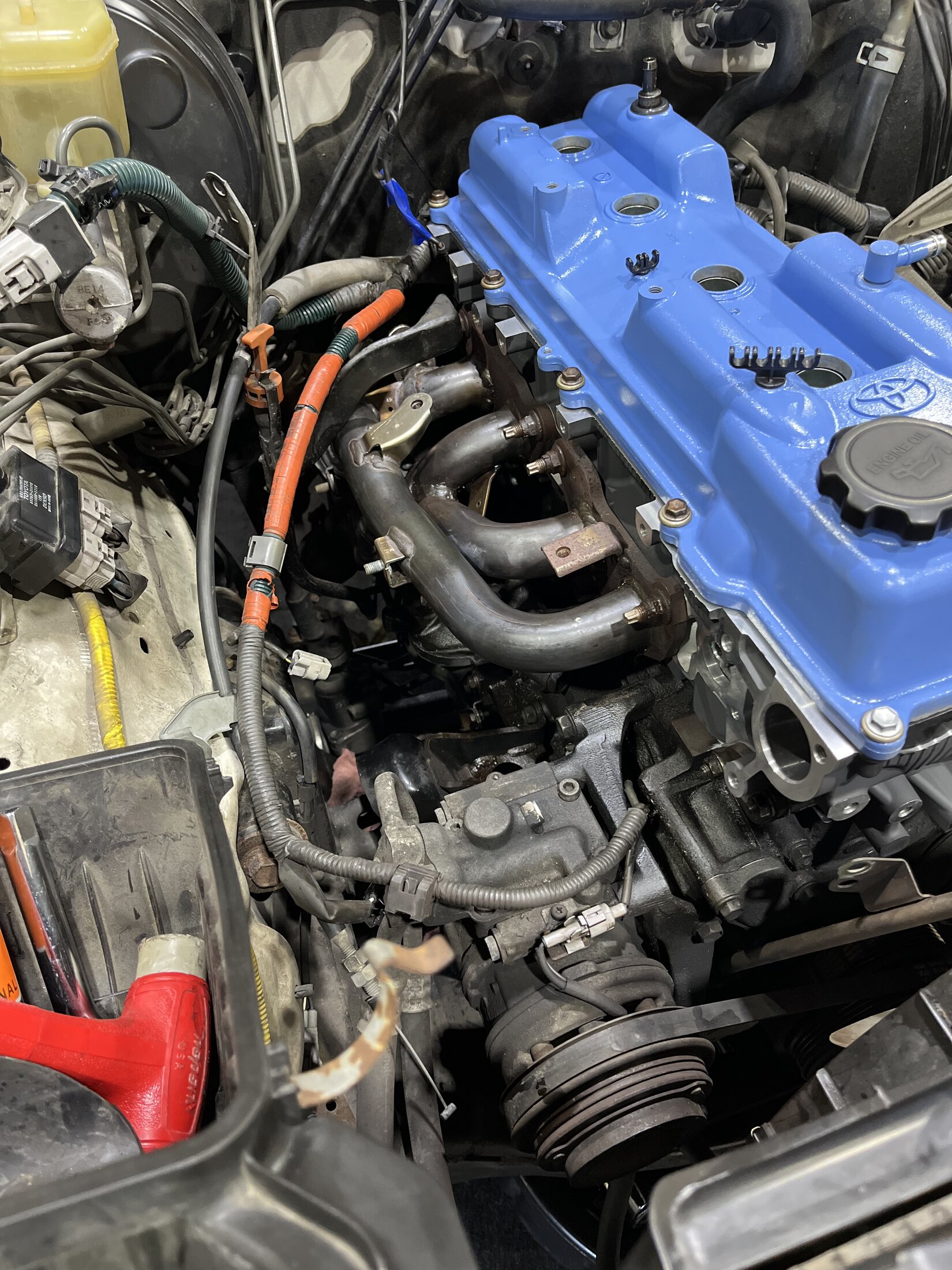

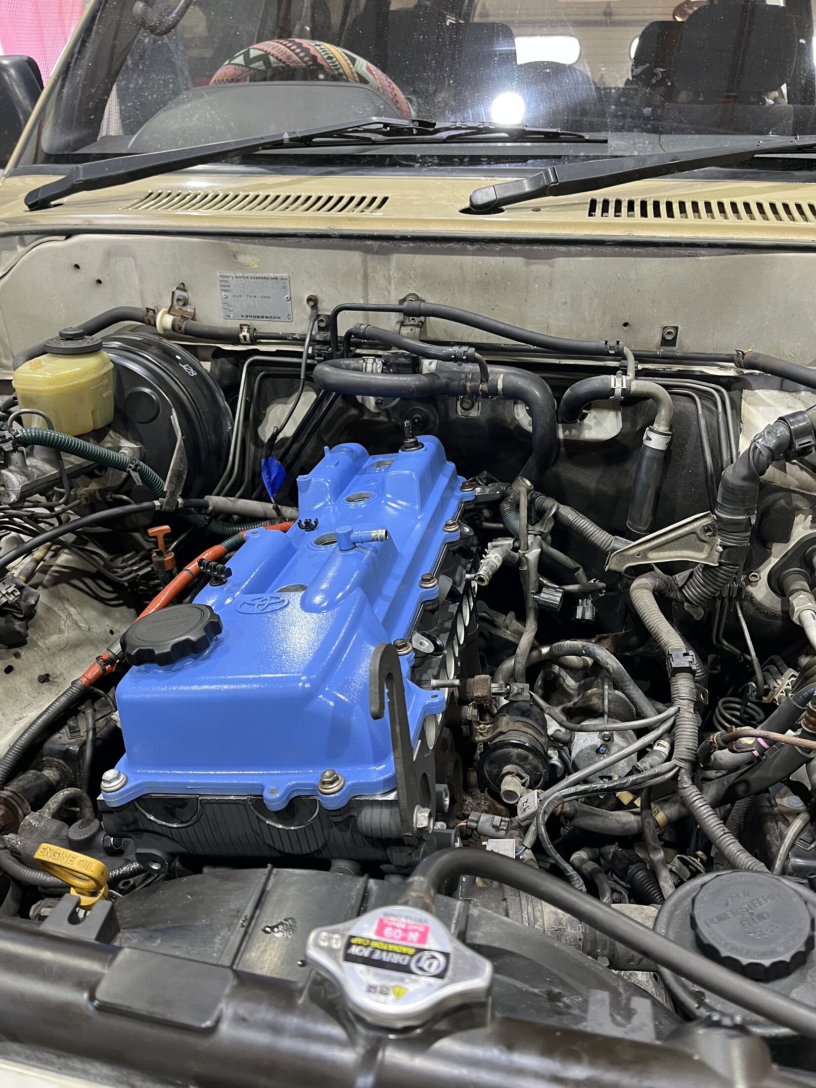

Great update time! So I didn’t mention it in my last post, but I had a fuel leak at my injectors (I thought it was a small issue not worth mentioning). I came to realize that I needed injector cushions/isolators, found some locally and installed them today, lo and behold it fixed the poor idle that I assumed was some sort of timing issue! It’s running great! It didn’t seem like it was losing a lot of fuel, but apparently it was making a huge difference. I got everything buttoned up today and drove it home, and later into town and back with no issues! Praise God! Only thing I see is a small coolant leak from one of the hoses under my throttle body, I’m guessing it’s cracked, so I’ll replace it this or next week. I also installed some new LED head lights today. I’ll take some photos tomorrow to post 👍 big thanks to everyone who helped me through this repair!
