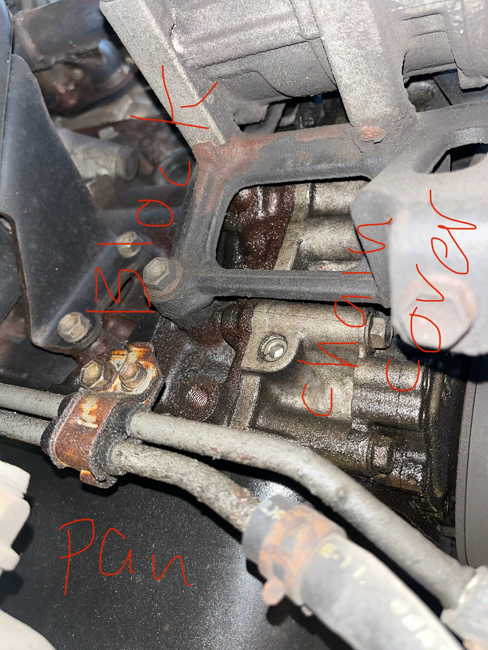

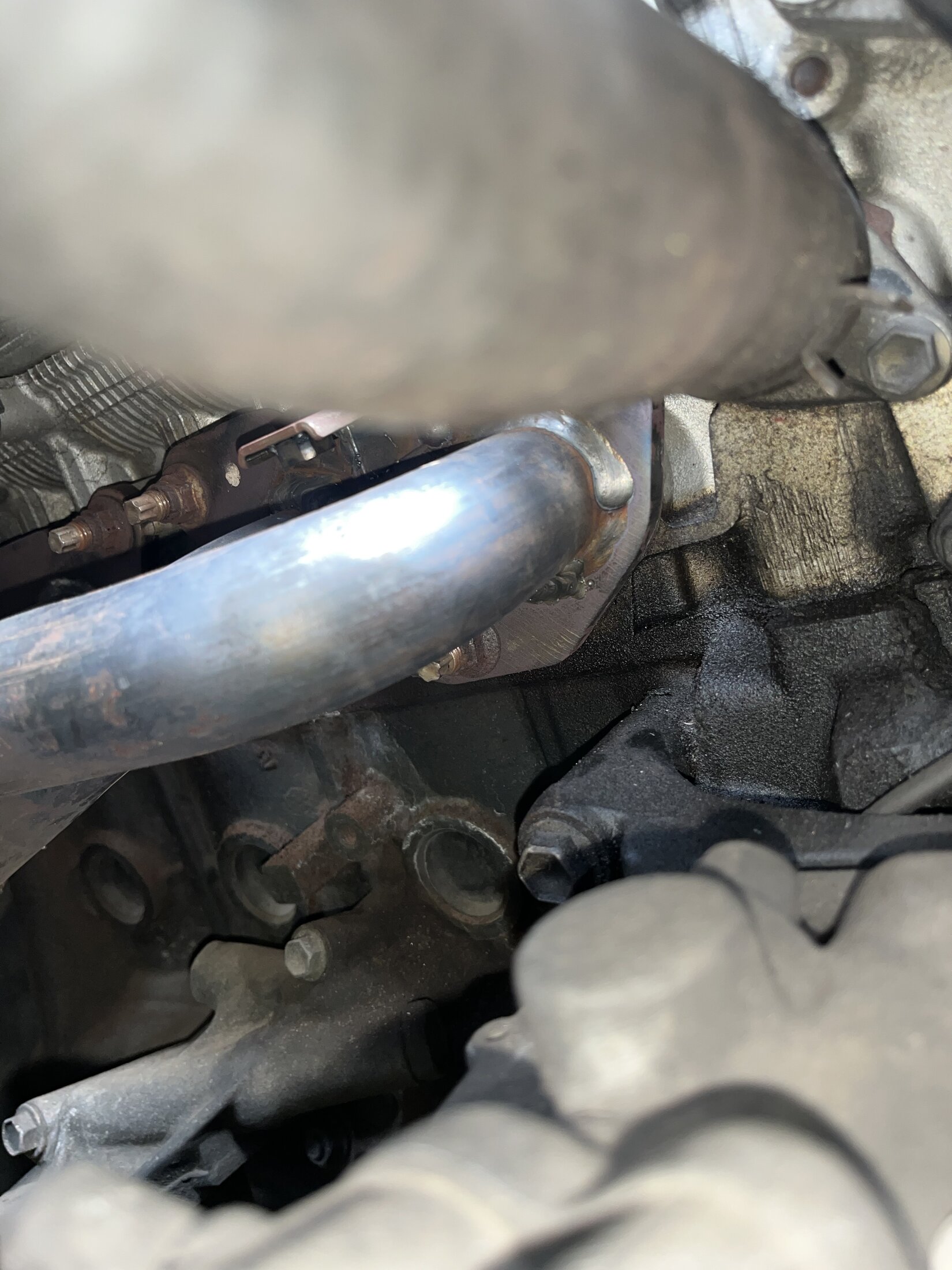

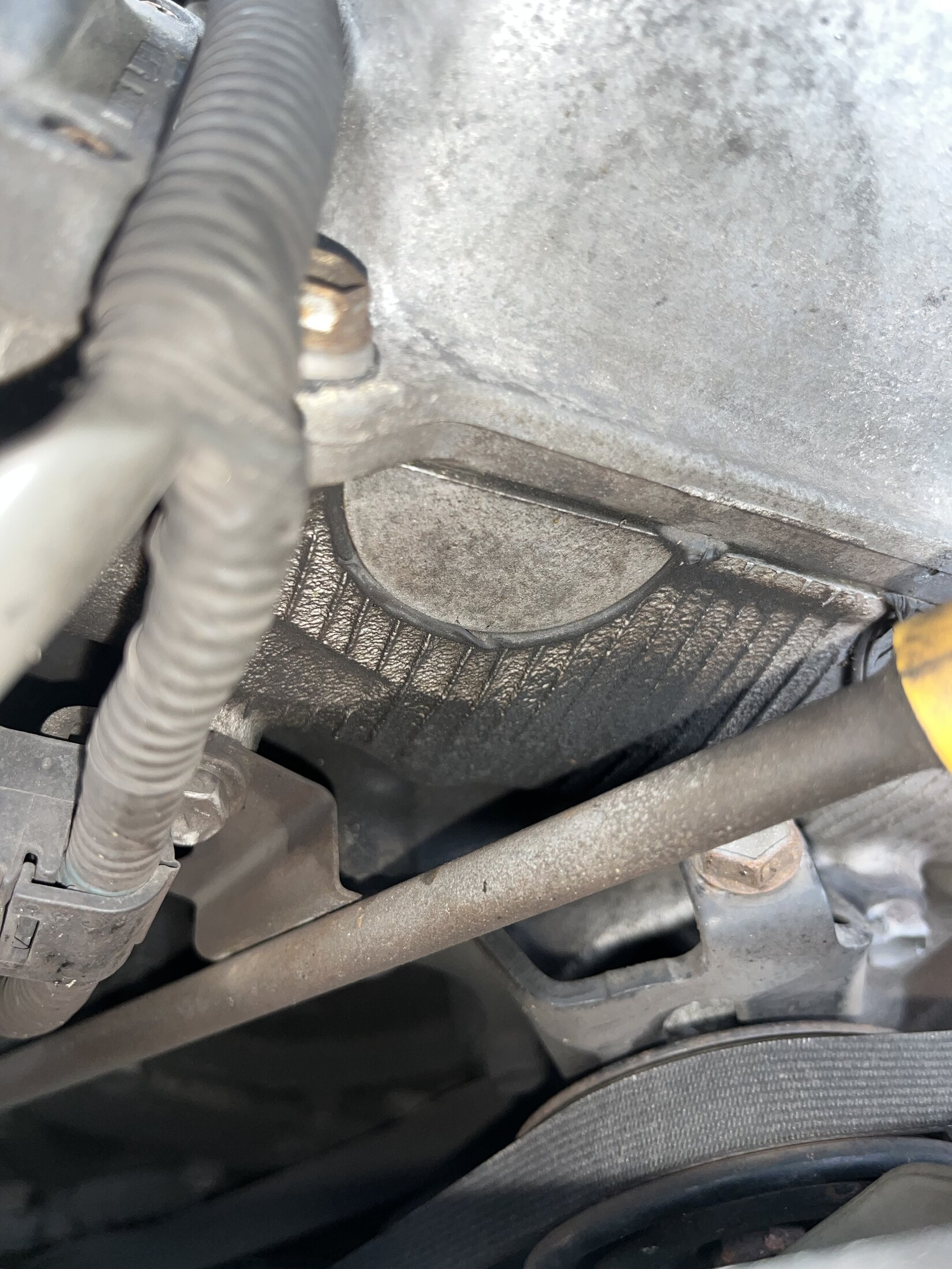

My rzj95 has been idling increasingly rough over the last 2ish months, I’ve been trying to track down what it is with no luck so far.
I’ve replaced:
PCV valve and grommet
Exhaust header and gaskets
My best guess now is maybe my valves need adjusting?
Yesterday I finally noticed that there appears to be a leak on the exhaust side of the engine. Wet and dirty on the block and header a little and on the timing chain cover. No dripping, no milky oil, no loss of coolant. But wondering if the issues are related??
I’ll attach photos, any help would be super appreciated!
Thanks
Going to update this in case it’s helpful for anyone later on. My next step on this list of things to check/fix was a valve adjustment. Upon checking my clearances I saw that ALL my exhaust clearances were very tight .004-6 too tight on most. So naturally I got my new shims ordered and replaced them all, checked new clearances and every valve is now in the center or slightly loose side of the spec. I turned my truck on and it sounded pretty much the same, the sound was just a little quieter. After considering my findings on the tight valves and all the oil build up on the side of my block I’ve determined that my tight valves have led to a blown head gasket, just beneath my exhaust manifold. I haven’t been running the truck, the oil doesn’t look milky and I’d like to keep it that way. For anyone else with this motor, your warning sign to do a valve adjustment is a slightly rougher sounding idle when it idles low. That what I ignored before going on a big camping trip. Don’t do what I did. Save yourself the head ache!!
.. After considering my findings on the tight valves and all the oil build up on the side of my block I’ve determined that my tight valves have led to a blown head gasket, just beneath my exhaust manifold...
How do you conclude that?
Shrinking valve clearances indicate valve seat recession. If the valve seat and margins are bad, compression will likely be bad. No connection at all to a blow head gasket.

My understanding was the tight exhaust clearances could have resulted in too much pressure inside the cylinder, causing the gasket to blow. Also noticing the new build up of dirty oil on the side of my block right at the head gasket, and the sound coming from the same area. Admittedly I am still very novice in the world of engines so my understanding of this may be flawed. I’m open to looking into other potential fixes, replacing the gasket isn’t exactly easy for me to do at home.
How?
I think it would be a good idea to read/watch some very basic information on internal combustion engines. Recession of valves would cause very tiny (negligible) decreases in cylinder pressure and would not have any connection to a blow head gasket.
Blown head gaskets are diagnosed by low cylinder compression, mixing of oil and coolant, combustion gases in the coolant system. Not by a simple oil leak.
I strongly recommend that you do not dismantle your engine without getting a proper diagnosis, and without supervision from someone who knows what they are doing.
