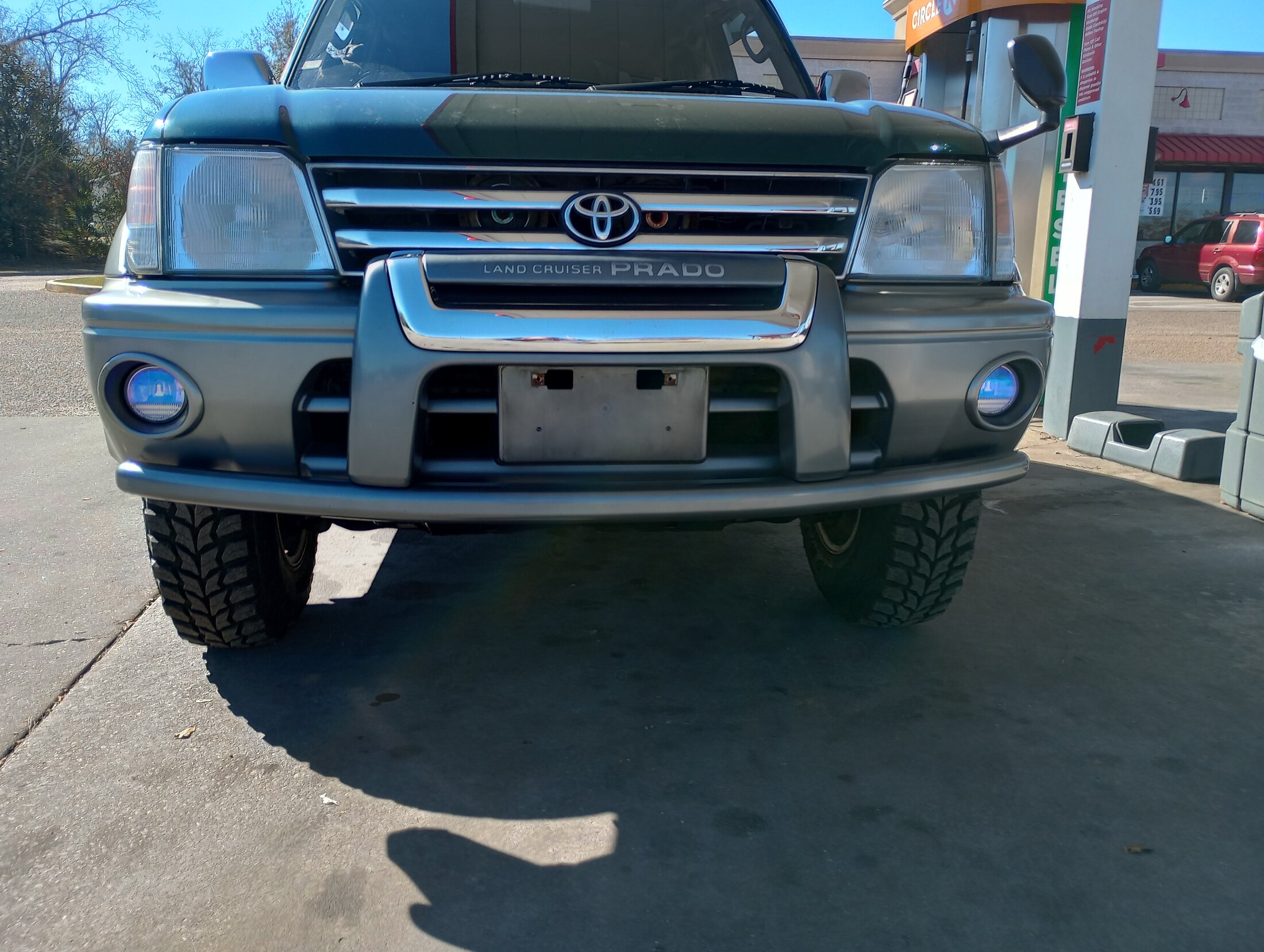

Do you have any pics of how your vehicle sits on the 195/85/16?
I would like to get something that will fit but is narrower and taller than stock.
Nothing too wild that I would need to also invest in a lift.
(I just like the look of taller/narrow)
Thanks, MVT
Just got my 235/85/16 's put on.
About an inch taller and an inch narrower than stock.
I too like the taller/narrower look.
(Also, stock ride height).
Woo, hoo. I now have a 1/2 inch lift.

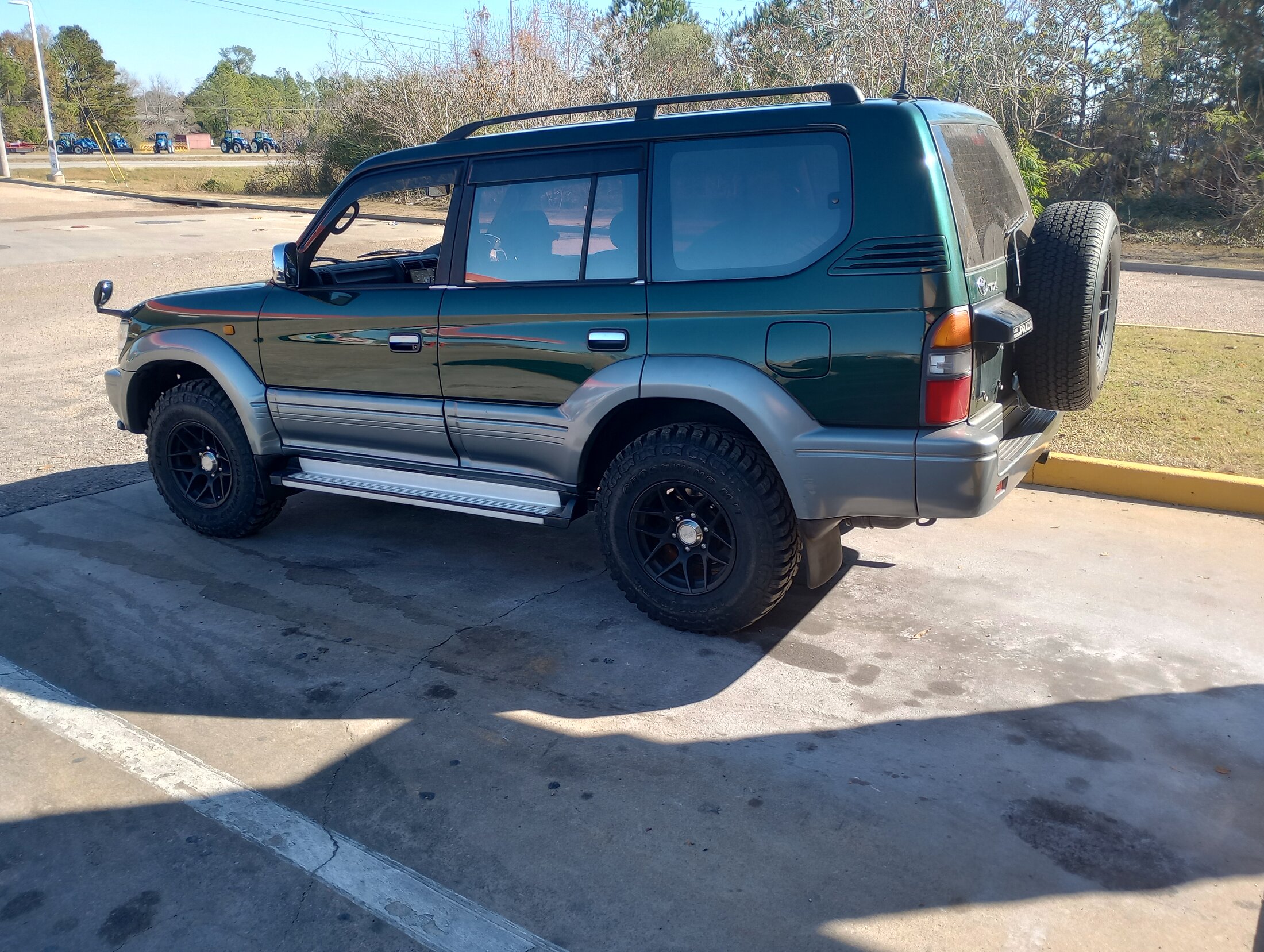

Don't have any real good pictures, but here are a couple:
Only 10 miles on them, but the noise is negligible.
Definitely not the roar you hear from half a mile away. At least so far.
Also, won't get to test their 'offroad-ability' for a couple weeks or so.
