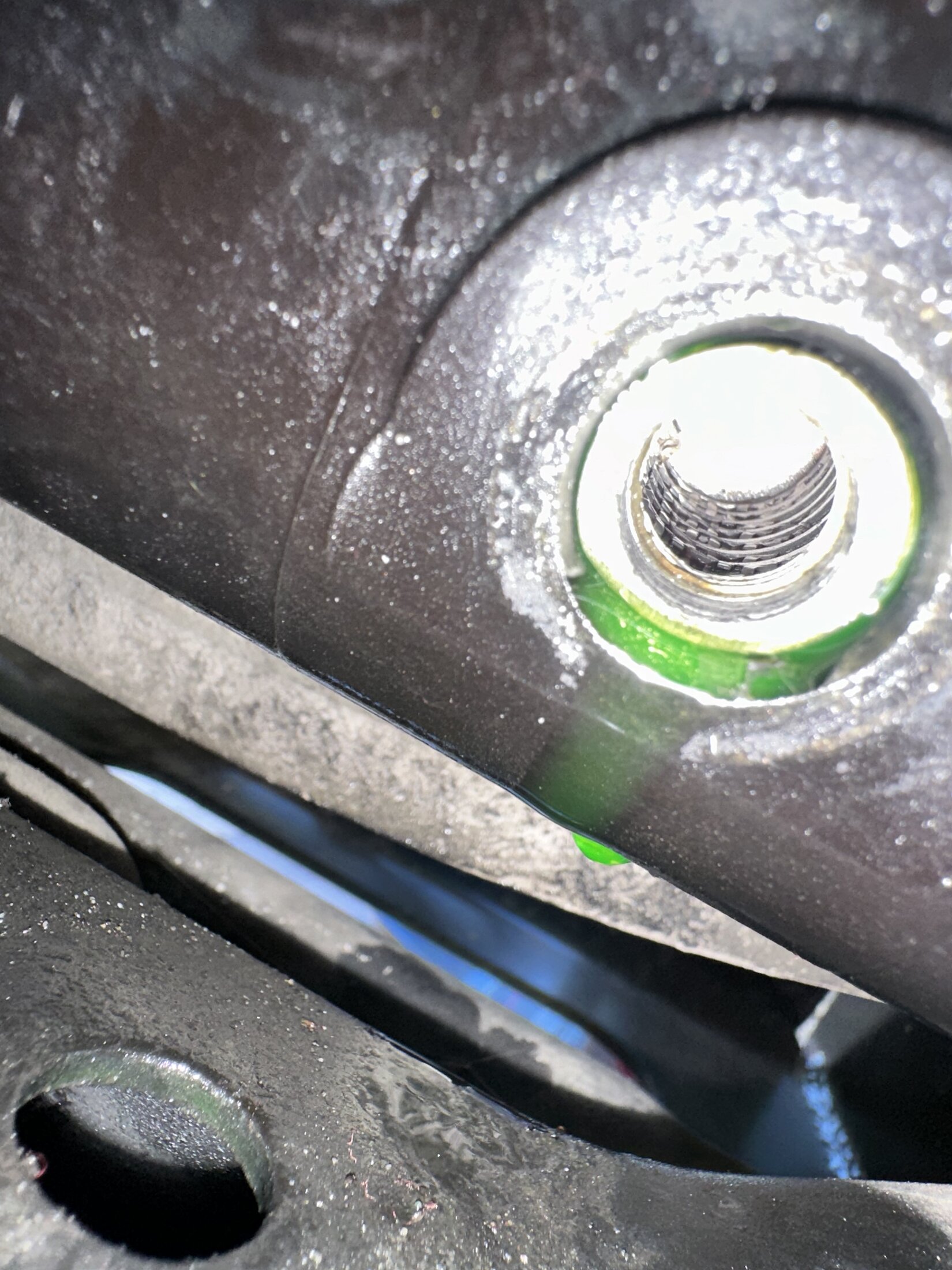

My brother moved my truck to the driveway which is on an incline. The front was facing down and noticed a leak coming from the radiator transmission coolant fitting. They’re are no lines connected to it (looks like previous owner bypassed it and just uses the cooler on the back of the grill). Anyway after realizing it was the source of my leak I tried to tighten it but it was just loose. Not threaded in, just being held by silicone. I tried to thread it back on but it just won’t grab and it’s continuing to drip coolant.
Looking at other pictures it looks like this isn’t even supposed to come off.
Is it time for a new radiator?
I’ve put 200 miles on the truck the past week and never over heated. Seems like it only started leaking ones I was on an incline.
If it is time for a new radiator, is autozone okay? I have a buddy who has an OEM one ready for me to use just need to order him a replacement (500$)
Someone locally is selling what looks like eBay full aluminum radiators for 165$.
Thank you in advance!
You should be able to buy a new OEM radiator for about $400.
OEM lasted 30 years,maybe the next one will again.
You know it will fit with no issues.
Based on your description of the failure, yes it needs to be replaced.
+1 on the OEM rad. Listen to the folks on this forum.
And while you are at it, change out your water pump & Thermostat, rad hoses, fan clutch, pulleys and belts if they are original.
