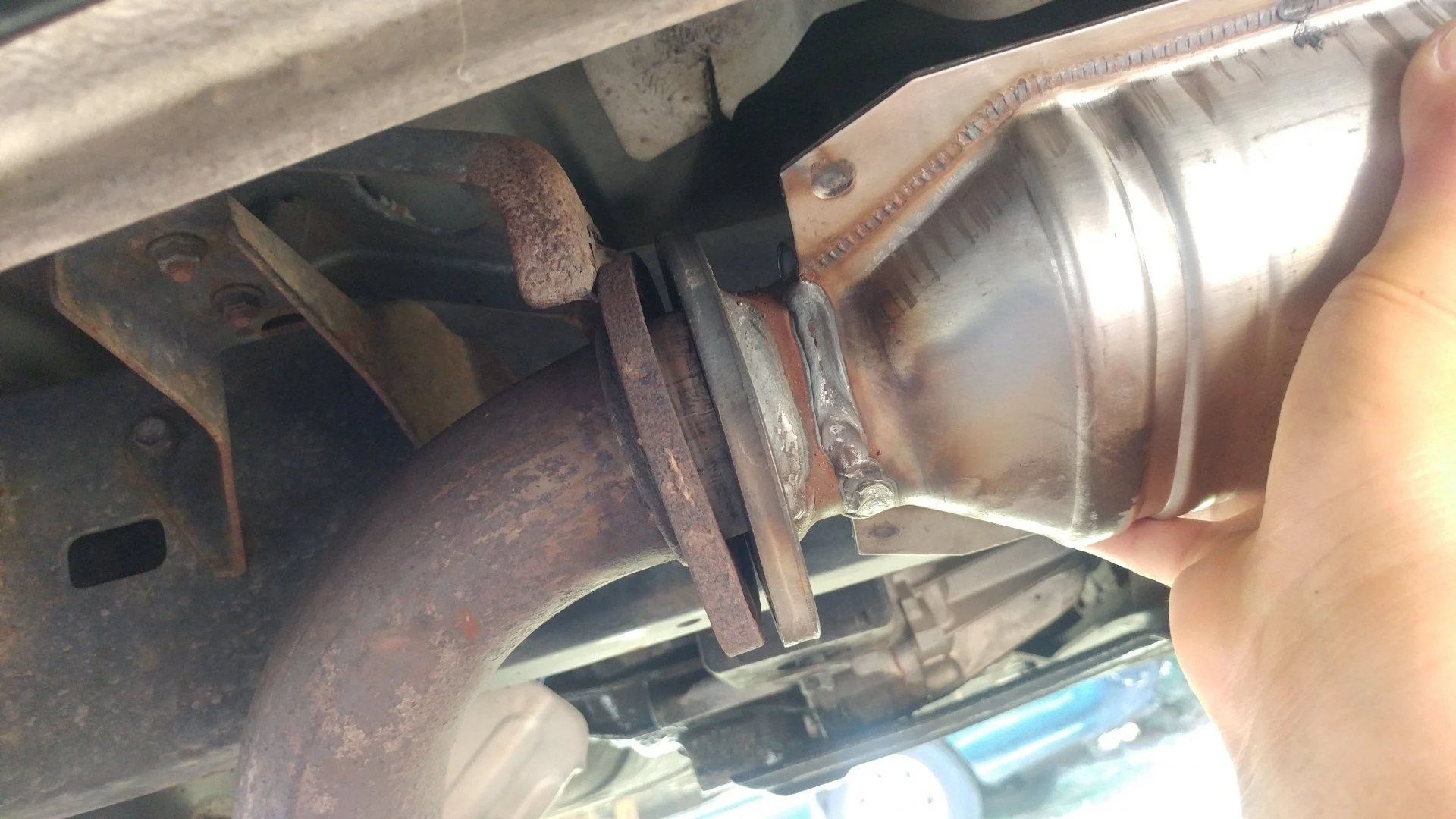

The one I got was the same way. Sorry but I didn't take photos of that stage of the project so I cant show you. My experience is "bolt on" anything exhaust usually needs some modification.
This is back yard red neck advice but I cut mine down with a reciprocating saw flush with the flange surface with a lip to hold the gasket. (not cut down to the gasket mating surface.) If you're not comfortable with that because its easy to mess up take it to someone that knows how to do this stuff. Though they're probably just going to cut it down too. Or weld a new flange on witch would be the best way because it would get everything lined up straight.
May have to just take an angle grinder to the lip of the OEM catback, I just really really hate making permanent modifications to the stock stuff.

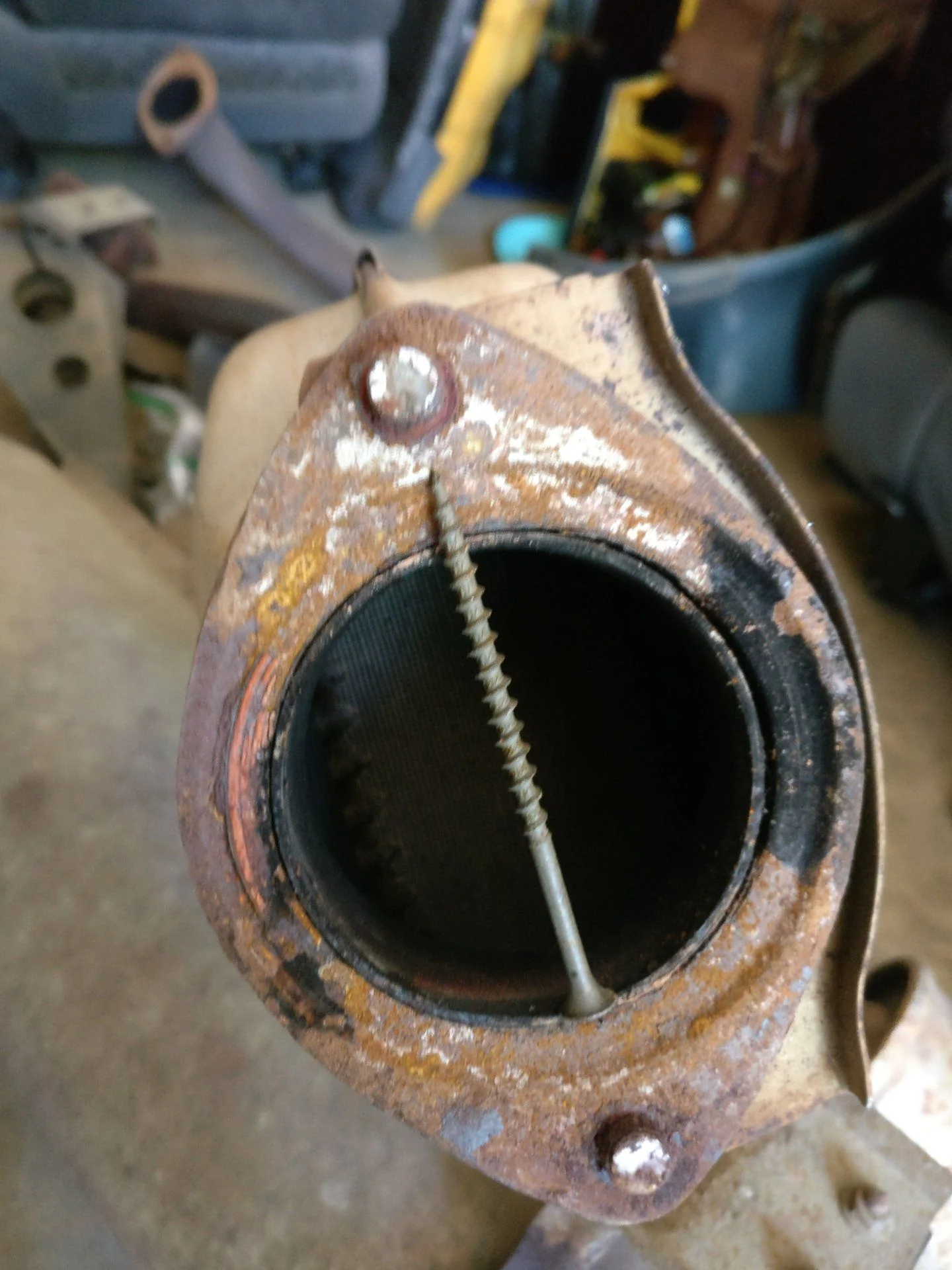

Just got the replacement cat, same issue, no go. Inner diameter is 2.4" at best.
I see someone once asked the same question in a OEM muffler for sale thread and the seller managed to snap a nice picture and took a nice measurement, inner diameter on the stock piping is 2.75".

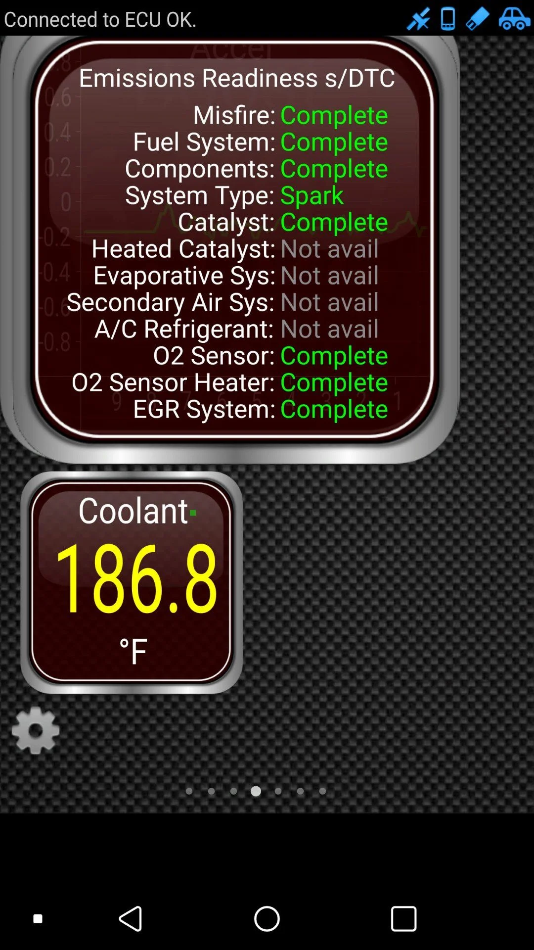

Code gone, catalytic converter readiness monitor set, downstream O2 sensor now reading a steady ~0.6-0.7V at cruise. Life is good.

No. The inside diameter of the magna flow cat is too small to accept the tailpipe lip. You would have to grind the lip off of the tailpipe side so they would fit flush. I'm going to just replace my rear cat from Toyota and see if that cures my inconsistent P0420 code.

I replaced just my rear convertor yesterday and that seems to have solved my P0420 code! My scan tool shows system ready for emission check. The o2 sensors are working as the should.
