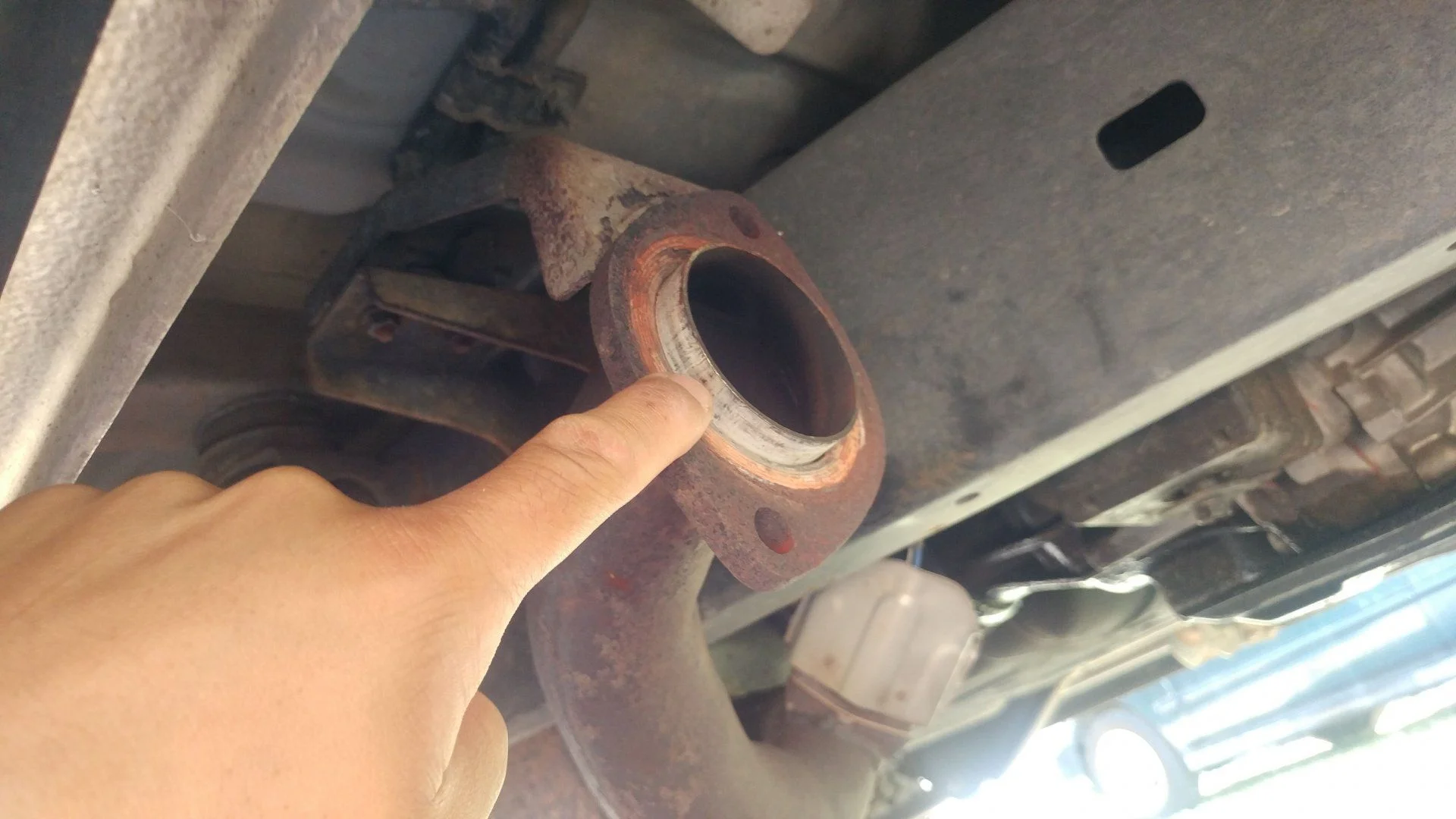

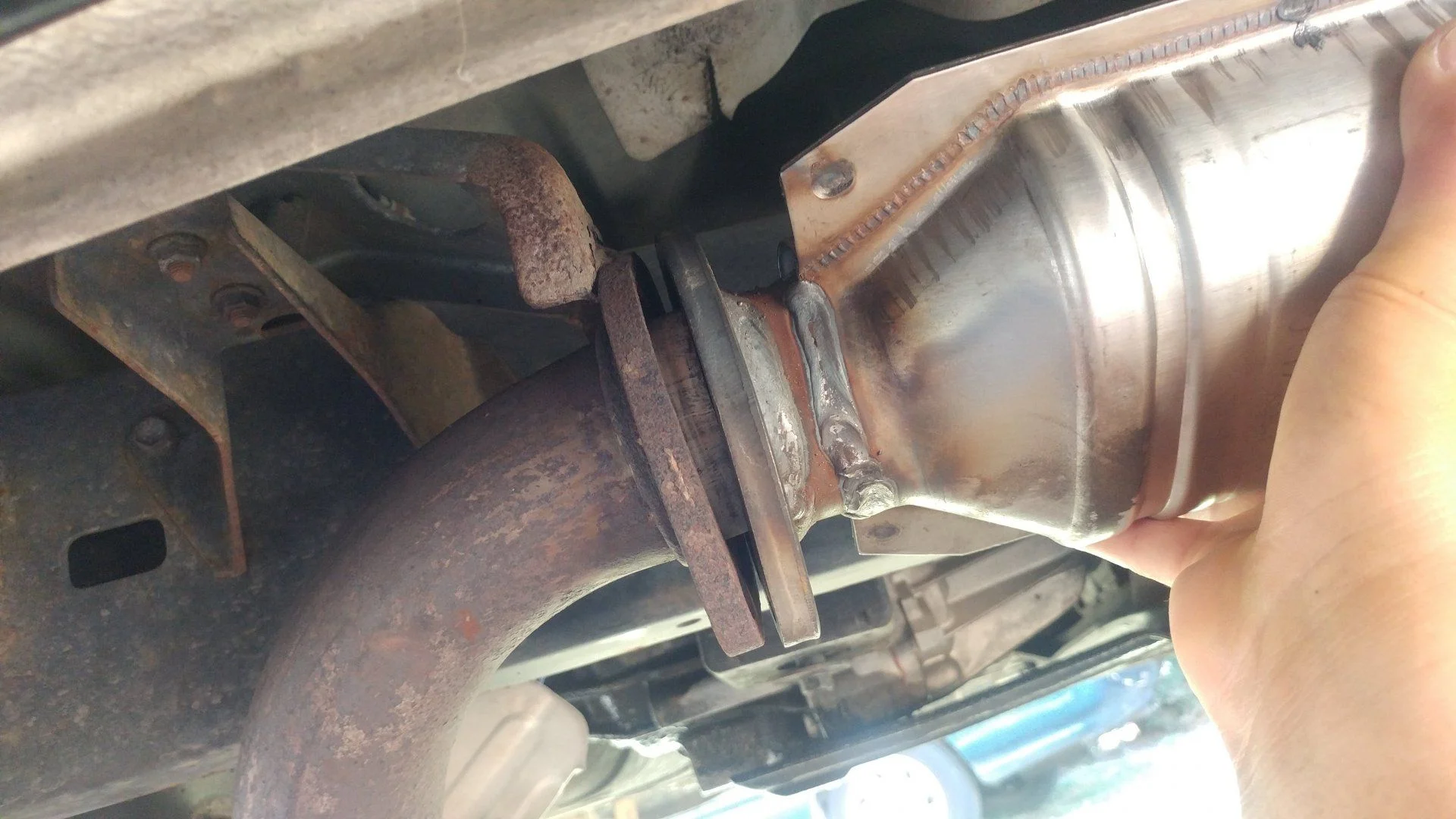

Apologies to revive an old thread but did you have issues with getting the 2nd cat to mate up to the rear exhaust pipe? There is a lip on the rear exhaust pipe and the pipe diameter is too large and the Magnaflow 2nd cat's pipe is too small and the exhaust won't fit into it...

From my other thread it looks like others just cut the lip off the stock piping and used 2 gaskets...
I don't understand why a "bolt on" product would need something like this, I'm leaning towards returning it and looking for another solution.

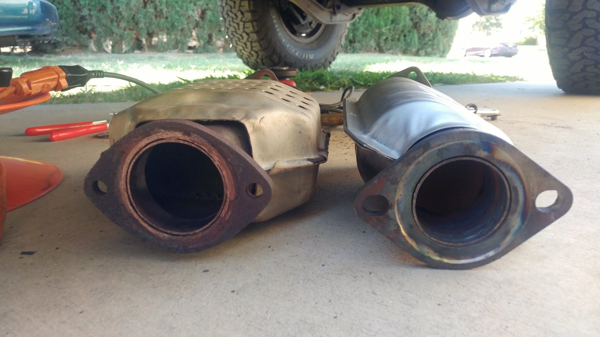

Definitely tried that, the piping is identical on both ends. The flanges are also identical on both ends, it leads me to believe this cat is not directional although one side is labeled "TOP" which when oriented that way makes the cat have more clearance with the ground.
The piping diameter is about 2.3" and needs to be about 2.5" to slide over the lip.
Just in case anyone cares... I called Magnaflow technical support and from their engineering the inner diameter of the piping *should* be 2.5". I measured and remeasured what I have in front of me and the inner diameter of the piping is at most 2.3".
I'm not sure if this one is just built wrong but I'm returning it and ordering another.
The one I got was the same way. Sorry but I didn't take photos of that stage of the project so I cant show you. My experience is "bolt on" anything exhaust usually needs some modification.
This is back yard red neck advice but I cut mine down with a reciprocating saw flush with the flange surface with a lip to hold the gasket. (not cut down to the gasket mating surface.) If you're not comfortable with that because its easy to mess up take it to someone that knows how to do this stuff. Though they're probably just going to cut it down too. Or weld a new flange on witch would be the best way because it would get everything lined up straight.
