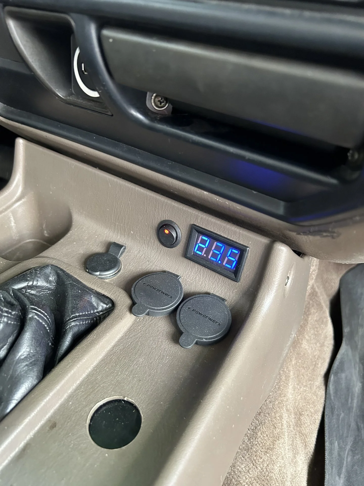

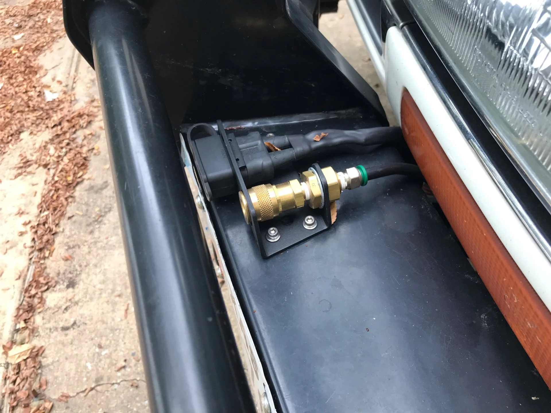

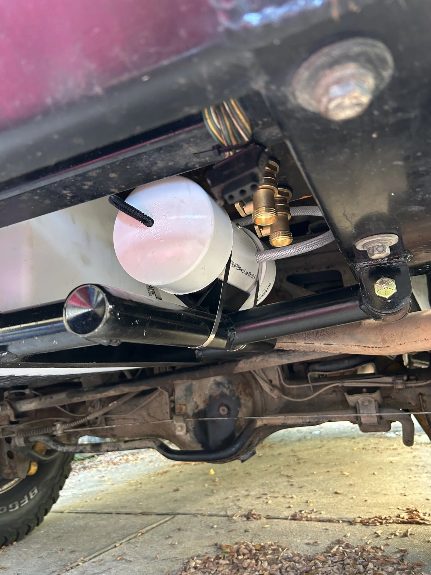

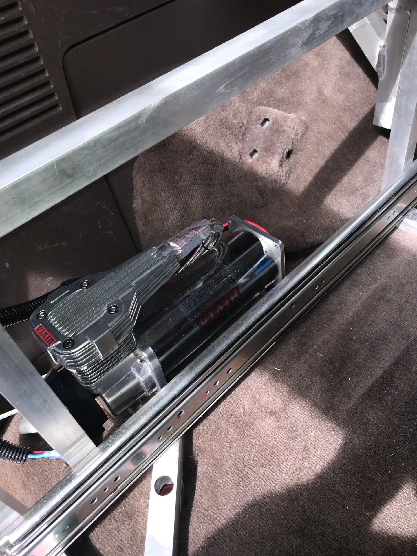

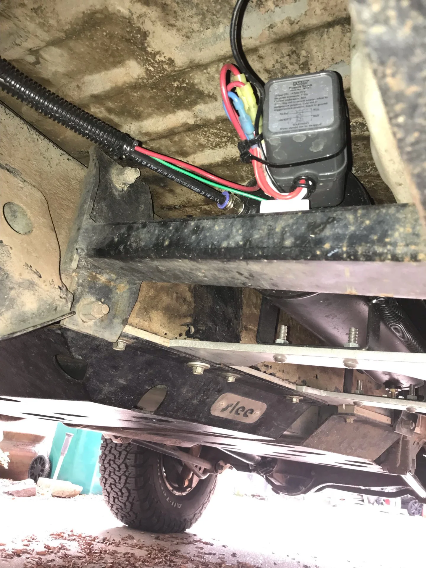

On board air system is finally wired in and plumbed. I went with a Viair 485C with their 2.5 gallon 200psi tank. The tank is mounted on the driver's side between the frame and the Metal Tech sliders. There's a Parker quick connect fitting on the front bumper. It's activated by a switch which I will mount on the front bezel next to the Victron gauge.

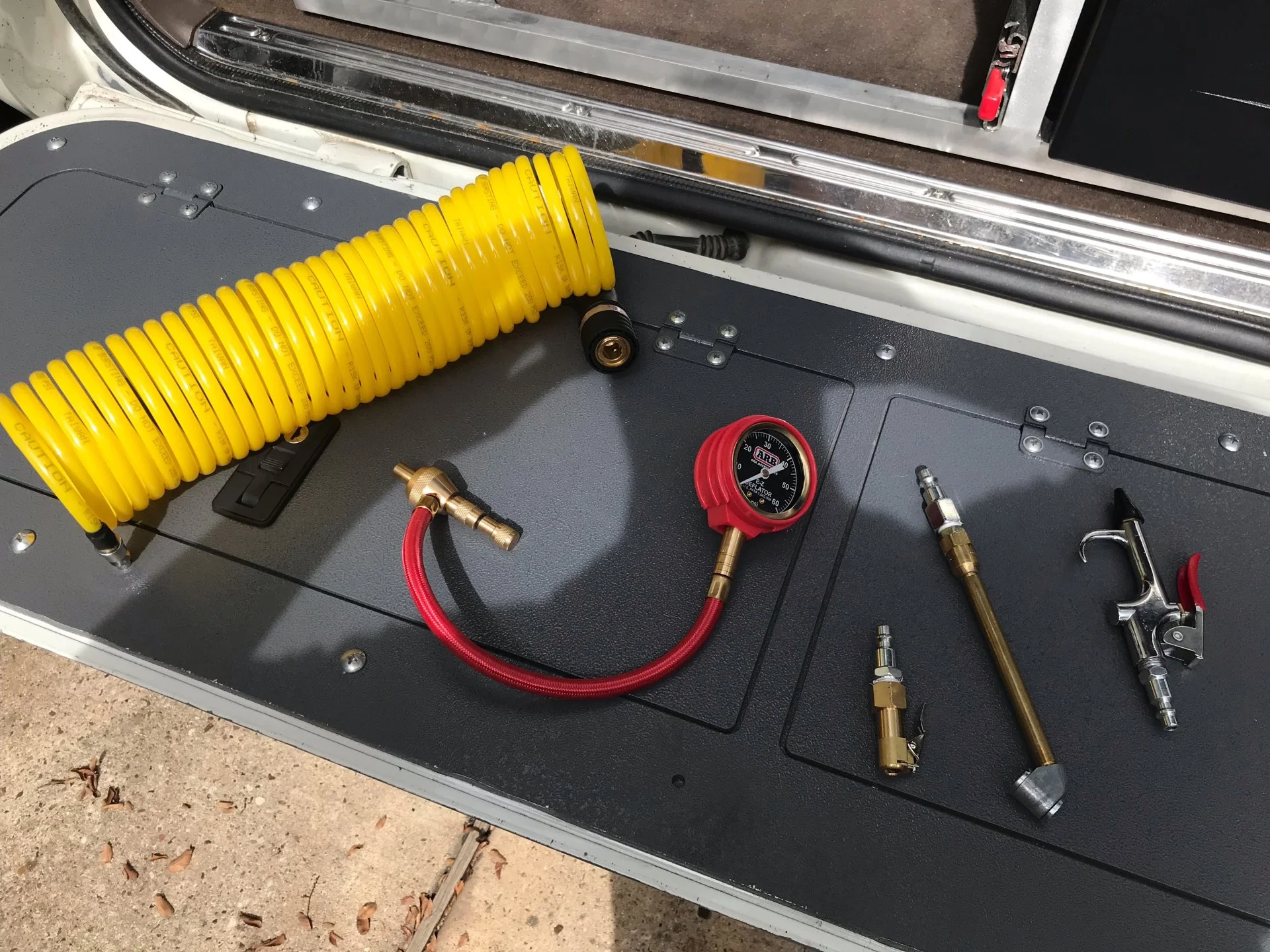

Here's my air tools setup. I used the ARB airdown tool last weekend and it did really well. Once I got my head around how it operates I was able to attach it and air each tire down pretty quickly.

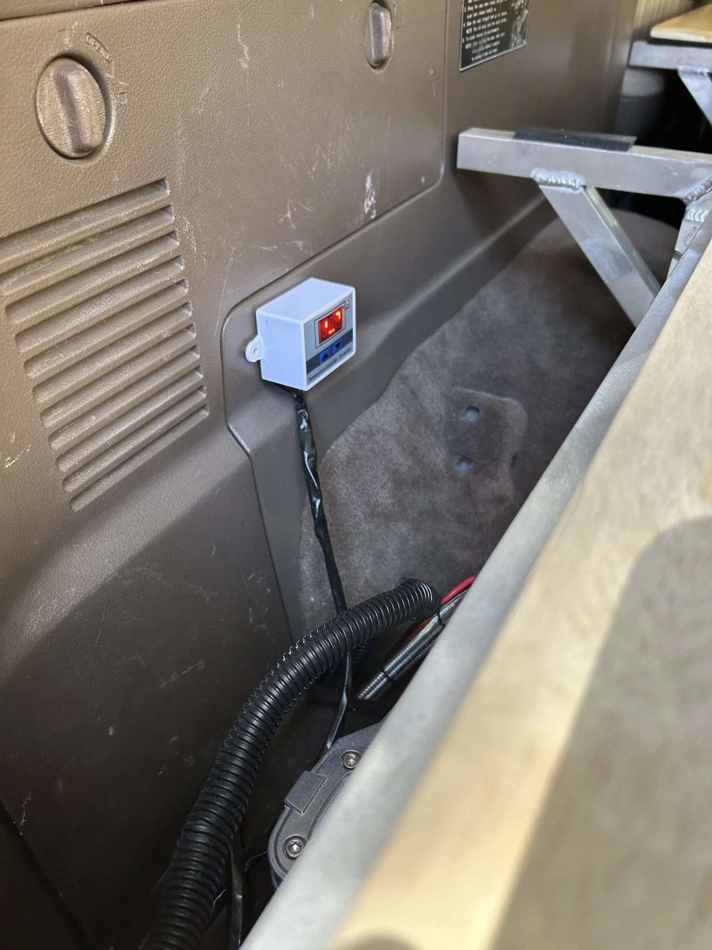

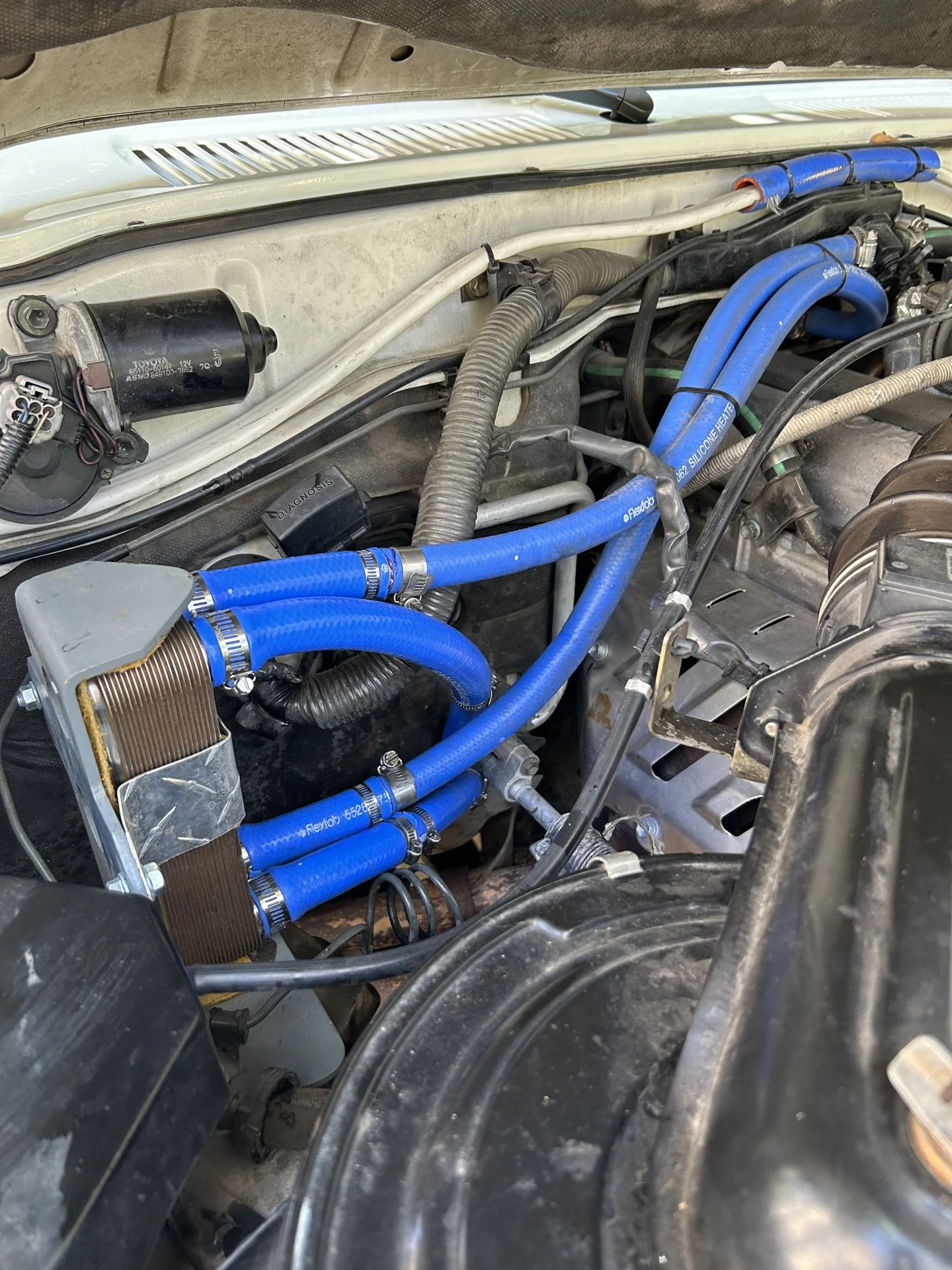

The most challenging part of the build has undoubtedly been the hot shower system. It was a tortured path to the end result with several wrong turns but I finished it today and it worked like a charm. Connected the heat exchanger to the rear heater coolant loop, turned on the heat and ran the circulating pump and like magic the temperature on both sensors started climbing. The thermostat is tucked away in back where I can’t monitor it easily so I put a separate sensor display up front on the console.

I know, I know. It’s soooo much fun the first time you turn it in and see the gauge go up. And then the smile when you are naked in the middle of the desert next to the car, mid day in the sun taking a hot shower and air dry. 😂.
Are you storing the hot water in the PVC tank? If so how big is it?

Thanks Ofer. I literally couldn’t have done it without you. I had a custom polyethylene tank rotomoulded to my dimensions. It holds 15 gallons. It has a lower melting point but I don’t ever plan to get the water over 115-120 degrees F.
