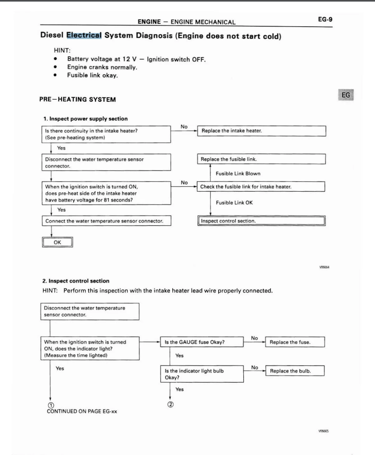

Thanks. I definitely will next time. I am looking for an electrical diagram now to see what I’m looking for to test.
maybe this will help you
1HD-FT FSM
