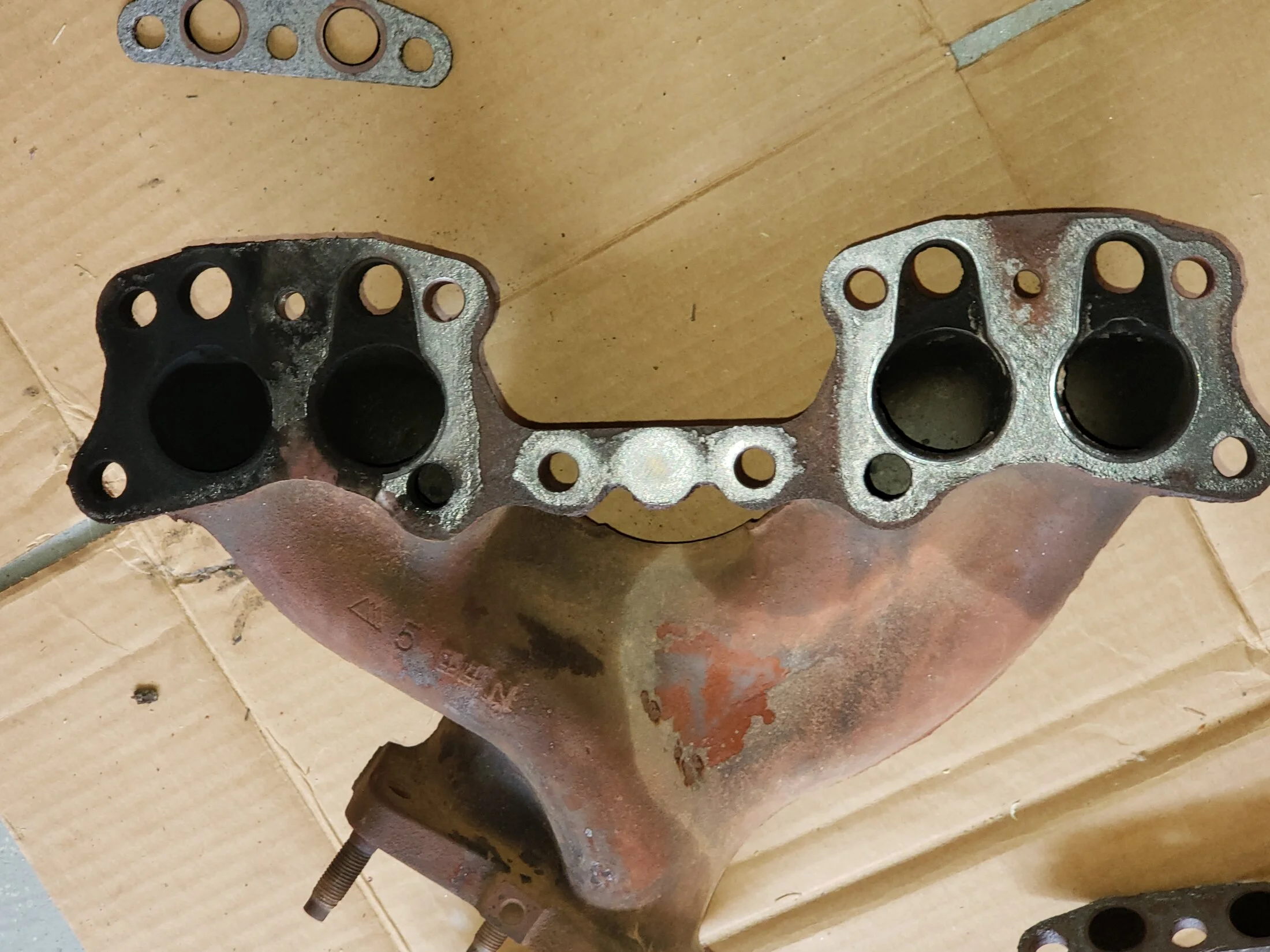

I have a stock 1994 DLX pick-up, 22RE, 5 speed manual, w/ 4x4. I have an exhaust manifold gasket leak near the firewall. On my FJ55 1F Remflex gaskets were fantastic.
The only reason I have not pulled the trigger on the Remflex is they do not appear to have a gasket with a provision for the integrated heat shield for the sparkplug wires, really like the idea given their proximity to the manifold. Does anyone have recent experience to share on OEM vs. aftermarket? I'm not a Doorman fan so not really considering them as a contender here. Thanks mud!
Pics, because we all like them
I've installed quite a few fel pro exhaust manifold gaskets on my various Toyota pickups over the years and have never had a leak. They also have the oe style heat shield built in. Part number MS92968
Hey @Homey15

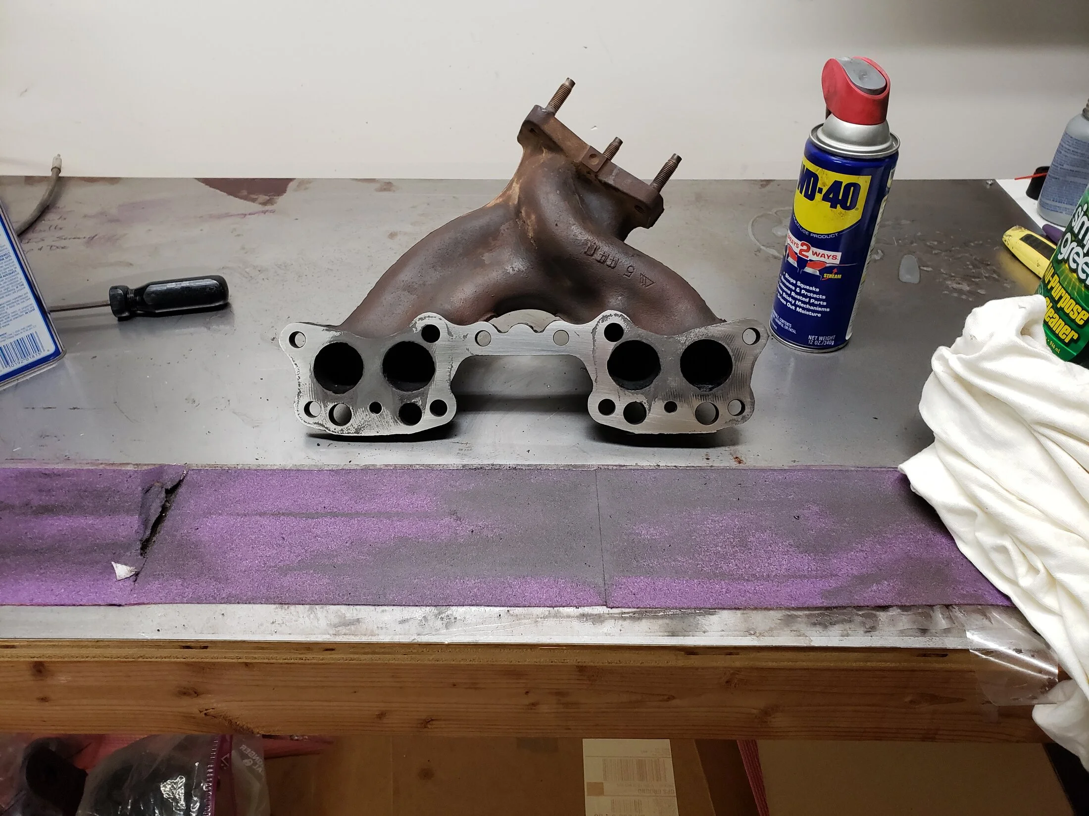

Got the job done this weekend. Felpro burned in along with the antiseize. Some pics below, thanks again for the input.
