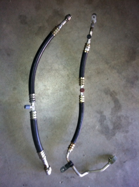

houston, we have a/c hoses...
ended up buying a set of vortec hoses just to get the ends for the compressor connection. I then took those along with the old toyota hoses and they married them up.
Maxair in Centennial did the work. They were super fast and Bill was quick to correct a small error in the way the fittings were positioned. great guys to work with. Now I just need to wire the compressor up, change out the receiver/drier, replace some Orings and then take it down to an a/c shop to have the system evacuated and then charged up. I assume that the system should take about the same amount of R134a as before since the only real change is the compressor. I may spring for a reman compressor since it's easy to replace now.

A/C update...
I tried to install the discharge hose and couldn't get it to fit. Ended up taking it back to Maxair and had Bill shorten it a few inches. Now it fits. Both (discharge and suction) hoses are now installed. I have a new receiver/dryer to go in and my vacuum pump and scale should arrive today.
Somehow over the course of an already fully booked weekend, I plan on evacuating the system, testing for leaks, and then charging it up. I still have to run the A/C clutch wire from the Toyota A/C amplifier to the GM compressor (just a matter of matching the wires up with a weatherpak connector) and also run a signal wire to the DC Controller to ramp the fans up when the A/C is on, and to the Vortec PCM so that it compensates the idle speed with the compressor on.
It's been a while for me since I have messed around with automotive A/C systems. I figure what the heck, I did the engine swap... how hard can the A/C really be?
