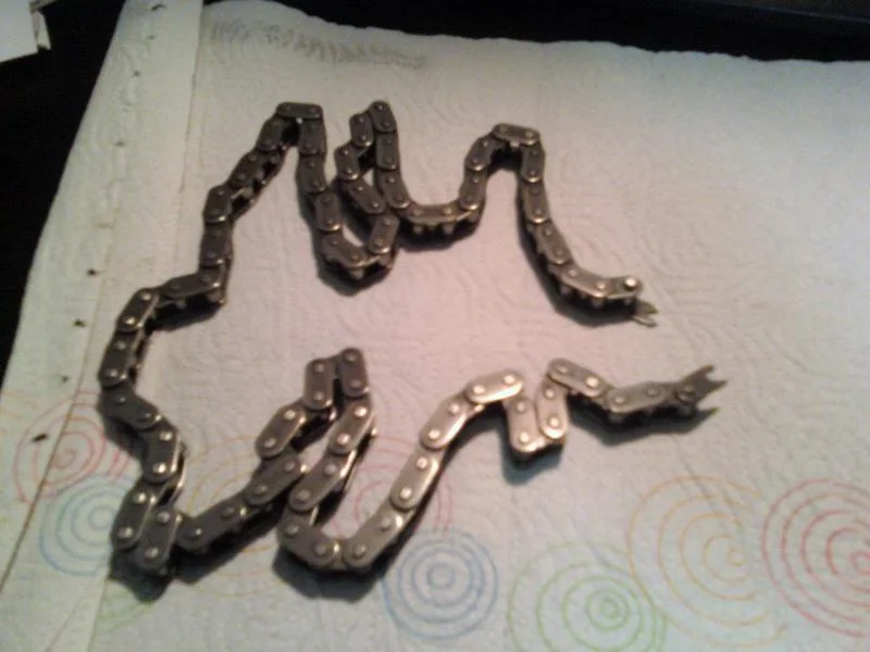

damn i have never seen a chain snap.
post up some pics!
I bet it looks like this:
Poor engine was made to run all the way up to, and past it dying... Poor thing... Improper PM and krappy parts have slandered the reputation and killed many a good truck...

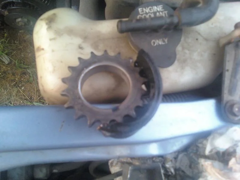

No no no... it looks like this:

However, mine broke do to my own mistake.... water pump bolt stuck too far through the timing cover, jammed the chain tensioner. Chain flopping fatigued and broke the metal timing chain guide which then fell and went between the chain and crank gear... and...... POP!

oh and here is a question, does the engine crank unusually fast when this happens? i had a car that the timing belt broke, and just shut off, when i tried to start it it sounded like i had a high compression starter on it.
well i have to say that is a first for me, even though i have used inferior parts, damn that sucks!
The thing about using cheap parts is you know when you put them in, and how. When you buy a 2nd, 3rd 9th owner, you never know that...
Valves stopped open, no compression. Like when you prime the oil pump on a 22R. Remove the plugs and turn it over until the light goes out...
I'm guessing that's the sound you're referring to.
