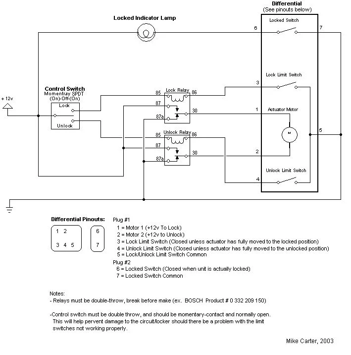

currently working on getting my rear e-lockers working.....doing the tear down to get it cleaned and greased, but will need an alternative way to wire it. couldnt find ANY one here who has the e-locker actuator relay thing. Will a two relay (5 pin types) setup work?
will this work?

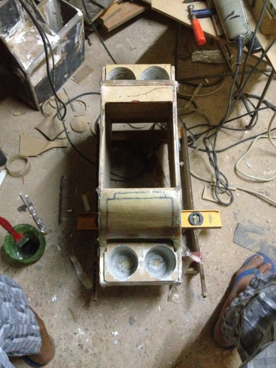

4- FINALLY working on my center console: 4 cup holders, large center compartment, secret compartment, rear seating charging outlet (DC for now, will install AC once i get my hands on a decent invertor)and some fancy LED

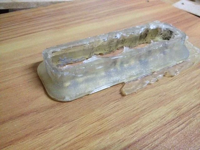

5- learning to fibreglass stuff.... plenty of screw ups in the moulding process...no gelcoat or release wax available that i know off here, used oil, paint, vaseline....maybe i should try baby lotion or something :)

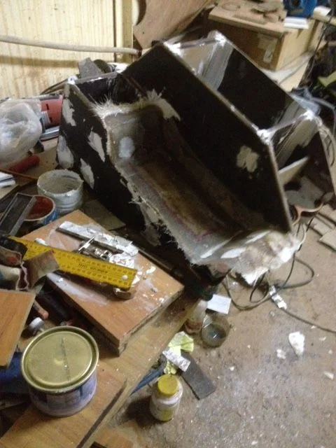

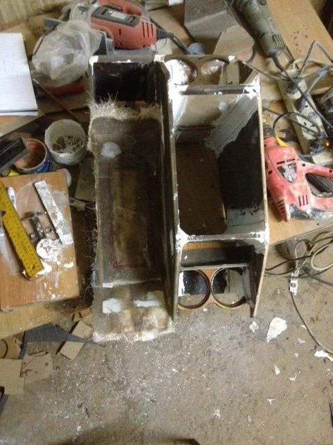

the images are both of the center console , which i trashed btw to build a better looking one. FOund the first trial looked more like granny furniture.... new one is much better. currently working on the molds for the cup holders, instead of the cut and rounded wood frames i had in the first one. will upload images tomorrow. waiting for the cup holders to dry so they dont warp, and then everything will come together.
