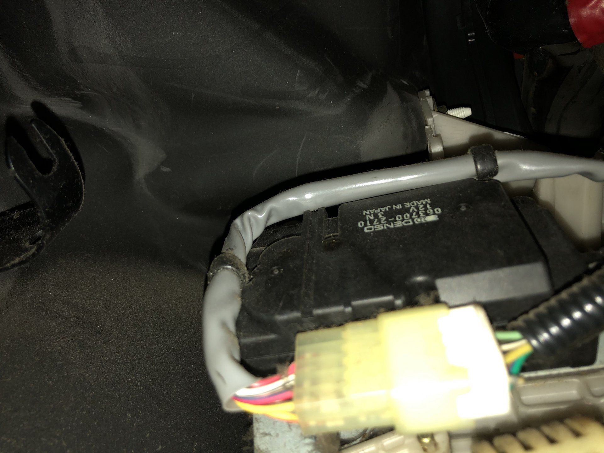

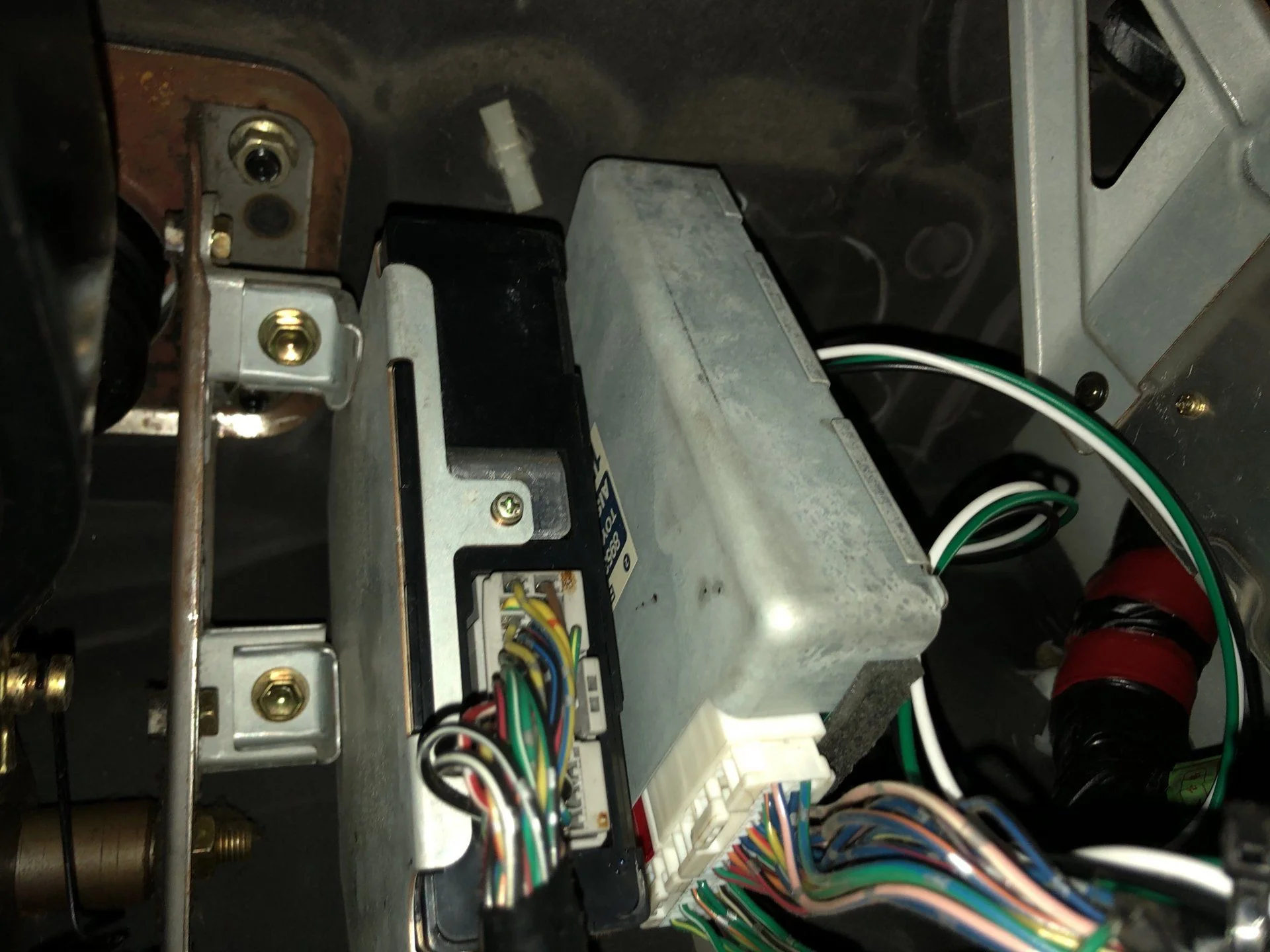

Here's what's under the driver side dash. What I think I'm looking at is the ABS ECU,Relay box and Cruise control ECU. Does any of that look like an anti theft device ?
Here's what's under the driver side dash. What I think I'm looking at is the ABS ECU,Relay box and Cruise control ECU. Does any of that look like an anti theft device ?View attachment 2411226View attachment 2411228View attachment 2411229

I don;t see anything in your pics specifically denoting anything alarm related, but that's not to say there's not a port added alarm in that harness. It is done very well and is very factory looking.
I've looked under the seats, nothing there and I don't have anything except blanks in those areas. Definitely nothing with a light. I'll keep poking around but I don't think this truck has any anti theft device. I don't see how it would be activated.
