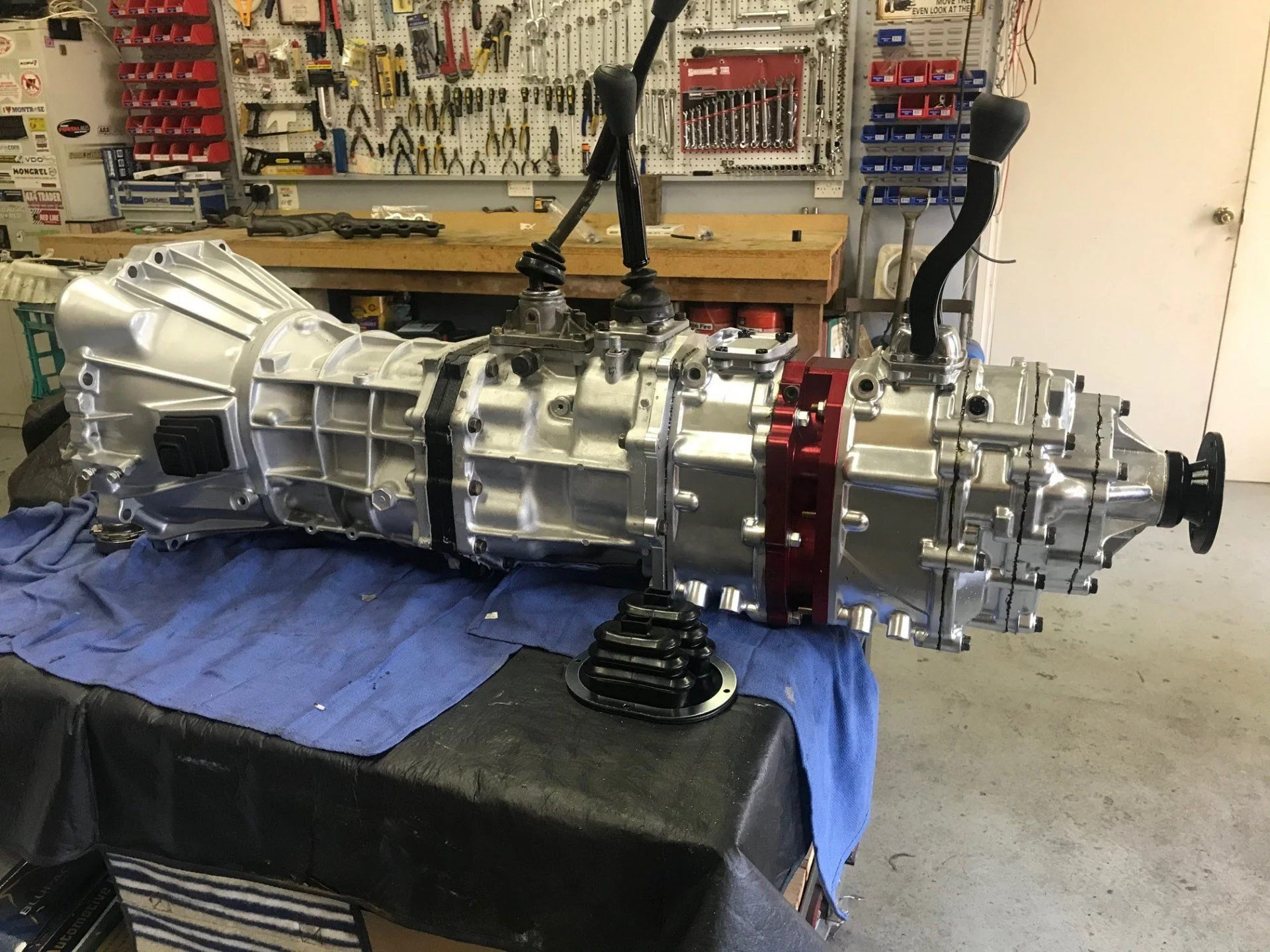

Guys, any tips for removing those upper bellhousing bolts when the old 'box is still in the truck ?
I haven't lowered the crossmember yet and have used 2 really long extension bars and 2 x 1/2' drive universal joints to get a dog leg joint over the gearbox and up to the top 3 bellhousing bolts you can see in the pic above the starter motor nose resess, but this mehod I'm sure won't work too great when having to do them up....
No room to swing a spanner behind the head from above so sctatching my head. Putting the new gearbox together - R151 to twin 23 spline gear drives
was easier on the bench than it seems just getting the bolts out so I can drop the old G52 5 speed !

Drop the crossmember so you can lower the case a bit. Use as few extensions possible. Big kid air gun with impact swivel, preferably a swivel socket.
This is how I’ve always done it, bonus if your engine mounts are already stuffed you can get quite a bit of room.

Factory Surf 2LT-E bellhousing, They are around but as manual a bit harder to find. Bolts stright up gear levers come out mm correct.
