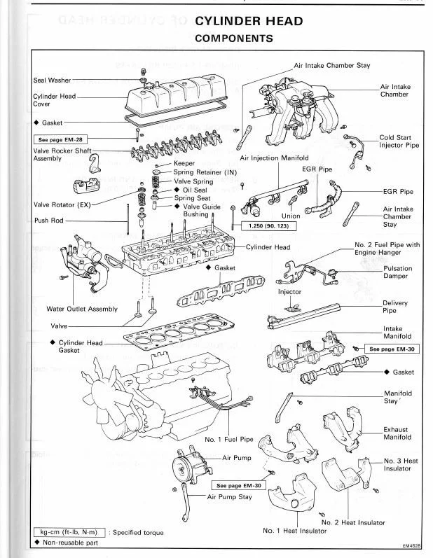

So I was lucky enough to be given a 1991 landcruiser from a friend. The bad news is that it has a head gasket issue and has been sitting for 2 years. I was able to wrench on it and get it fired up and the motor runs like a champ. The down side is the large amount of sweet smelling white smoke out of the tailpipe. Head gasket....... Same thing happened with my 72 landcruiser. I started tearing into the motor but was unable to remove the air intake to pull the head. I removed all the hoses and cables to the intake then unbolted the 9 bolts (3 per intake runner) as well as the the braces that attach to the EFI intake at the front and back of the motor. Could not even make the intake separate at all even slightly. I have to be missing a bolt somewhere but cannot for the life of me find it. I hope that someone here can help me locate the bolts i am missing so i can pull the intake and subsequently the head for assessment.

Which leads to the question are there any tricks to getting the air intake of after removing the 9 intake bolts and air intake stays?
Can anyone help me out with the tricks to remove the air intake chamber. I have tried looking at the 3fe repair manual and it is no help.

I have noticed that it seems to have been removed before as there is blue gasket material between the intake and intake manifold. Any help identifying where all the bolts/attachment points are would be a great help so I can pull the head.
Thanks
Dude I think you’re gonna have to smack it with a dead blow or something, mine came off no problem removing the two braces and the 3 x 3 bolts.
I actually did try a dead blow to try and break it loose after removing the bolts. It didn't budge. I was worried about cracking the intake. Even tried pulling on the intake but the entire car was shaking as i was pulling which is what makes me think there was another bolt besides the ones to the stays and 9 bolts on the intake and manifold union.

can you take a picture and show me what you have pulled off your intake? I have had my intake off a few times for injectors and believe it or not for two head gasket failures. my first one was due to an overheat and the second one still has me scratching my head. but none the less I highly suggest if you haven't bought the other engine yet is too take the time and figure out why you cant get it off. there is something you are missing. are you trying to remove the lower and upper plenum at the same time or just the upper from the lower? there are a few different things holding that sweet ride on. and being aluminum and being held together with a paper gasket that upper plenum should separate relatively easy from the lower. after the upper is off after that its smooth sailing. the fsm says you have to pull the fuel rail from the injectors and then from the lower plenum but its not needed. although I highly suggest pulling the injectors and taking them to a shop to get cleaned and tested. if you have any questions let me know. I got the top end tear down and rebuild down to roughly 6 hours now. I'm unfortunately pretty good at it now hahaha

Front and back brace plus the cold start injector fuel line. Be sure to remove the intake hose (derrrr) too.
I was just trying to remove the upper on it own. I removed all 9 bolts that hold it to the intake manifold and the front and rear intake stays that attach to the air intake and it would not budge. I agree that i am either missing something or the previous owner decided to use marine grade sealant to bond the air intake to the manifold (wouldnt put it past him as he was a not a mechanic and have noticed alot of rigged things on the cruiser. Still cant beat free though. I have actually already purchased the motor and picked it up yesterday. $900 for a running complete drop in motor with all accessories plus the front and rear drive shafts(missing one and the other for a spare) with only 114K i feel is a pretty good deal. Started removing the front of the cruiser to pull the motor this past weekend. Didnt make it to far as the girlfriend wanted to spend some time together with the weather being nice.
