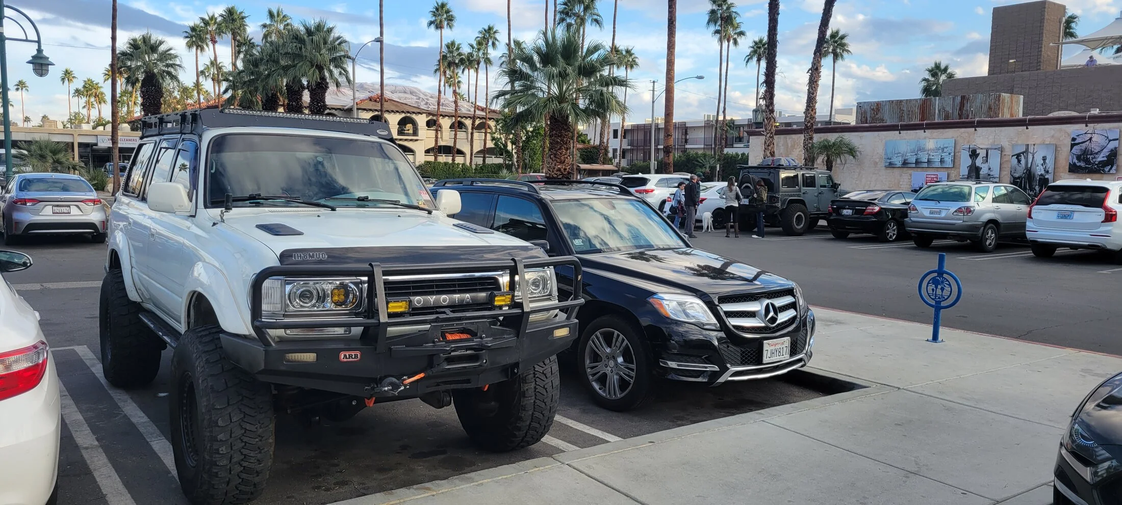

Best headlight upgrade is just go bite the bullet and do a LED projector retrofit. Not cheap by any stretch of imagination, but it is one of the best mods i have done.. Don't bother doing the LED or HID upgrade unless you have projectors. I have also done the Slee headlight harness upgrade with HIR bulb and that was pretty good for Stock configurations.
Best headlight upgrade is just go bite the bullet and do a LED projector retrofit. Not cheap by any stretch of imagination, but it is one of the best mods i have done.. Don't bother doing the LED or HID upgrade unless you have projectors. I have also done the Slee headlight harness upgrade with HIR bulb and that was pretty good for Stock configurations.View attachment 3870803
