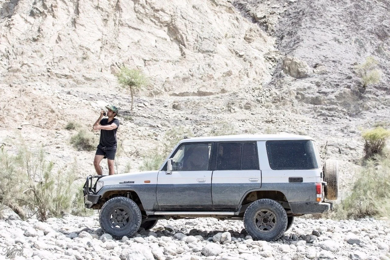

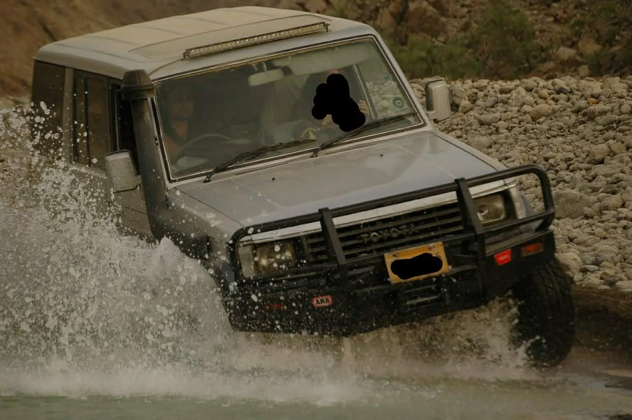

Here is my 1990 Prado (LJ78). Have had her for about 8 years now. It's got an arb bull bar I scavanged from a junk yard that came with 9.5 warn winch, mounted the Led bar on it just this year, been using seal beam.lights and a roof bar before mostly. The left seal beam keeps fusing so I am thinking of going back to those switchable bulb lights or finding the cause of the repeated fuse.
Under the hood is an engine swap to 1kzte. It's a bit of an abomination as the manual gear, ecu, wiring are all still the original LJ78. The differentials I swapped to kzj78 variant which are slightly
Higher gear ratio. Did the swap to get the rear difflock on the kzj variant. It also has a kzj dashboard to surprise, get the difflock light option. I know, that was a lot to spend on a difflock light.
LJ78 comes with a horrible 2.4 liter turbo diesel that I hated and gave me way too many problems. Knock on wood the 1kz engine swap still going strong even though I sense she has a fuel delivery system issue just slightly as it doesn't accelerate as fast as before. Have replaced the diesel tank as well cause of trash in it.
Got a 2inch lift I think with 31 inch Yokohama at tires that are over 6 years old now and need a change soon. Kyb gas shocks keep it nice and smoothish. Changed the colour to gold a while back.
She is my daily driver but is used a few times a month for hardcore off-road with river crossings, steep hill climbs, rock crawling and a lot of other dumb things that we do with her while camping.

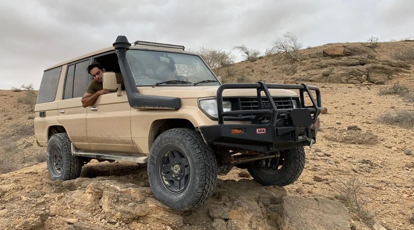

Thanks, I'm from Karachi in the south, it's a coastal city. I keep hearing about how rare the 70s are in the US. My arb bullbar has a slight bend on the right side with a broken right bumper indicator light. I think it must have been an animal strike from where ever in the world it's from. I like to imagine it was a kangaroo in Australia as it had to be something big and heavy to bend it. The arb bar is actually designed for the heavy duty 70 series I believe with the rear leaf spring version but we used self made adopter plate to install it.
