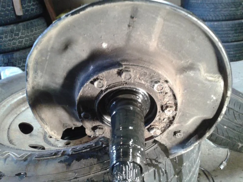

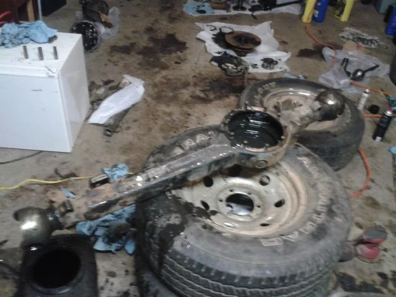

Got the axle completely torn down. And most of the way sanded. Getting ready to paint, and sending the 3rd member from the 1985 front and one from an 86 rear to get 5.29 ring and pinions installed. While I'm waiting for them to get done and the sas kit to get here ill paint up the axle.
