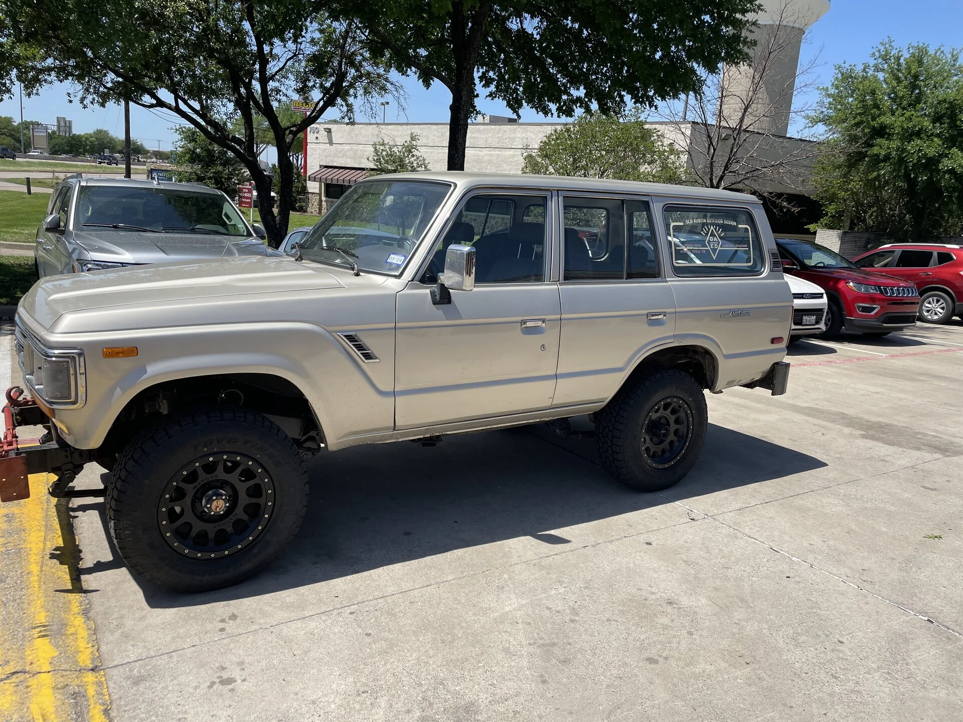

Well, you guys are on point. I pulled the cable and found it to be a little sticky. Not so much that it wouldn't move but enough to effect its operation. I removed the throttle end from its support bracket/throttle body, removed the rubber stopper, and sprayed some brake cleaner down the cable while working it repeatedly. Once it freed up enough (minor rust residue was observed), I repeated the procedure with some trans fluid in a spray can I have. I continue until I felt like there was enough to coat the entire length of the cable. I reinstalled per the FSM. I took it for a drive and low and behold it shifts now! I did end up adjusting the TV cable a bit after a drive as I found the shifts were a little too early. I added a half turn on the adjusting nut and drove again. I can say that it shifts perfectly cold as well as warm and performs as expected. A sincere thank you for everyone's advice. You saved me a lot of trouble. Photos for the effort!
