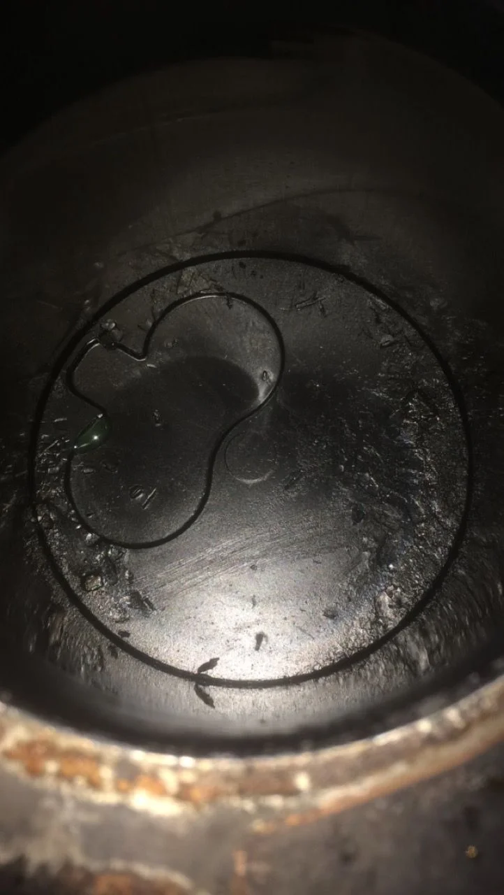

I have a 1987 Hj75 2H turbo, took it out for a fourby the other day went as it alway did, got back to the car and it had a bad knock all of a sudden. Pulled it down yesterday and it’s grabbed a ring on cyl 3.
