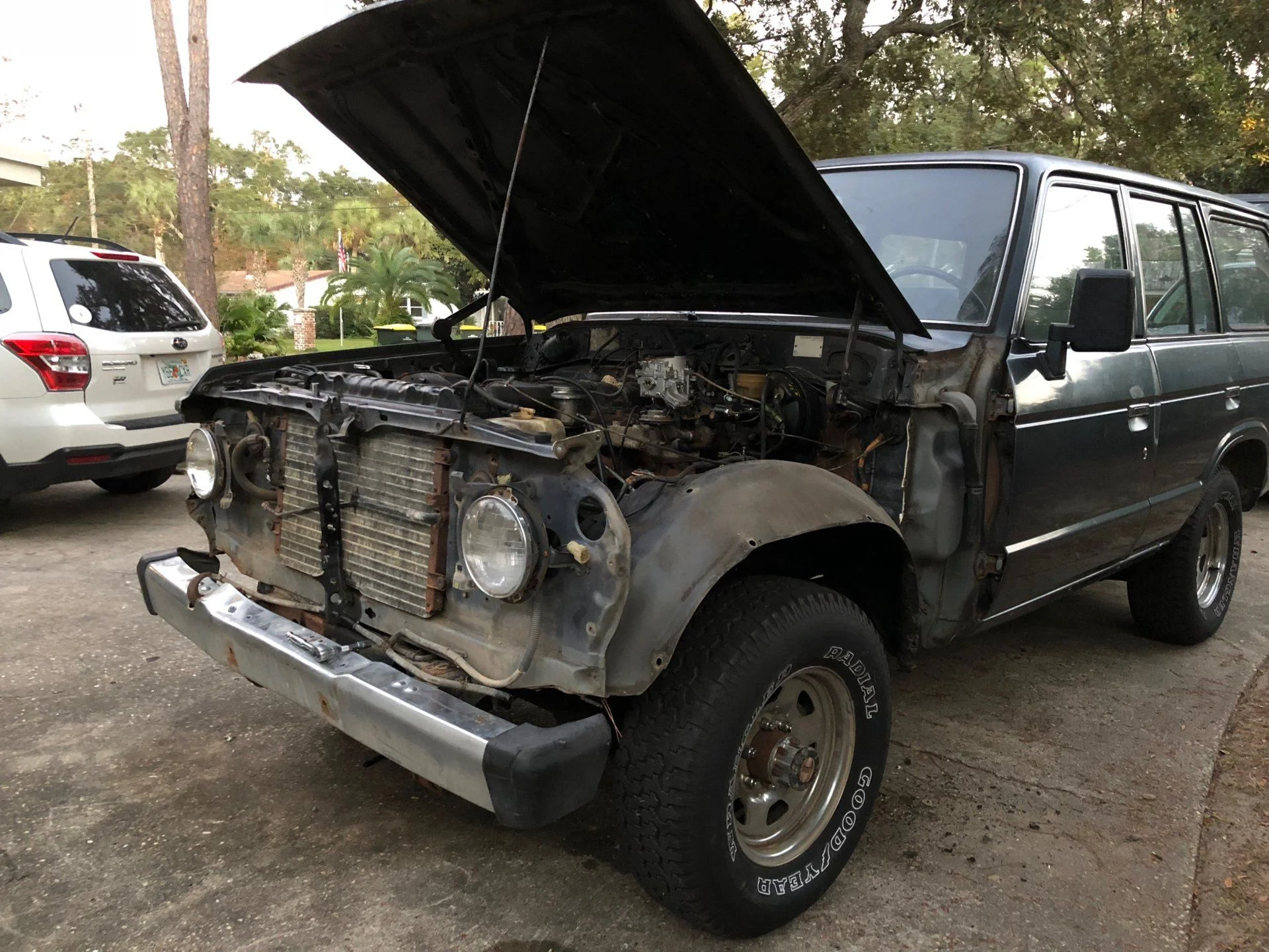

Had to take off the DS fender today, so I get get to replacing the DS door hinges.
Didn't realize you had to take apart half the front end for that. 50 bolts later.

Are you going to paint or spray anything to rust proof it inside there while you have that fender off? Nice work on the videos!
I was thinking about hitting it with some Fluid Film or POR 15.
I did it to the front of the frame (Fluid Film) when I did some cleaning at it holds up pretty well.
I'm taking her to a body shop soon to get the rust taken care of, so I'll prob ask them what they think it the best approach also.
Good call. I think the POR 15 is a good choice, then you can fluid film over that. I'm a bit OCD haha! They say POR 15 is UV sensitive so not sure if you need to paint over it too or if it's okay since it's hidden. Your body shop should know.
Post up what you hear; I'm curious what they say.
Will do. The rust is mostly surface, so I could prob just wire wheel it and hit it with some paint, but with the metal these things have I'd rather over do it.
