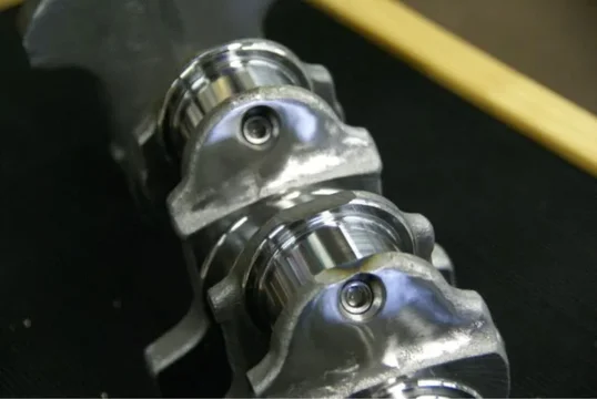

What about a missing oil galley plug, IIRC there are oil plugs internal to the engine, if one of these are loose or missing that would account for low oil pressure. Someone correct me if I'm wrong but I think there are some on the lower end on or near the crank saddle, perhaps the wrong term, I trying to describe what the crank sits in....perhaps a galley plug, of there are any, on the head. If the engine was rebuilt about three years ago what extent was taken to clean and rebuild the engine, some people will remove the internal plugs, some will not.
Good luck
These are the oil plugs I was referring to, these if loose would cause major oil pressure issues.
x2
