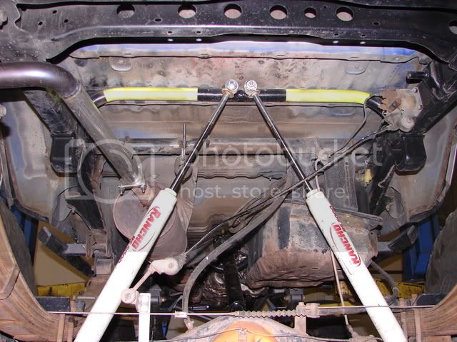

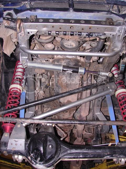

Before we get into the details if what is to come, we should start out with what "Boobie" was equipped with before the work started. She started out with our ORS front coilover 3-link suspension, slightly modified with 2.5" body Racerunner Shocks on a stock front axle. Out back there are Alcan springs with an ORS rear long travel shock mount. On top of that is a 3" body lift. She is powered by a 22RE motor with an R151 Turbo Transmission, HD driveshafts, 5.29 gears, detroits front & rear, an IFS rear axle housing, v6 differential, high pinion front and Marlin dual cases. Finally for protection there was a Smittybilt front bumper, home made rear bumper and 37" MTR's for tires.

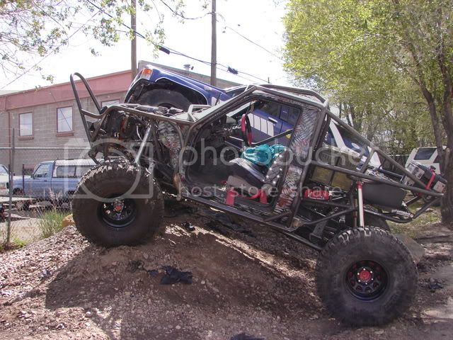

Lets start with what "she" kind of started out like (I wasn't fast enough with the camera before Mike started chopping and working!) "She" is the blue 4Runner...
Rear shock mounts

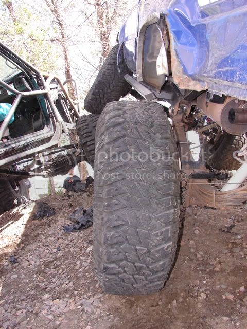

Front coilover suspension

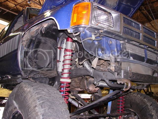

And the chopping commences.... at this point you can see the fender chops, and also the body lift has been removed, causing additional need for clearancing to the sliders

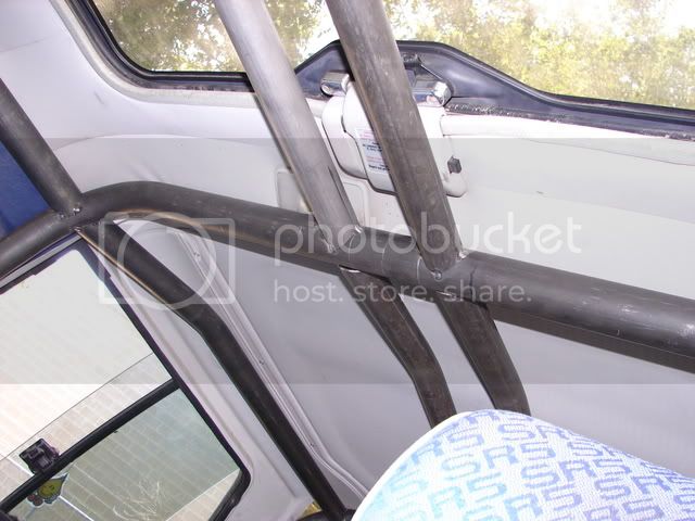

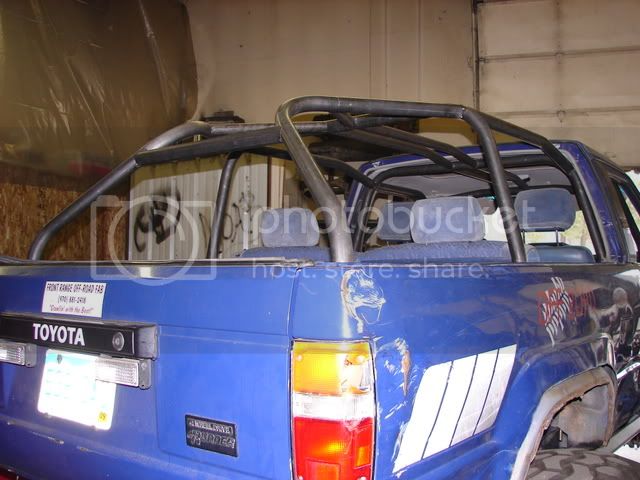

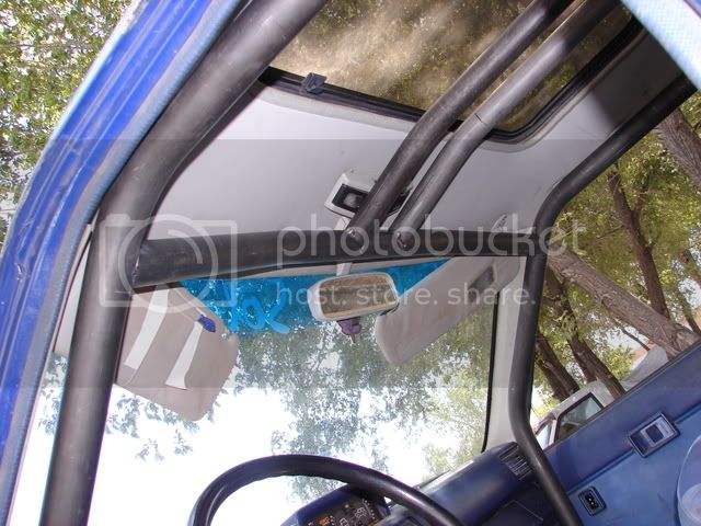

Mike also started building the interior cage... It is designed to be able to keep the top on, or remove it.
Now the cage is not done yet, there will be a section that comes all the way to the rear of the 4runner. Keep an eye out for updates as they happen & all the changes to come on this project!

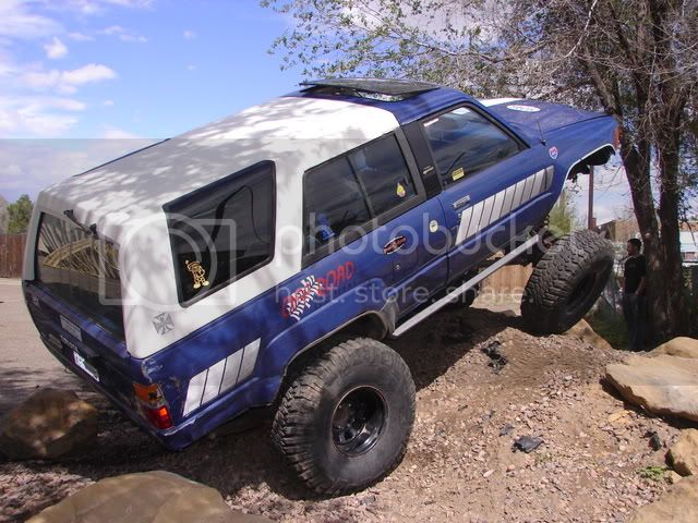

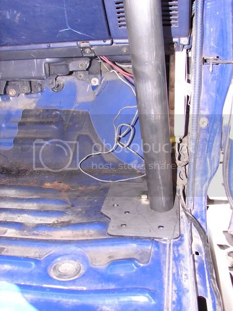

The cage is totally done! All the welding and footplates are done. Looks great without the cap and with it too.

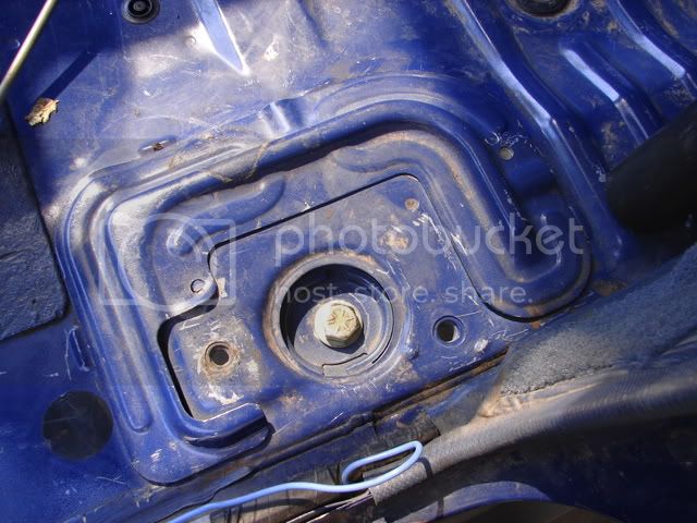

some progress pics and finished pics of where the footplates mounted and the finished product.

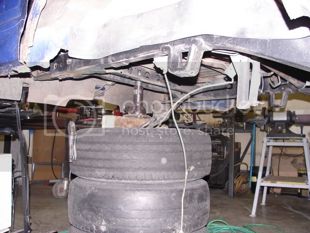

We cut off the rear springs to make room for a 4-link setup we are building in house. Another thing that was done after that, is a cross brace was added to the frame, and the frame was cut-off behind that in order to make room for the tube frame we are building for the rear section of the 4runner.
springs are cut off here:
The rear frame section that we built to replace the frame that was removed:
Where we cut off the rear frame, and added the brace:
