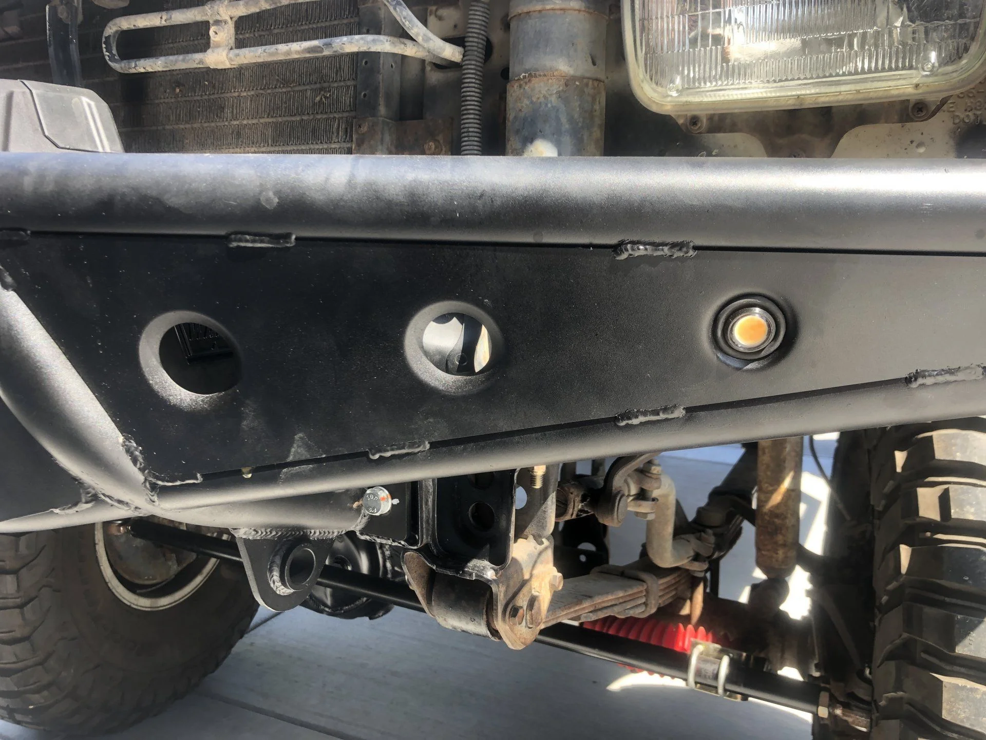

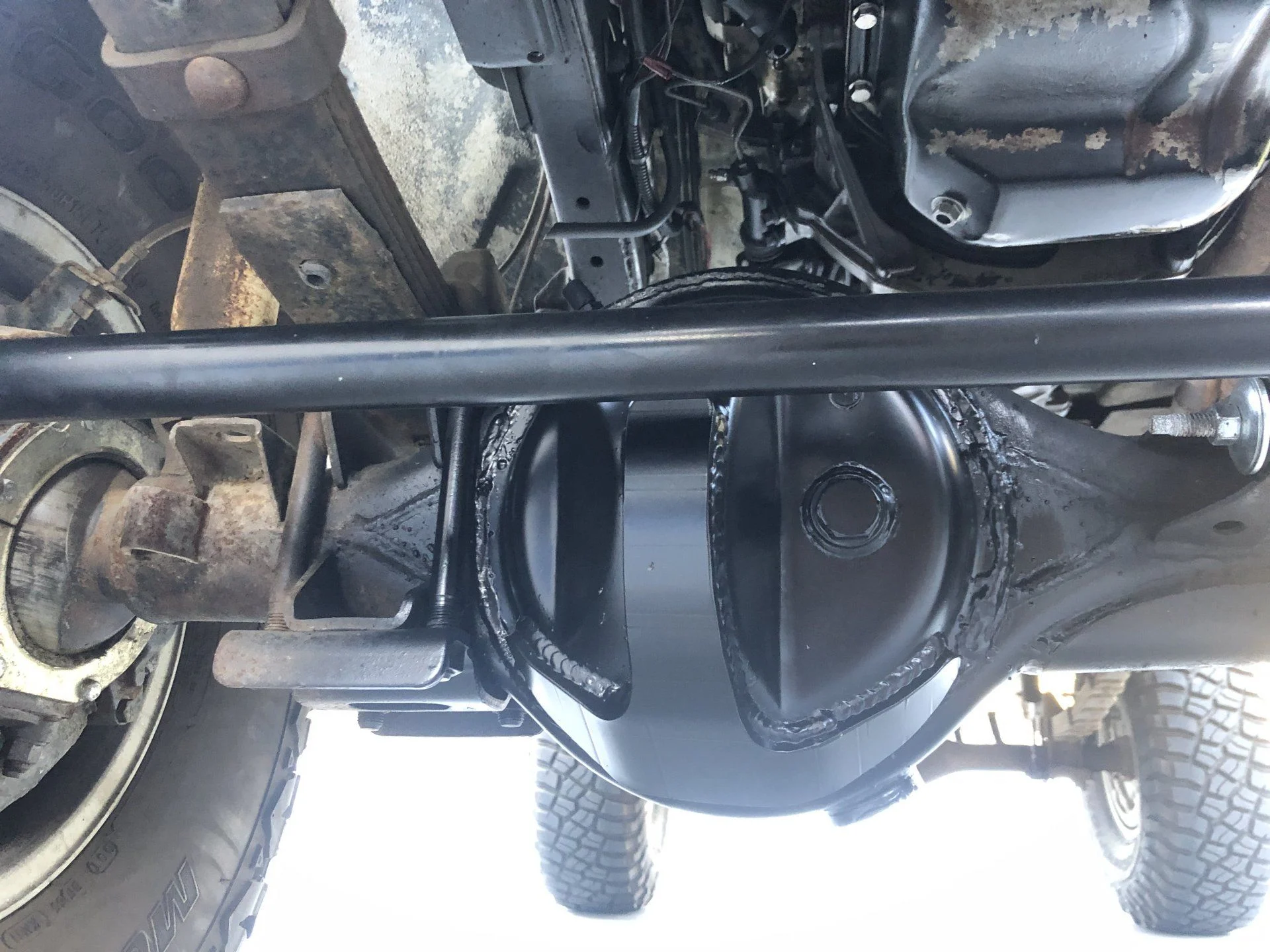

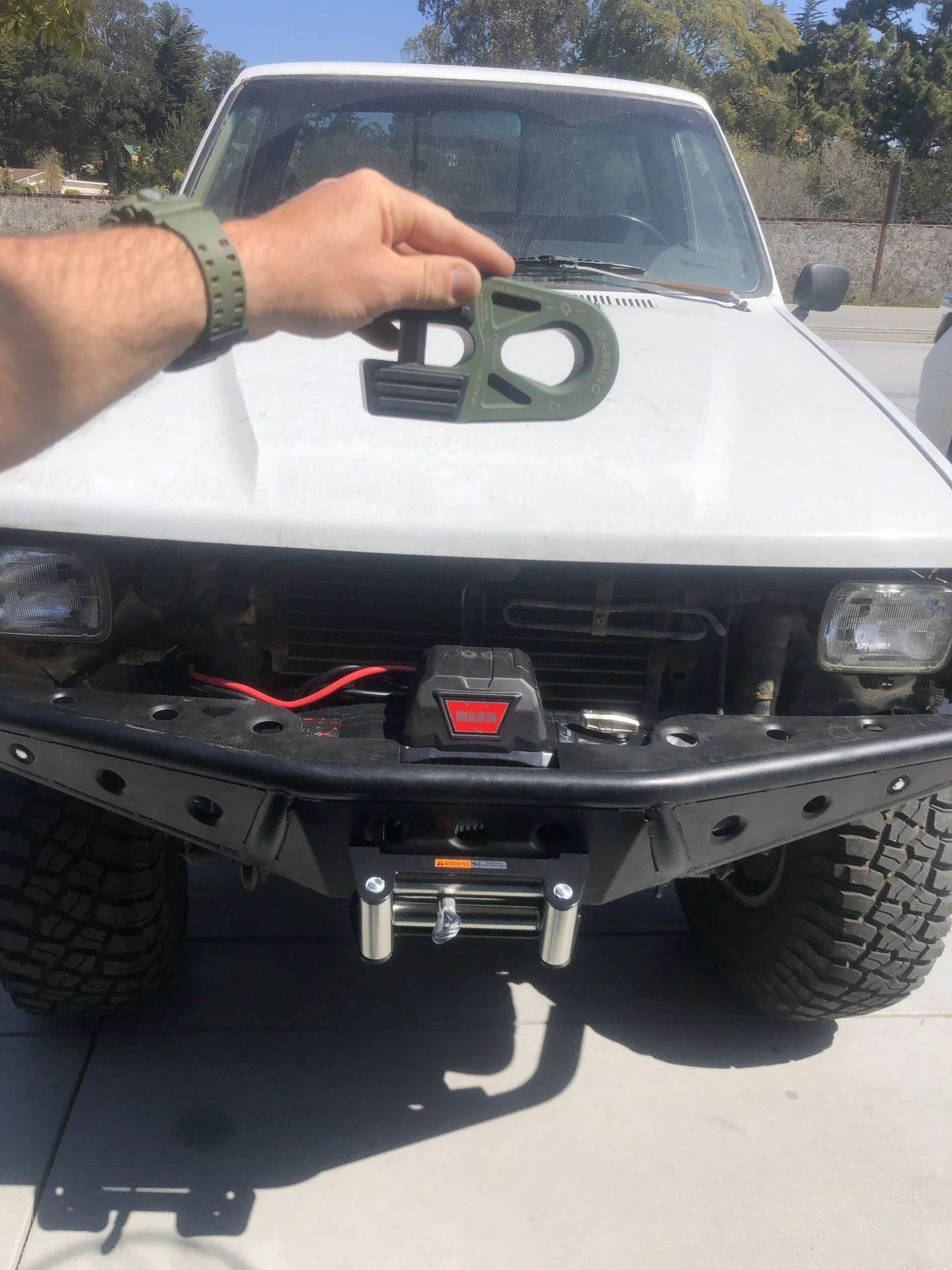

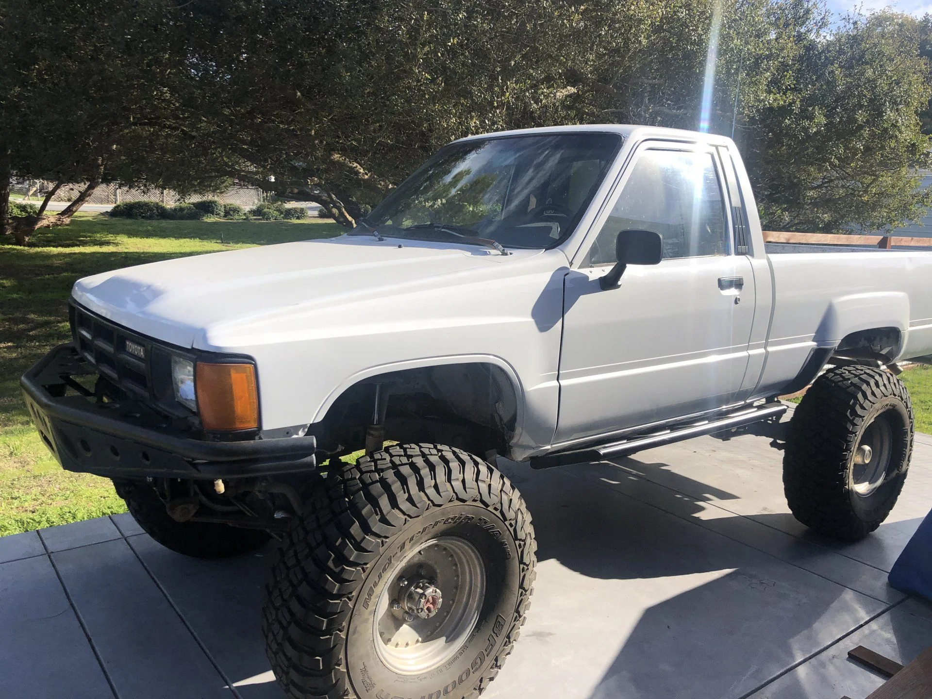

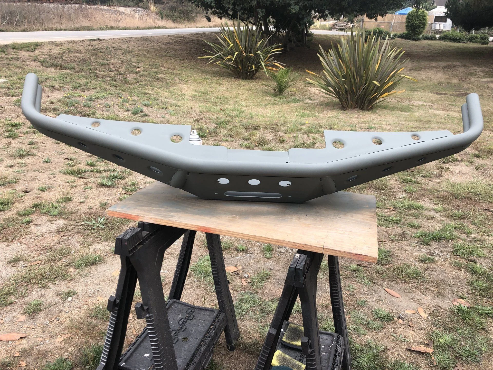

One the drive home, when I bought the rig I noticed either the tires or driveshafts were all messed up. So I took off the driveshafts and brought them up to a local driveshaft shop in San Jose, Southbay Driveline. Great people, built me two new drive shafts. All the owner asked me was how hard I was going to wheel this thing. Told him I was planning a couple trips a year to Rubicon and other places with it. So in those went. Solved the shaking. Then I noticed the tie rod had a slight bend in it. So I bought a new tie rod with FJ80 ends and installed that. (Still have to get it aligned, but for now it drives down the road straight). Next was the much needed armor and recovery needs. I got a Low Range Off Road front bumper along with the front bumper brace. The front bumper had been pushed in and was not going to mount right. Also bought a Warn VR Evo10 to install into the bumper. Ordered a set of Ruff Stuff DIY rock sliders and front axle slider and called a buddy, Mobworthy Motorsports (great welder) to get everything welded up. Once the bumper was mounted I took it off, made a slight mod to fit the winch, installed the Factor 55 closed loop flatlink E. What a difference those have made.

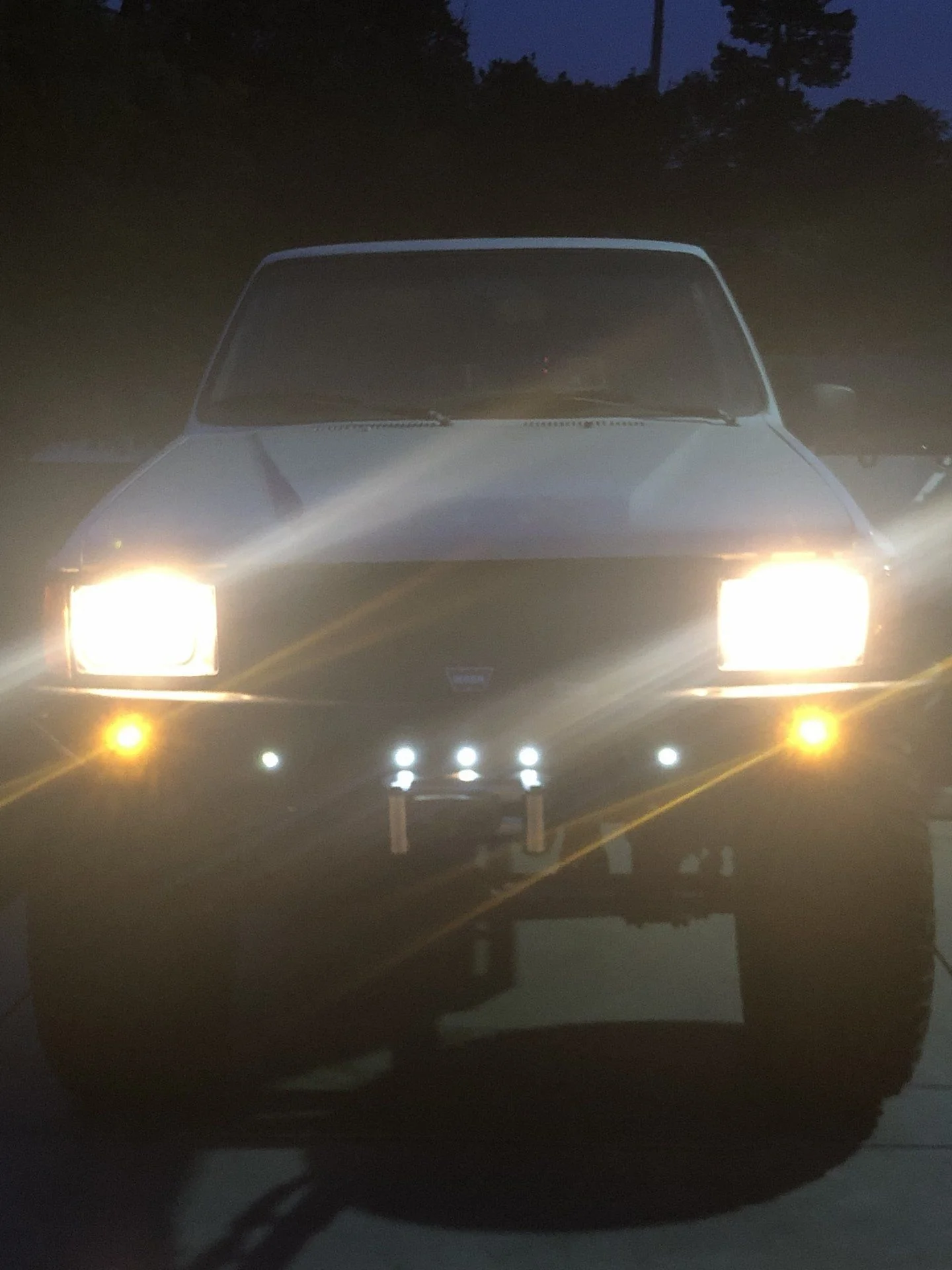

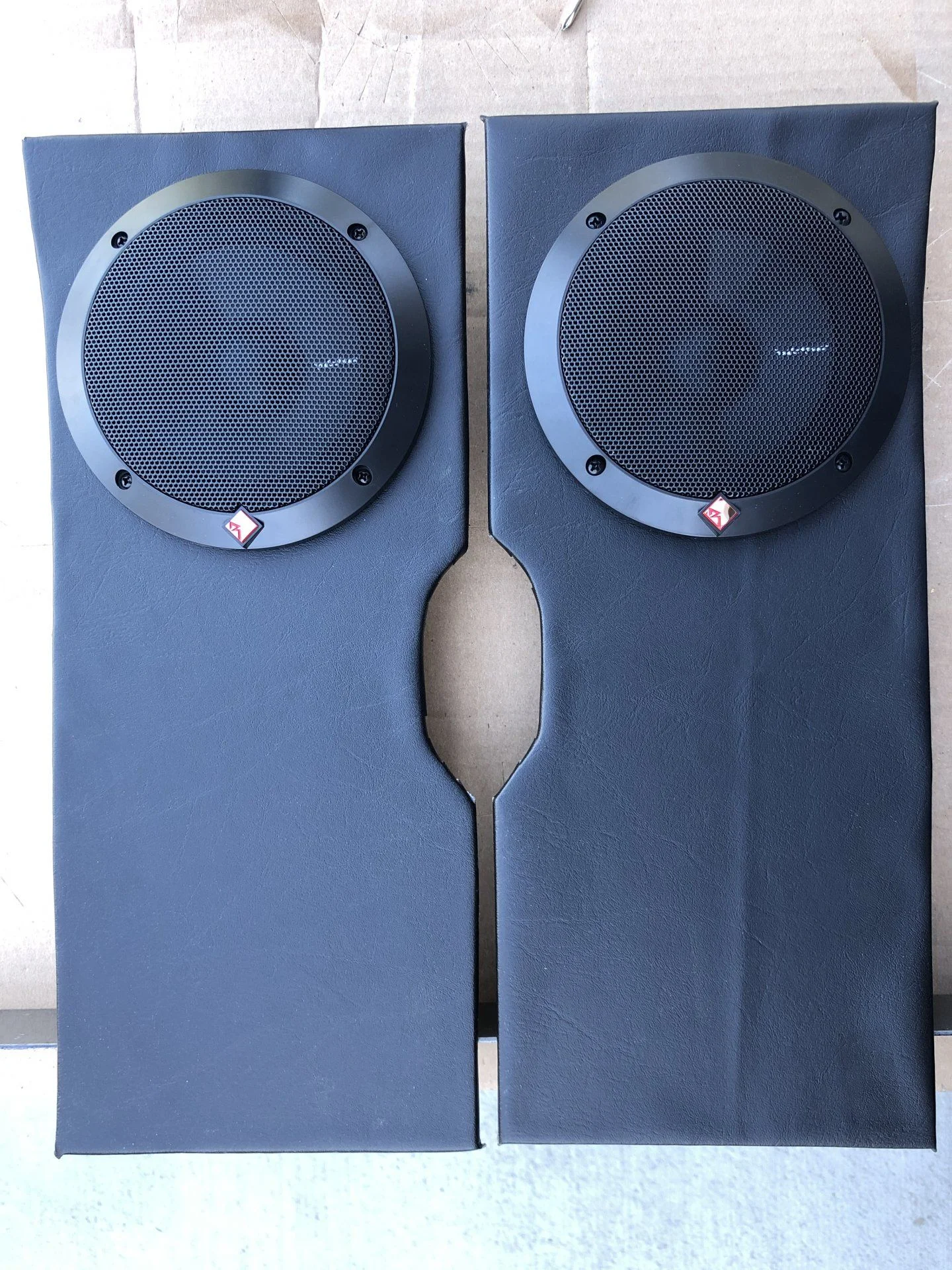

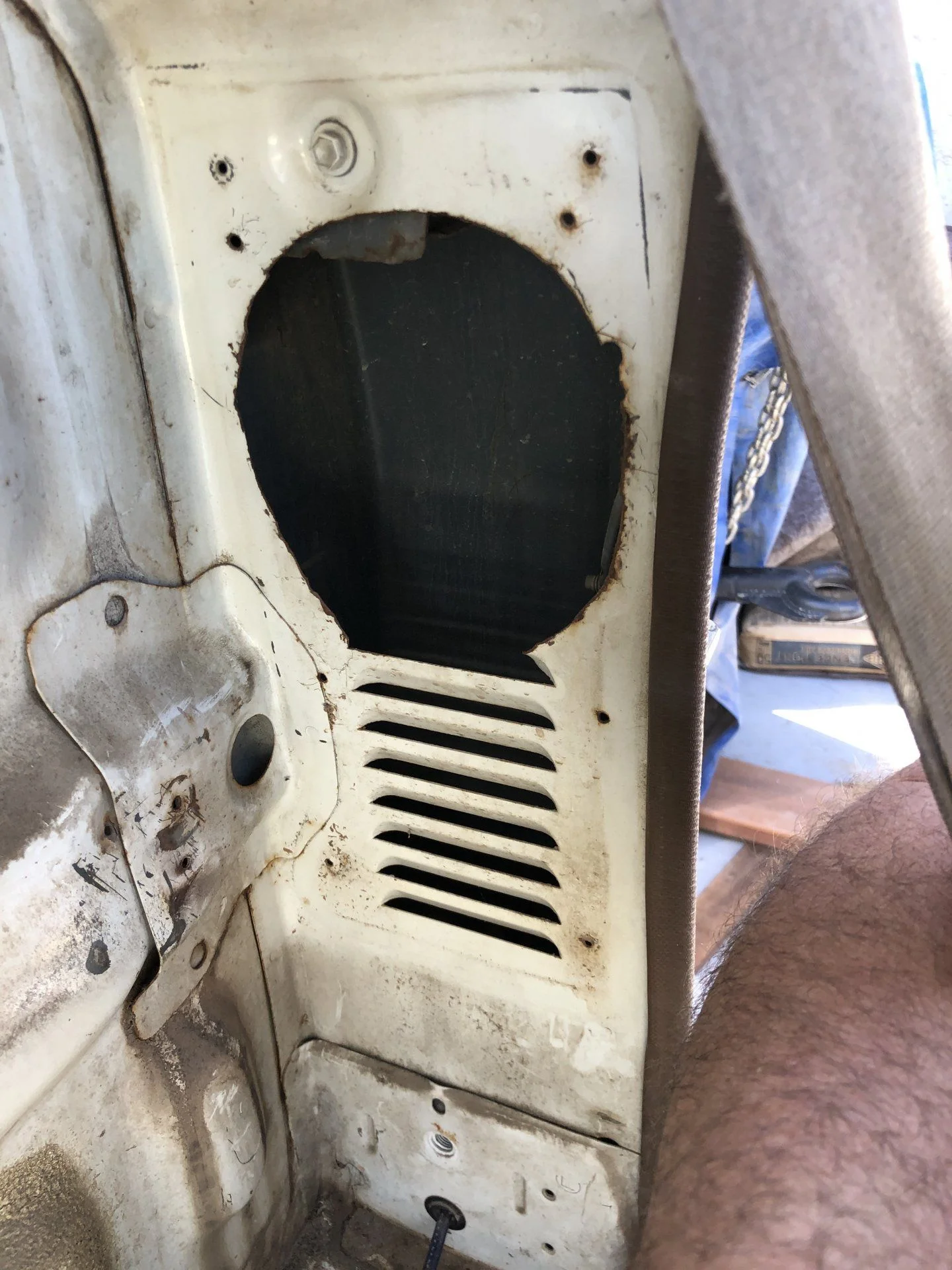

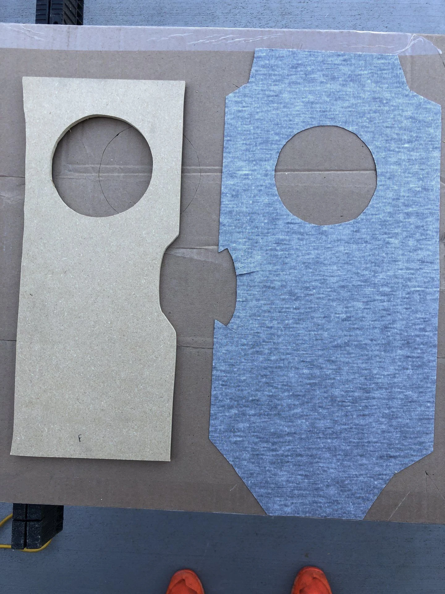

This last weekend I ordered some turn signal LED lights for the small holes in the bumper. Installed a couple of those to take the place of the side markers that were on the bumper. Additionally started to work on the interior. Will be starting to apply POR15 to the interior to the cab and made a couple of speaker enclosures for the cab as well.

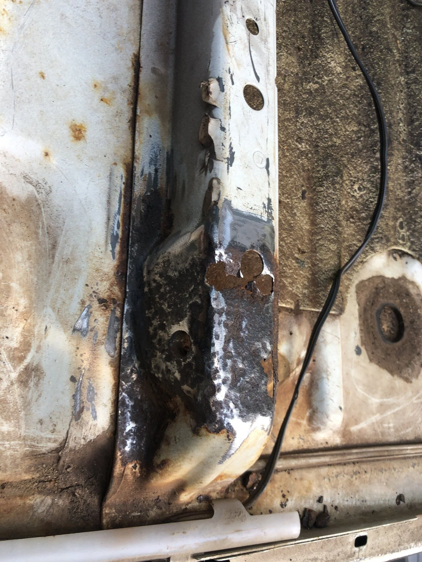

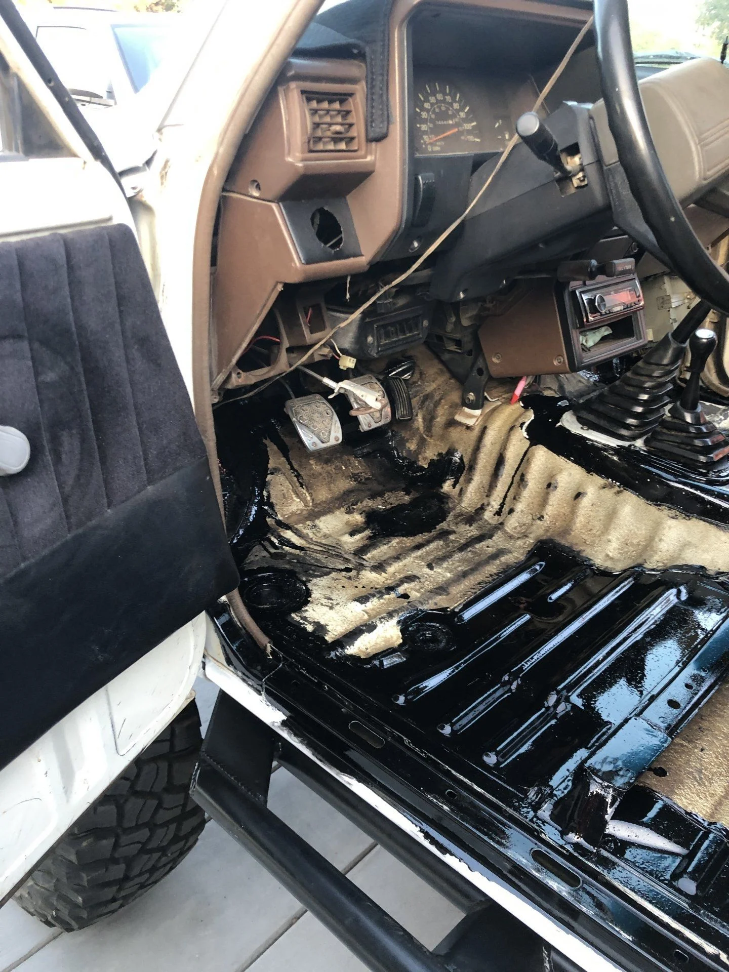

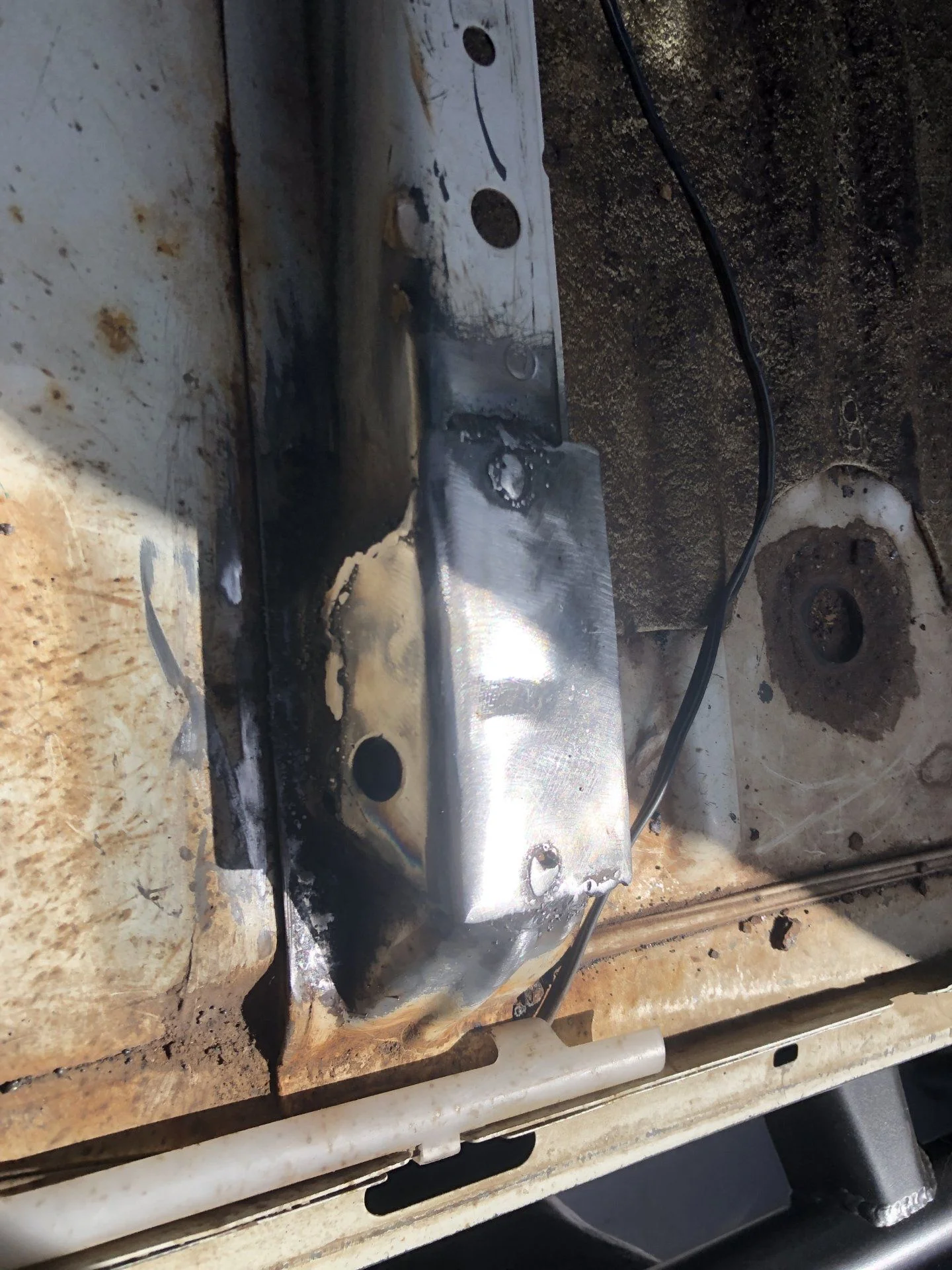

Continued work on the 85 this weekend (I am just going to refer to is as McFly from now on). The interior was in rough shape from water getting into the cab. The bolt for the driver's seat under the driver at the front was pretty rusted. So I bought a welder, a Titanium 170 from Harbor Freight, and fixed it. I took a welding class about 17-18 years ago in college, so its not really like riding a bike. It is in, it will work (hopefully) but man it is ugly. Once the piece was welded in I applied some Por15. That stuff is gnarly. Did the degreaser and metal prep then applied the bottom black coat and a top white coat (two for both of the latter). Look terrible, so looks like I will have to get some spray cans and tape off the areas that are visible. Won't really be that bad. Also got the lights all installed in the bumper. They look cool but the 5 white ones are not bright at all.

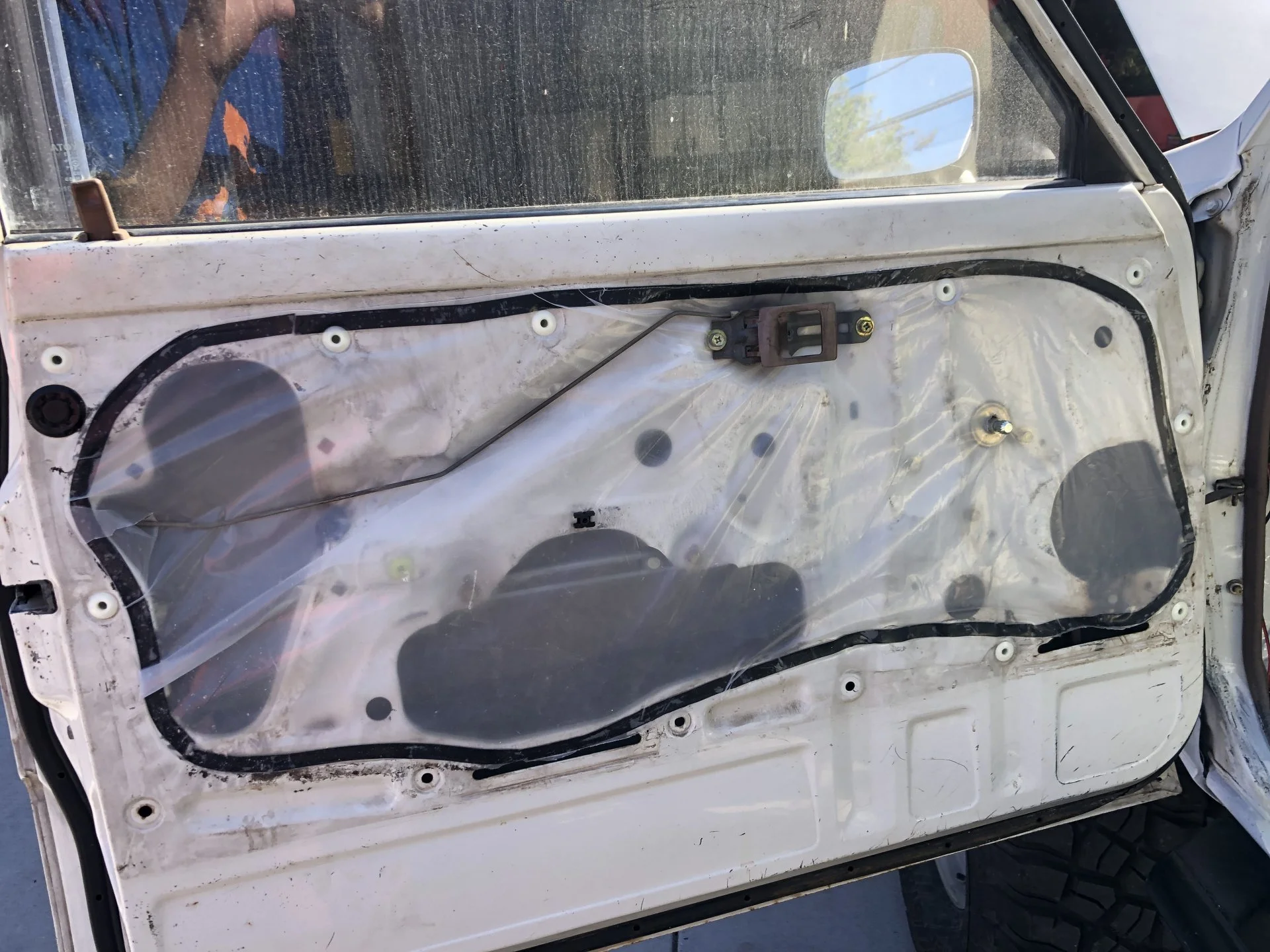

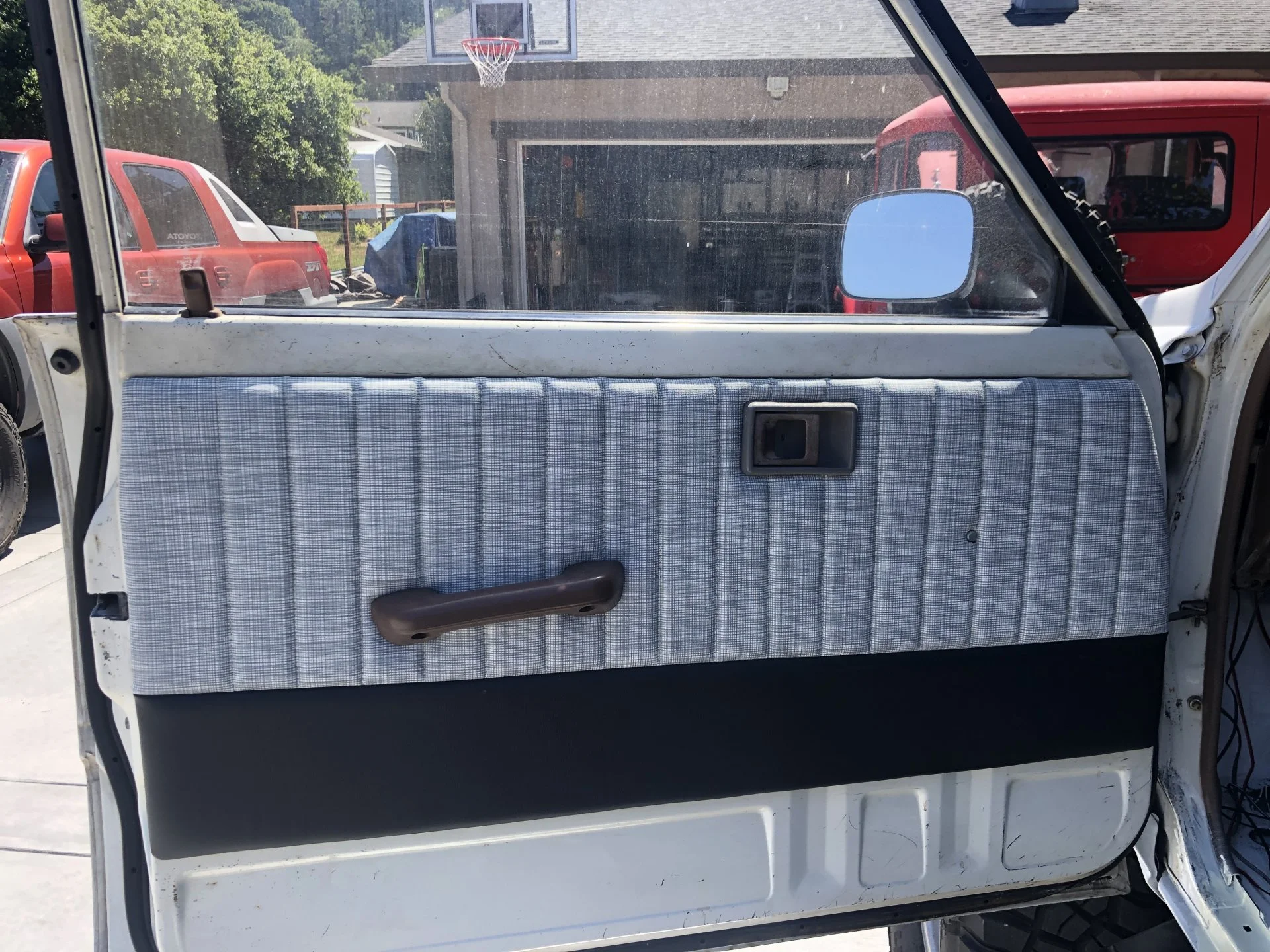

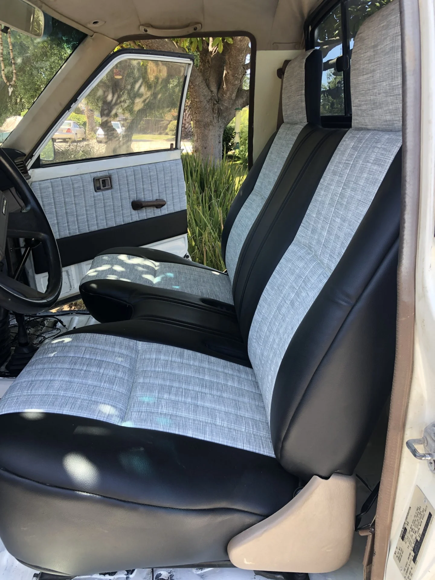

Made a little bit of progress this weekend on McFly. Was hoping to get all the wiring for the stereo done but did not have enough. So I threw in the seat and the door skins I have upholstered. Had to redo the plastic on the inside of the door panel. Really happy with how they turned out. Still waiting for the window crank nylon washer to install the new window cranks. Had to buy used arm rests. But overall looks so much better. Will be happy when it is all done.
