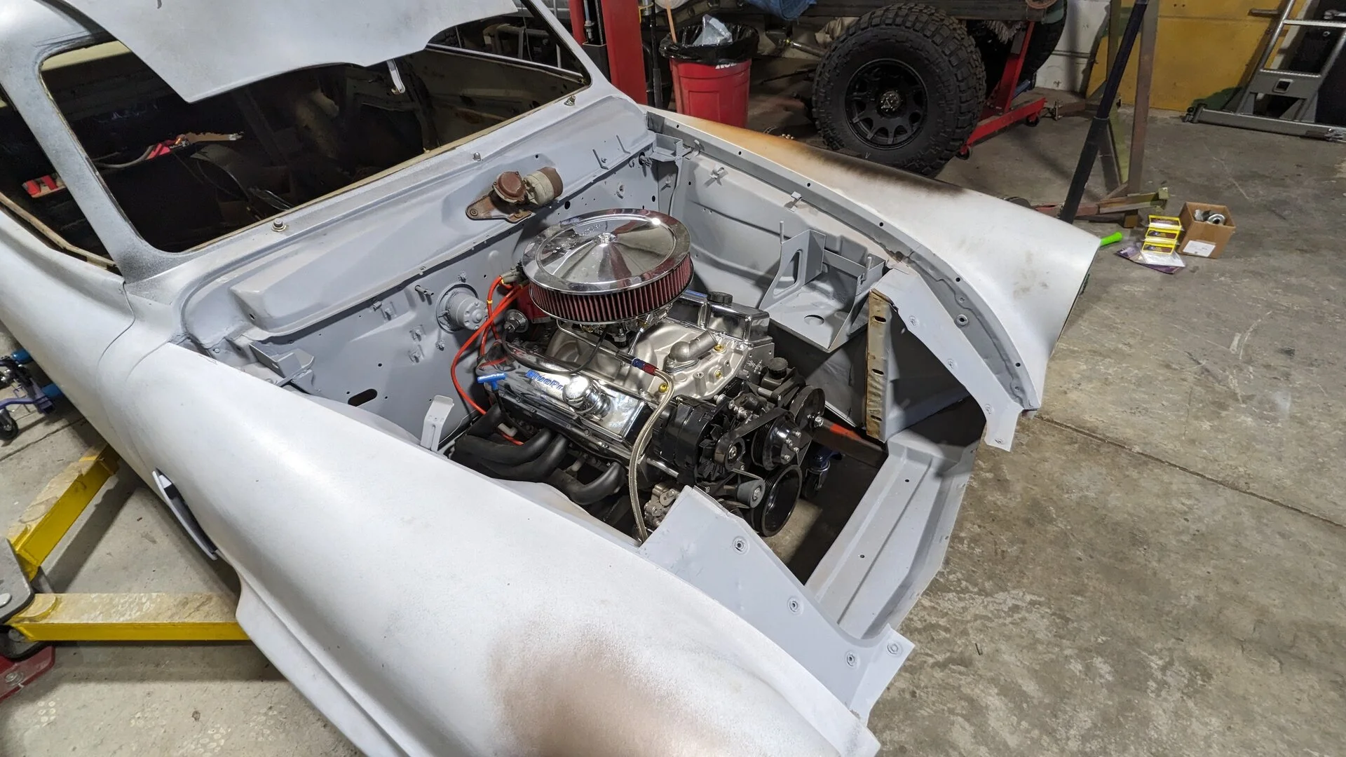

Cool plans. Pretty tough to move the seats back. The top well gets in the way. Firewall is very close to the back of the engine as well, but maybe with the smaller LS engine.

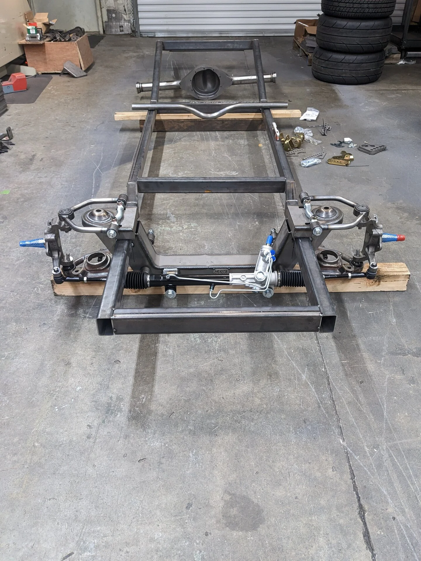

Currently looking at a Heidts Mustang II Universal front suspension. I might get lucky and they already have a set up that fits.
Similar to this, will most likely go with a power rack
Very cool, Thanks Jason. The guy I spoke with yesterday was doubtful any would fit off the shelf. A guy can hope :)

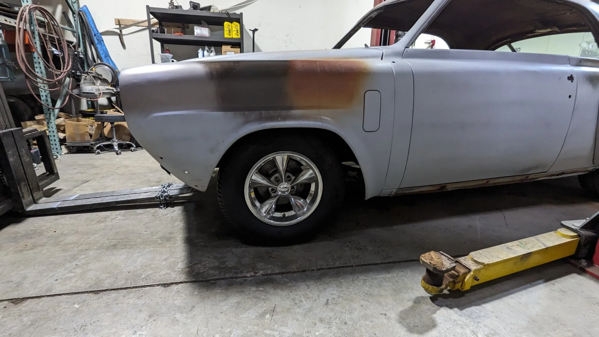

I like the wheels, they have an old school vibe to them. Not Crager or Keystone but in that family.
Give me a call and we can go over WMS measures and frame widths per the Mustang II offerings of Heidt's.
J

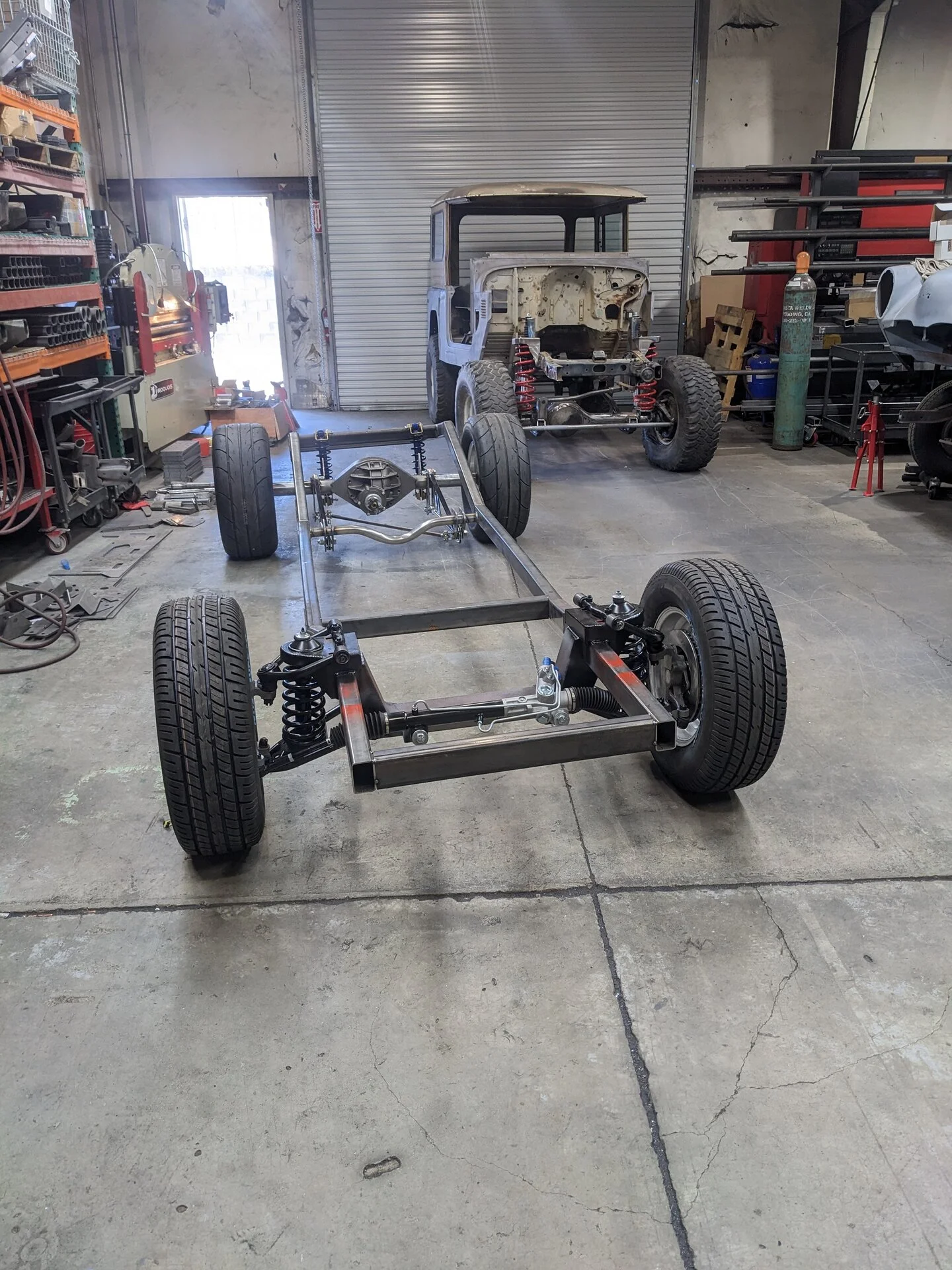

Will do. I believe OEM is WMS-WMS is 58.5" Frame is a relative term in my case, all unibody. I am just getting to cutting out everything I do not need and looking at what might require plating etc. prior to getting final frame measurements.

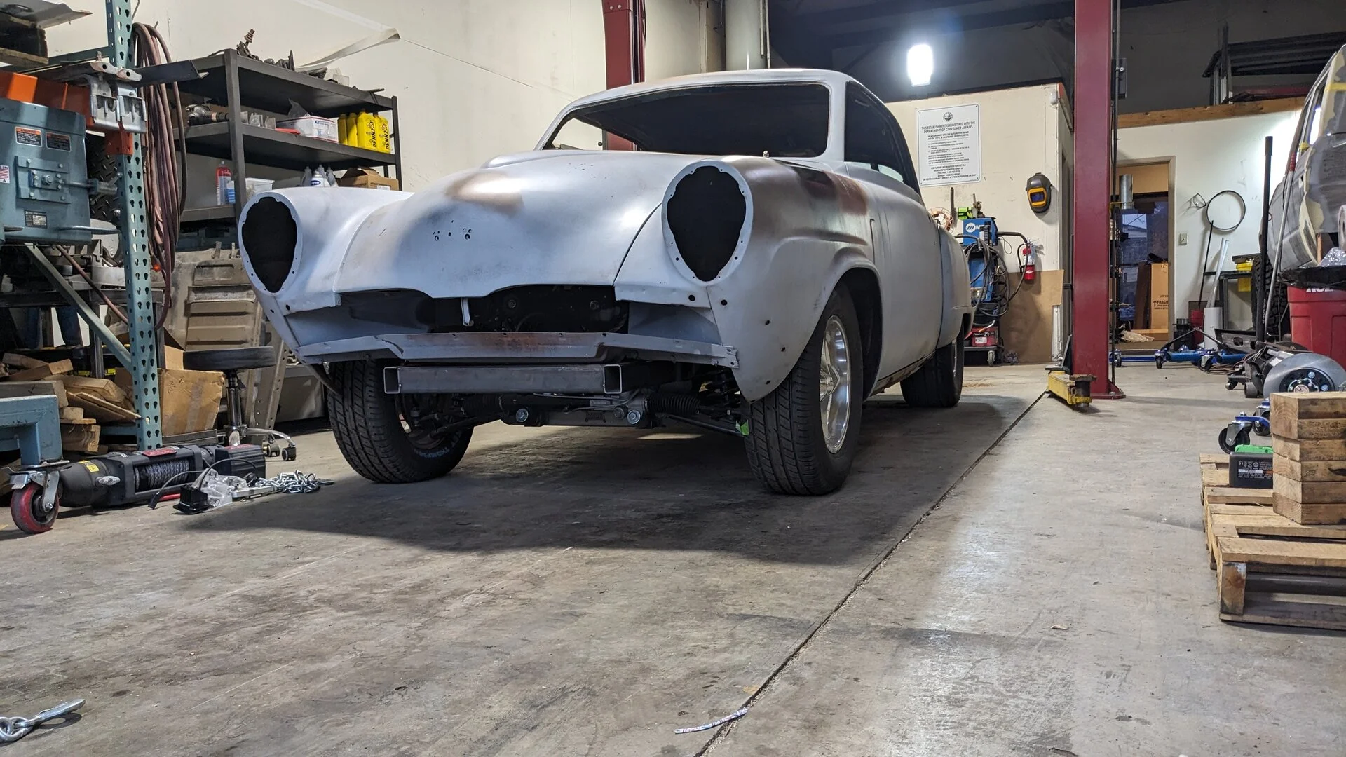

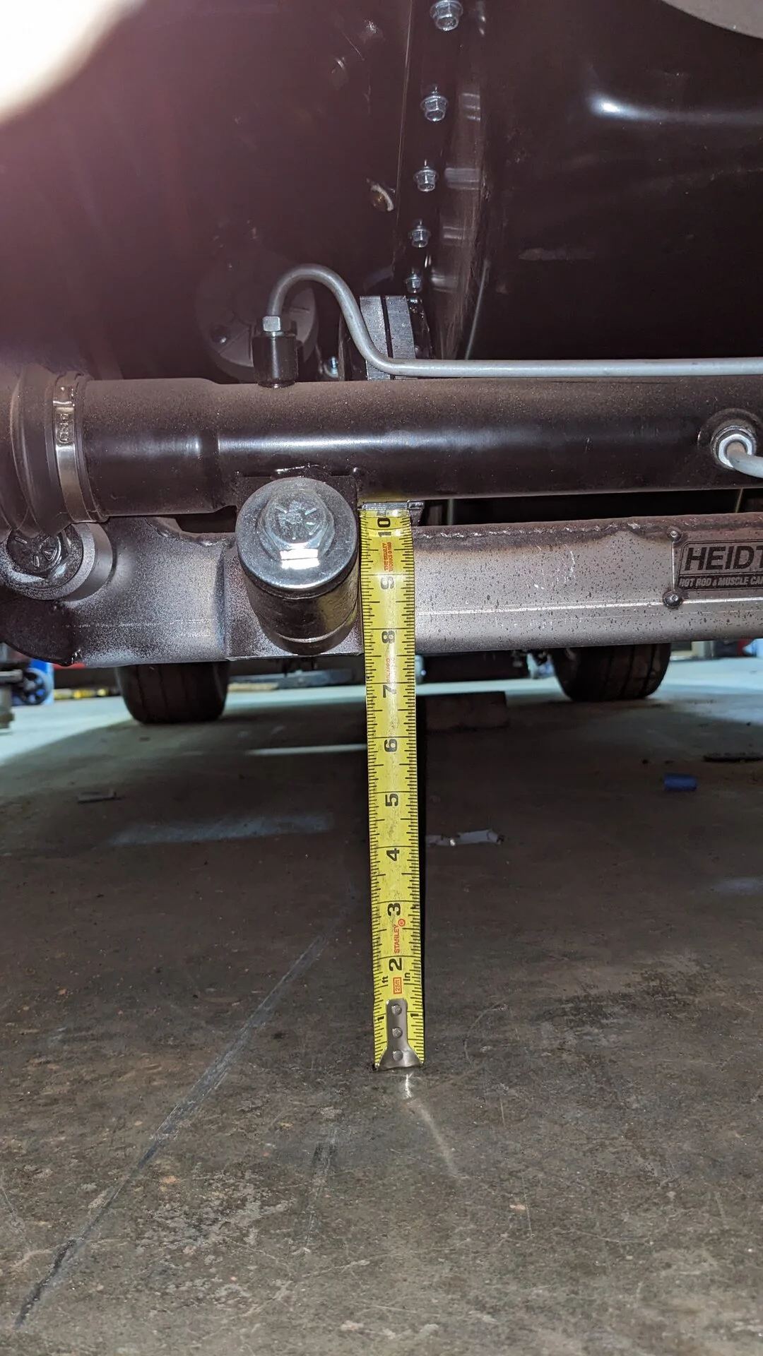

Now sitting 3" lower than stock as measured at the pinch weld under the rocker. Axles are set at 13" center, 26" tire on 17 inch rim. OEM WMS to WMS is roughly 57" (differs front to rea a small amount) I am thinking of going with 56" on the new set up. I might :) have to do some tubbing.....
