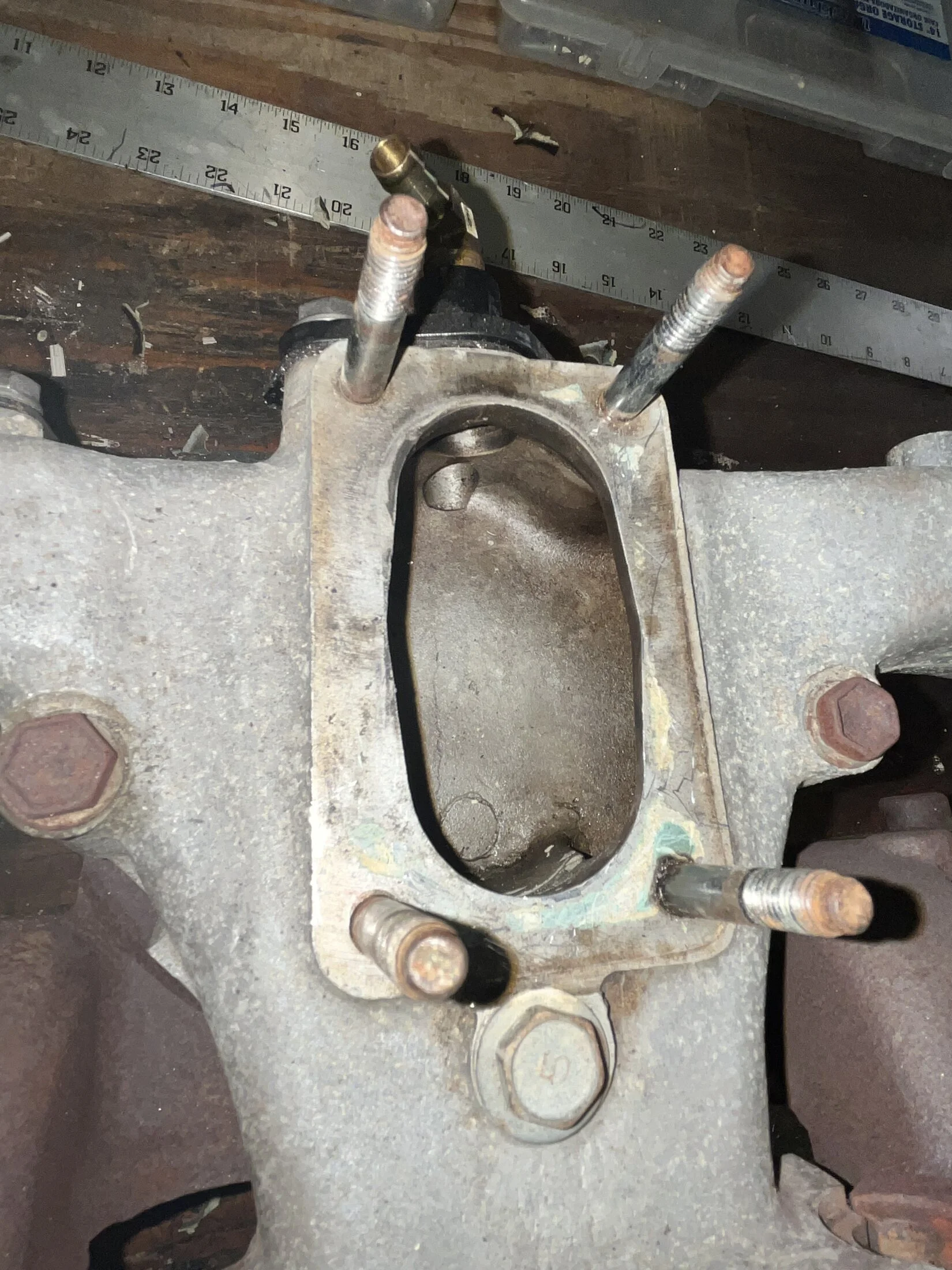

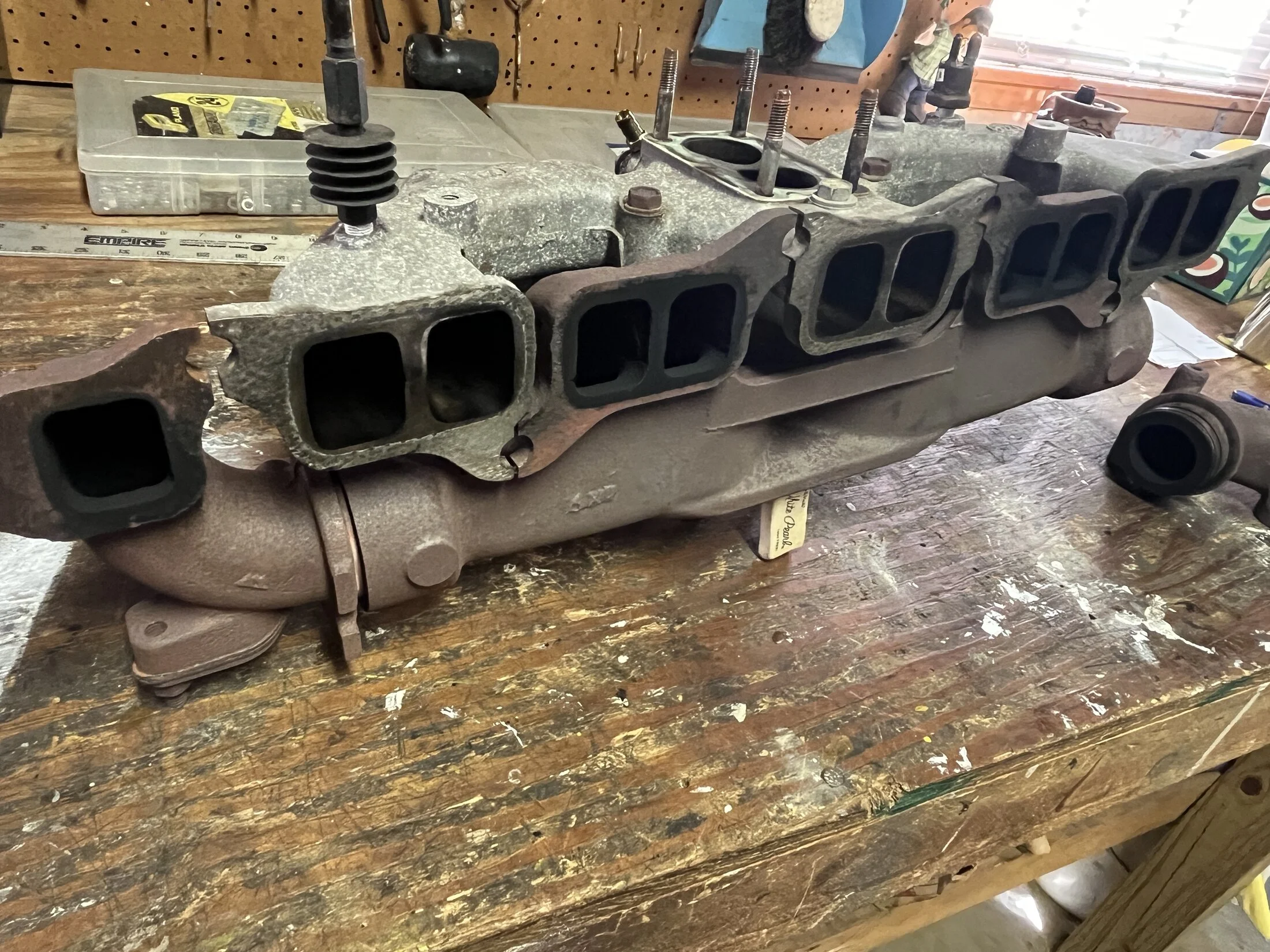

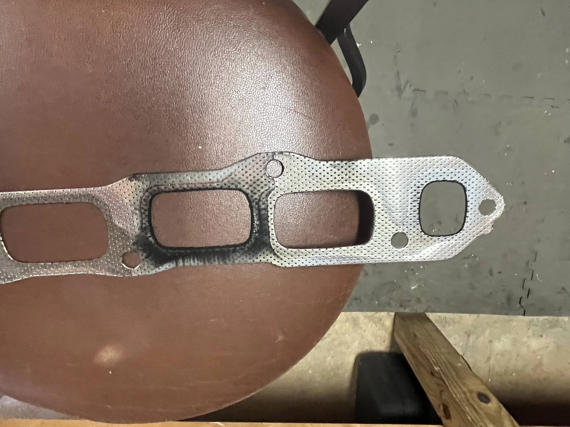

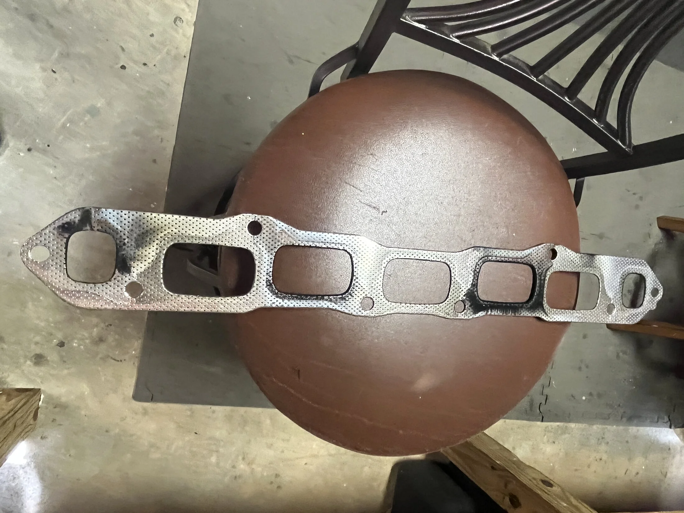

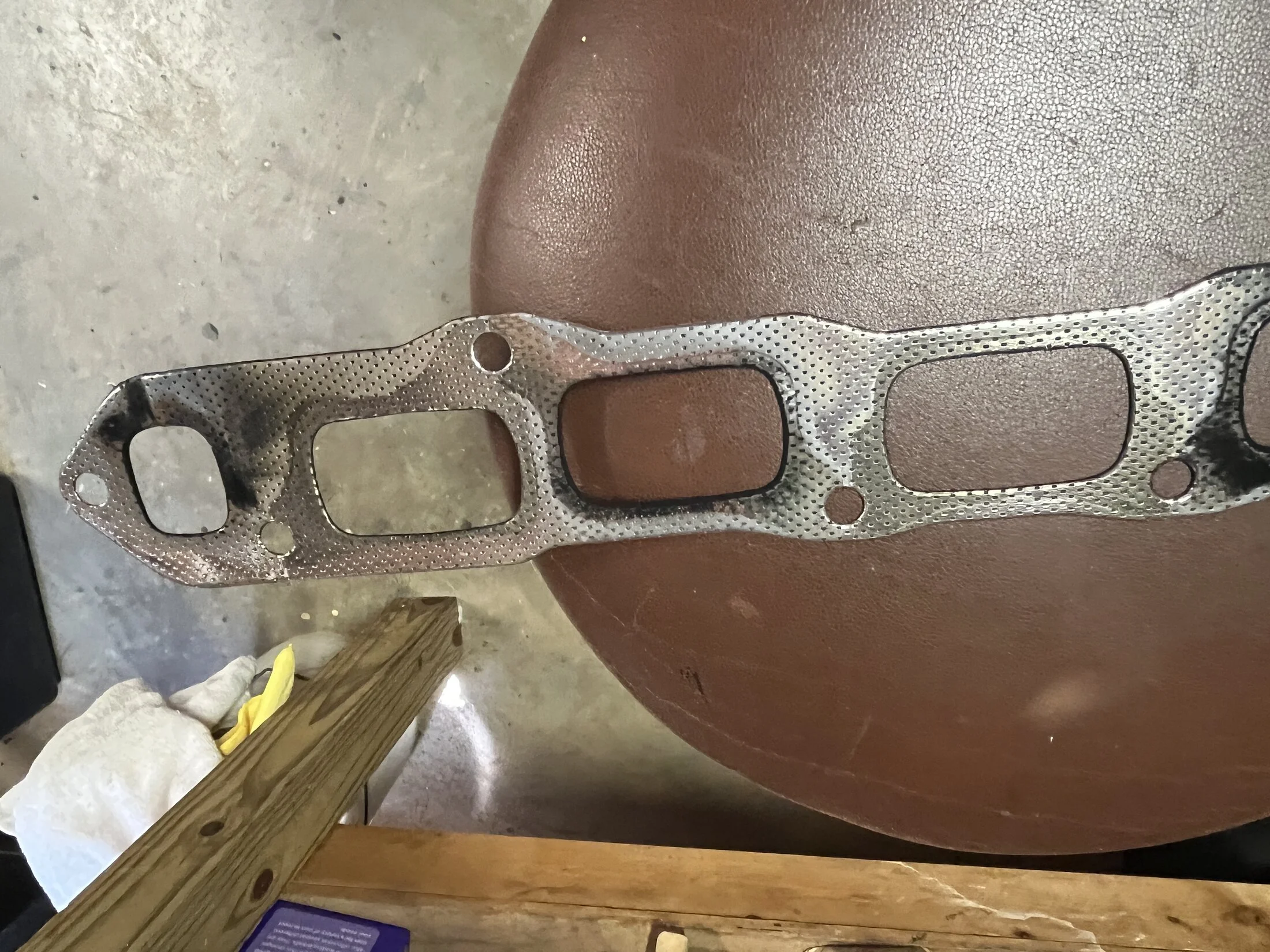

I have a 1982 FJ40. It has an exhaust leak that is coming from the manifold I believe. Previous owner told me it had a valve job not long ago. I know the intake / exhaust manifold must be perfectly straight for a good fit against head. I assumed it was warped but looks pretty straight to me. I will picture gasket below that does show black around one exhaust port.

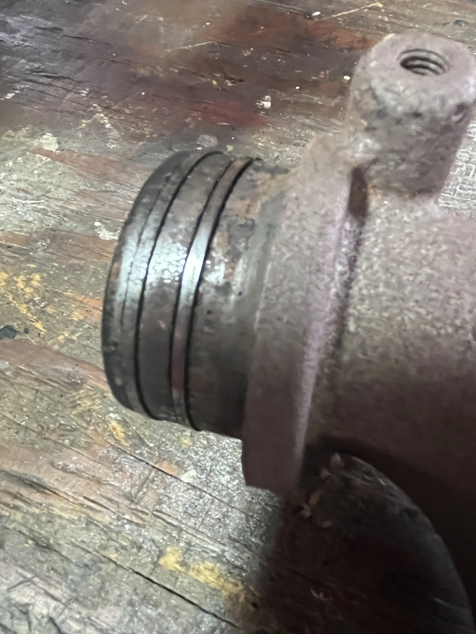

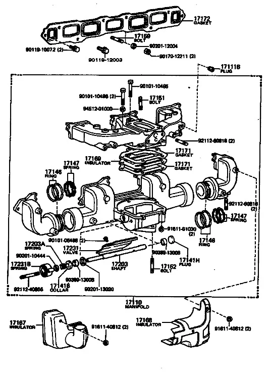

Another thing I noticed is I know the end pieces on the exhaust manifold remove. I thought there was supposed to be 1 spring 17152-61010 and 1 ring 17152-61010 in groves. OEM diagram makes it look like there are 2 rings and 1 spring. Is this correct or 1 ring and 1 spring per side. Currently there are 2 17152-61010 installed and no spring.

It looks to me its leaking everywhere. Being flat and straight is more than looking flat/straight. You can check with a good straight edge and a light. You could just plane it some on a big piece of glass and some sand paper.
I would make sure there is a large stainless/brass washer that bridges the gap so you can apply even torque to the manifolds in the proper order going up 1/3 each time. If say the T spec is 30#, do 10, then 20, then 30. I made custom stepped washer for my header because there was like 1/4" thickness difference between the steel header and the aluminum intake. I did longer stainless steel "studs" and used 2 wet gaskets. I also put a V notch in the air filter bracket so I could easily get a socket on the nut.
I always soak that type gasket in warm water for like 1/2 an hour - it will soften enough to allow the high spots to dig in. After you fire it up and it gets hot, let it cool and re-torque at the final #. I use high heat anticize compound on the nuts.
In addition to ☝️, it's also common for exhaust to leak where that shaft (17203 in the parts diagram) enters/exists the exhaust manifold. If you search, there are ways to solve that one permanently. It would be a shame to do all the work to put everything back together only to then find a big leak around the heat riser assembly.
No clue but $or.com has them for $30 and $16 each - that could be like $100. The pic I saw shows one of each on each side for 76-87
maybe I'm seeing things in your intake but it appears to have a crack in it.
your current intake/exhaust gasket is cheap not a stock item, there should be a sealing ring around each opening. and probably not installed correctly
I have a good old school machine shop in town that will face the intake/exhaust combo, to make sure it is totally flat, adds expense but not something you want to do over again

I use OEM gasket only

Each ring gets a spring, there are two sets on each side as the diagram shows.
I fit the manifold the the block without a gasket and temporarily welded the horns to the manifold proper. Then had the whole thing flattened and ground down the welds.
I also removed the flapper, welded the shaft shut and placed a blockoff plate.

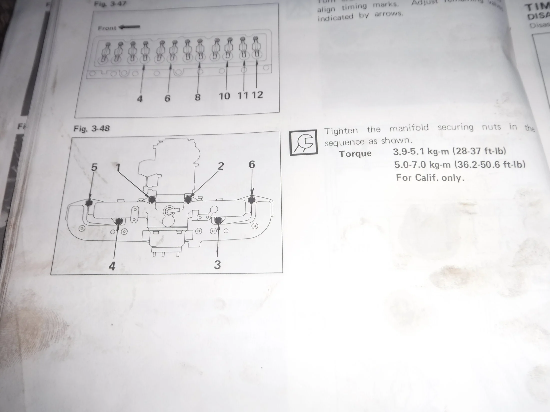

I checked my FSM and don't see a torque recommendation except for California. Does anyone have the sequence?
still need this?
Thank you! Found that one of my end exhaust manifold pieces had been "worked on" by a previous owner. I had a replacement and the assembly showed perfectly flat with my replacement end. Used an OEM gasket, rings, springs, and your torque sequence. Reinstalled and... no leaks.
