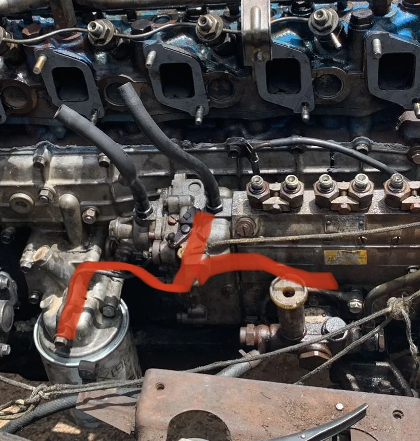

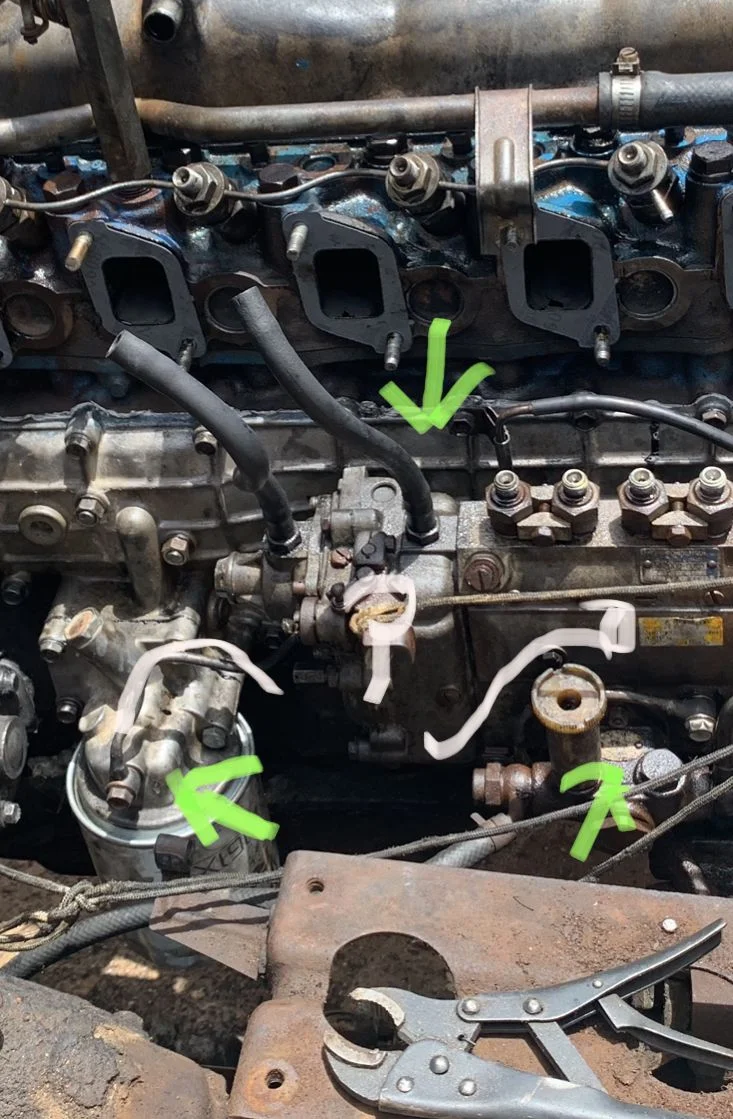

2h oil cooler filter housing replacement from original oil filter spinner type housing to a later model 83 on oil filter housing /relief valve .
New filter housing has oil banjo oil line off housing usually directly to injection pump then front timing cove but this also has a feed I’m guessing haven’t gauged it yet direct from engine block directly to injection pump. Is it fine to tee filter housing line into same line? After market adapter etc?
