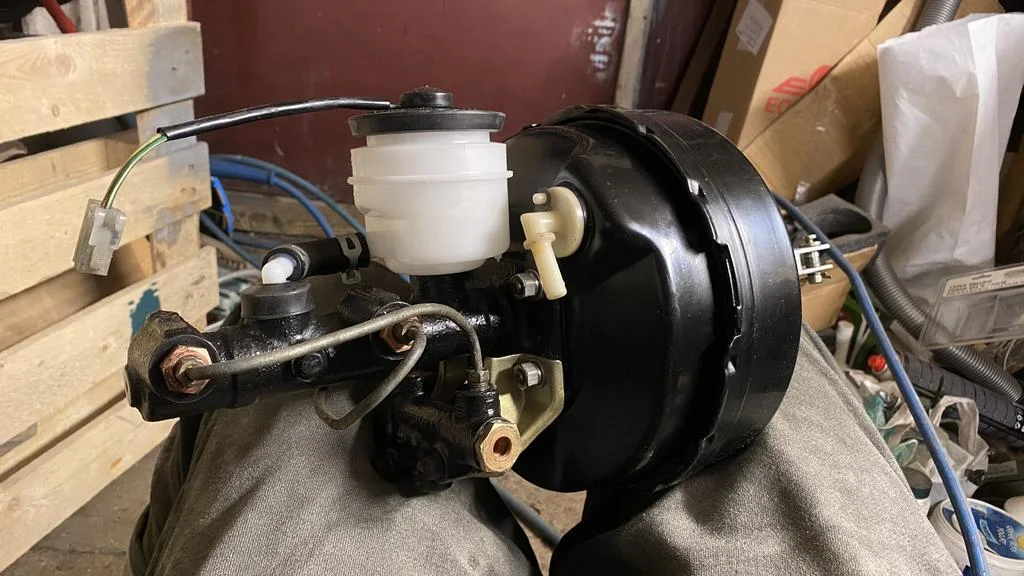

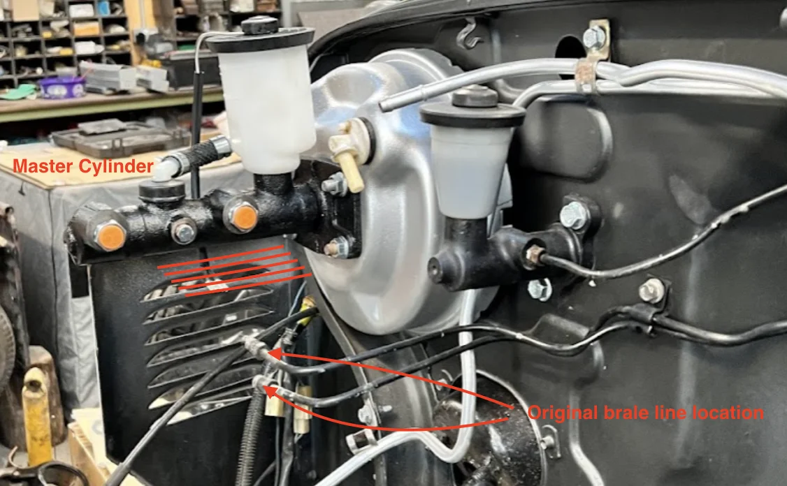

Hi everyone,
During my build a few items went the way of the dodo and i'm looking for advice on one of the parts that i cannot retrieve. The entire master cylinder disappeared and I have attached a current photo with the part that i'm missing (where the red lines are). It looks like an additional brake part should be under the master cylinder. The original pipes are reinstalled in the correct positions but don't match up with the new master cylinder? Anyone have any experience with this?
Maybe the proportioning valve?
That’s excellent
Hi Matti, that looks like it could be the part for sure. Thanks for following up so soon. It should be easy enough to get hopefully.
