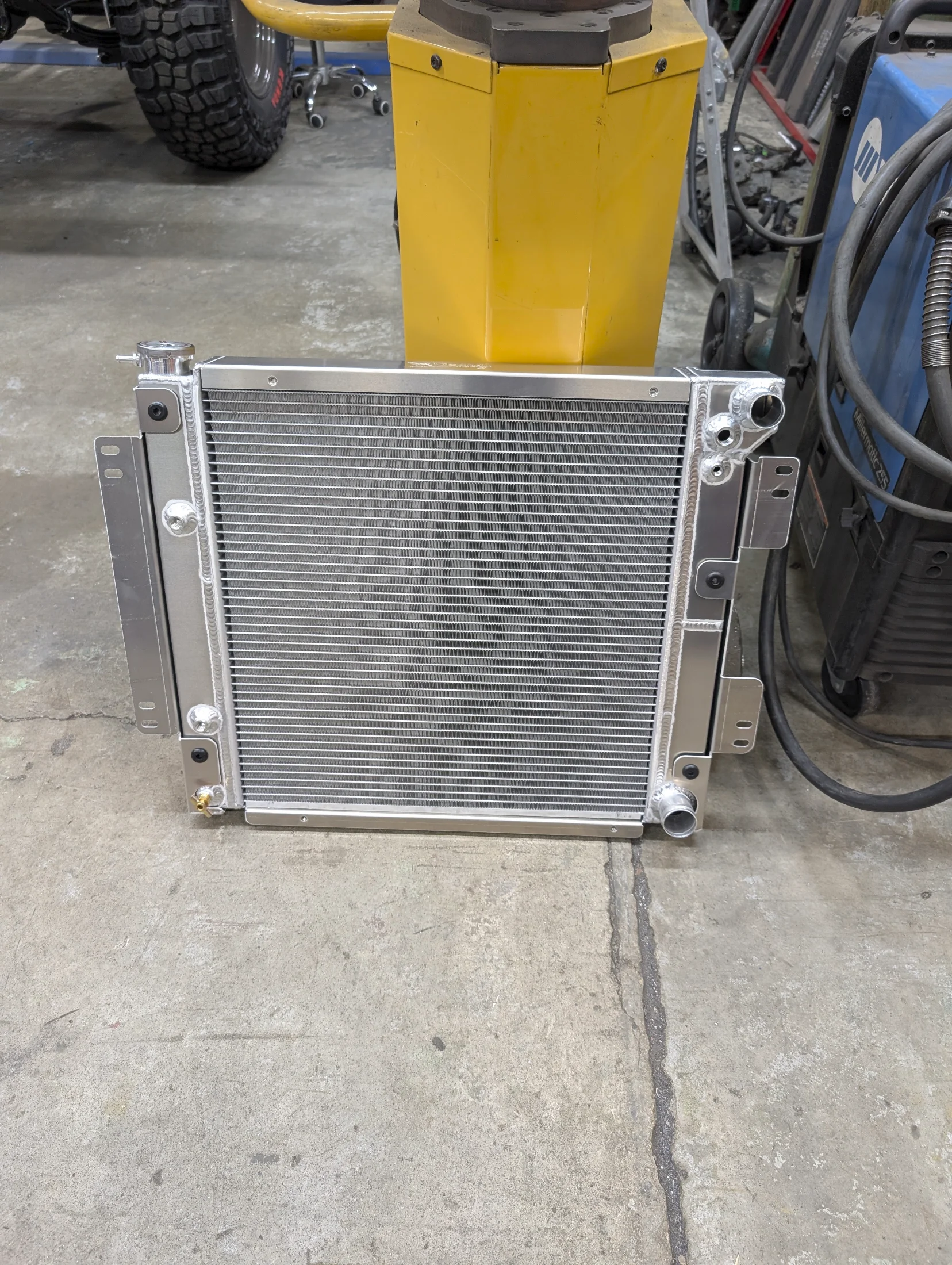

Radiator arrived and will get it set and plumbed in tomorrow.

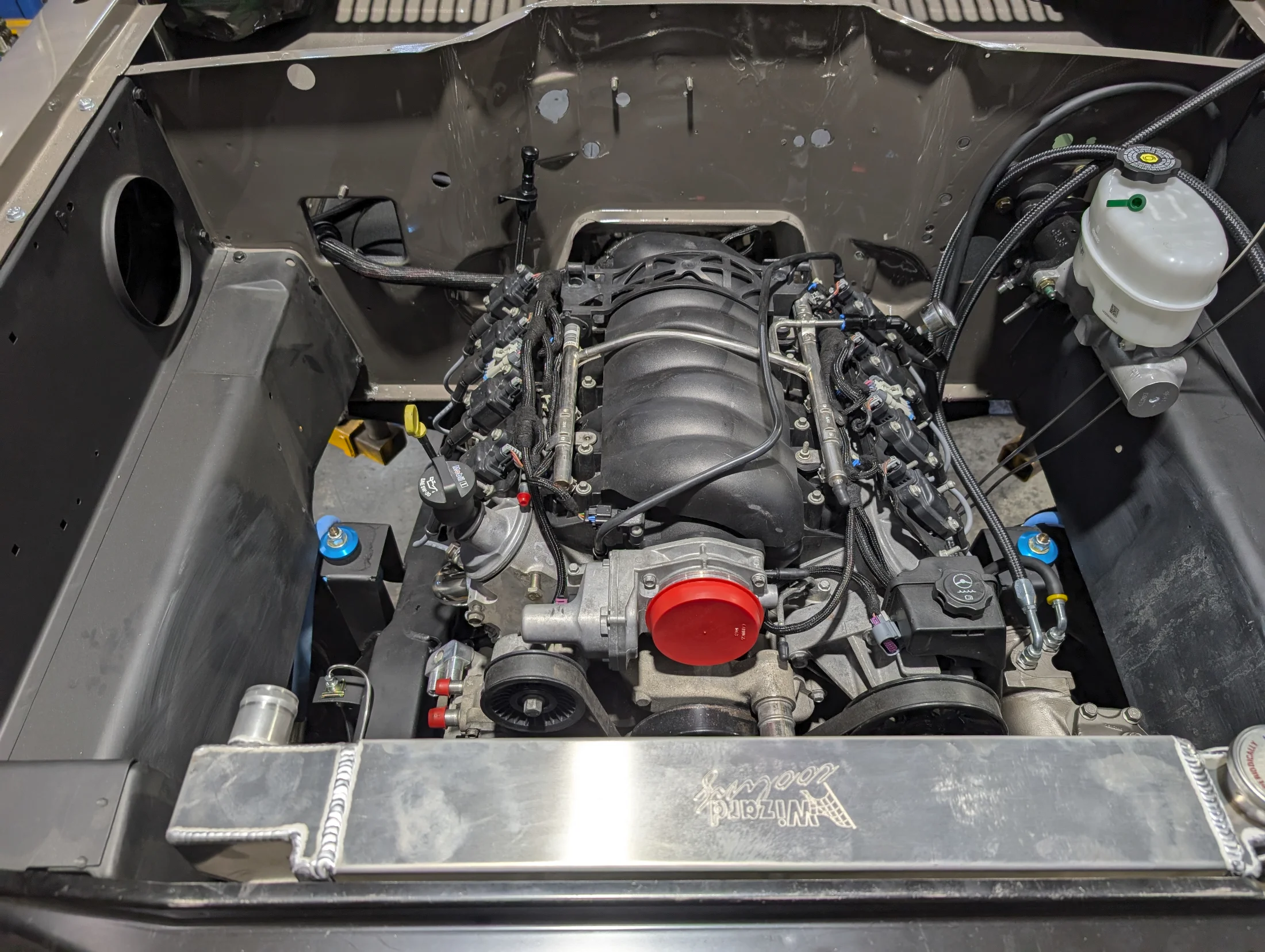

Body is set and going to check everything one more time before bolting it down, but shouldn't need to pull the body again for any reason.
Radiator is set and I'll get the trans and brake lines finished tomorrow. Drew the firewall block off plate for the heater/blower port. Will be using a billet 2 piece grommet to run the wiring loom through to finish it off.

Made up a fan shroud for the Wizard radiator. Using a SPAL dual speed 2800 CFM brushless drop in style fan.
Hoses are modified.

Fan shroud is finished and set with SPAL dual speed fan.

Hydroboost, trans and brake lines are all finished.
Run the trans and Atlas vent lines in the morning and body will be bolted down.
Engine bay is coming along. Started running the Portland Wiring harnesses. Body is bolted down.
