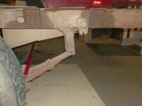

I had to remove this exhaust hanger to gain a little more volume in my tank. The new exhaust will run down the other side of the truck.

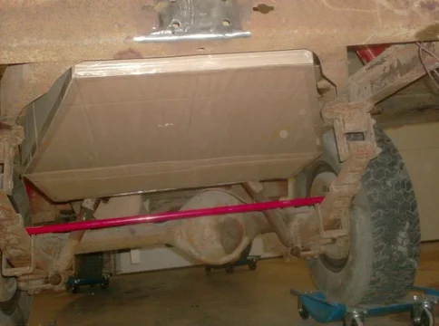

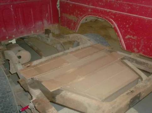

I mocked up a cardboard tank and test fitted it. I like to do it this way so I can better visualize the end product.
Side view. The departure angle of these LPB's isn't great and I have visions of the tail end slamming into the ground as I go over an obstacle. I kept the tank up high and I am contemplating some sort of skid plate or slider for protection.
A couple more...I kind like it. I'll have to calculate the volume.
The auxiliary fuel tank will go ahead of the rear axle but I ran out of cardboard for now. I did take some time and plan out the receiver and rear bumper. I start work on that during the week.

If my calculations are correct the cardboard tank should hold about 21 US gallons or 80L.
24 - if that's not big enough I'm gonna do a fuel tank on mine ahead of the rear axle between the frame rails. It will hang down beside the drive shaft a little and then over the shaft. It will occupy as much volume as I can get between the rear axle and the cab/transfer case. I'll layout that one during this week.

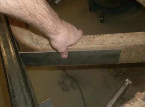

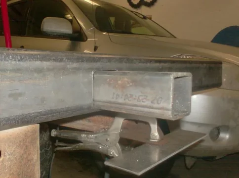

I had a plan for building the rear 2" hitch receiver but after talking to a couple of the more experienced guys at work I altered it a little. It has to be very strong - not only for the obvious reasons but because I plan on using my second 8274 on a hitch mount in the rear as well. I am going to remove the rearmost crossmember from the frame and replace it with a 2"x4"x1/4" wall tube. I am doing this to keep the receiver sleeve as high as possible to preserve what little departure angle I have and for strength. The sleeve will be cut into the tube and gussets will strengthen it. The sleeve will also be directly in line with the frame and the pulling forces will be sent down the factory triangulated frame into the main frame rails. The tube will be bolted on rather than welded because the flex of the frame would tend to crack the steel beside the welds over time. I will bolt it to the angled frame channels with two 3/16" flat bars welded to the new tube. I will also fab up two channels to bolt inside the main frame rails and weld to the tube.

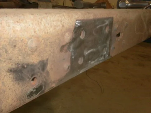

The frame is in great shape - still has the original paint in places.

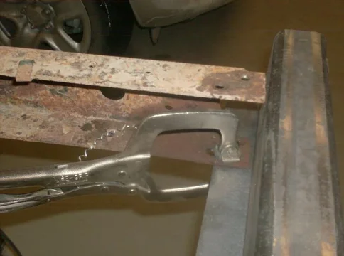

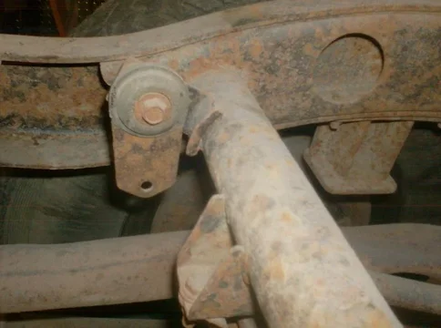

I got out quite a few tools - decided to grind off the rivet heads and drill 90% of the diameter of the rivet and then use a small punch to hammer it out. I am being careful to preserve the member because someone may be interested in it for their truck.
Got all the center ones out - are there usually rivets in the center 4 holes? mine were all out and those holes are 1/2" instead of 3/8" like the others.
And the ends - top and bottom.
And she's off...
I laid out the center rivet hole pattern on the tube. I will be bolting through these holes. There will be another plate inside the tube with tapped holes in it.

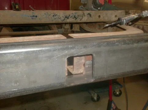

To add strength I will be running the receiver sleeve through the 2x4 tube. To cut the hole without a torch I drilled 4 holes and will use a good jigsaw to finish. It is offset to the bottom of the 2x4 tube to clear the rear valence of the box.
One side done.
Two sides done
I will weld flat bars to be bolted to the angled channels
And fab a channel 10" or 12" long to fit inside the frame rail then bolt through the top and bottom flanges.
In total, there will be 16 bolts holding her on. The only thing I don't like is when the frame is out for plating and powder there will be no crossmember holding everything firm. I'll have to make a temporary jig to hold it all together.

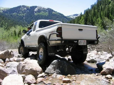

Could you guys help me out here? I plan on using some round tube to come off the rear crossmember I've made above. I'm gonna make it like two "bumper-ettes" that come back, out to the corners and turn forward toward the rear axle then back in to the frame for a slider effect on the tail end. I want to dress it up a little and need some ideas. I searched the ih8mud home page for ideas in the bumper/slider and roll cage galleries - searched for rear bumper threads - searched the internet etc. etc. I'd like to see any and all rear tube bumpers and exo-skeleton treatments of the rear corner on any type of rig. I want protection but not ugly protection - the back of the bed is just 16 ga. sheet metal hanging down and the departure angle sucks as it is.
Please post pics of anything for ideas
Thanks.....
stuff like this.....
More please ..........:)
