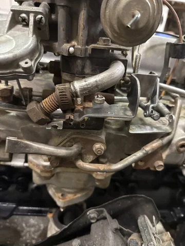

Does anyone sell a nice looking block off for the insulator EGR tube? Or what have other people done.
Mine came with some radiator hose and a giant bolt with a clamp around it and it just doesn’t look like it belongs on a landcruiser.
