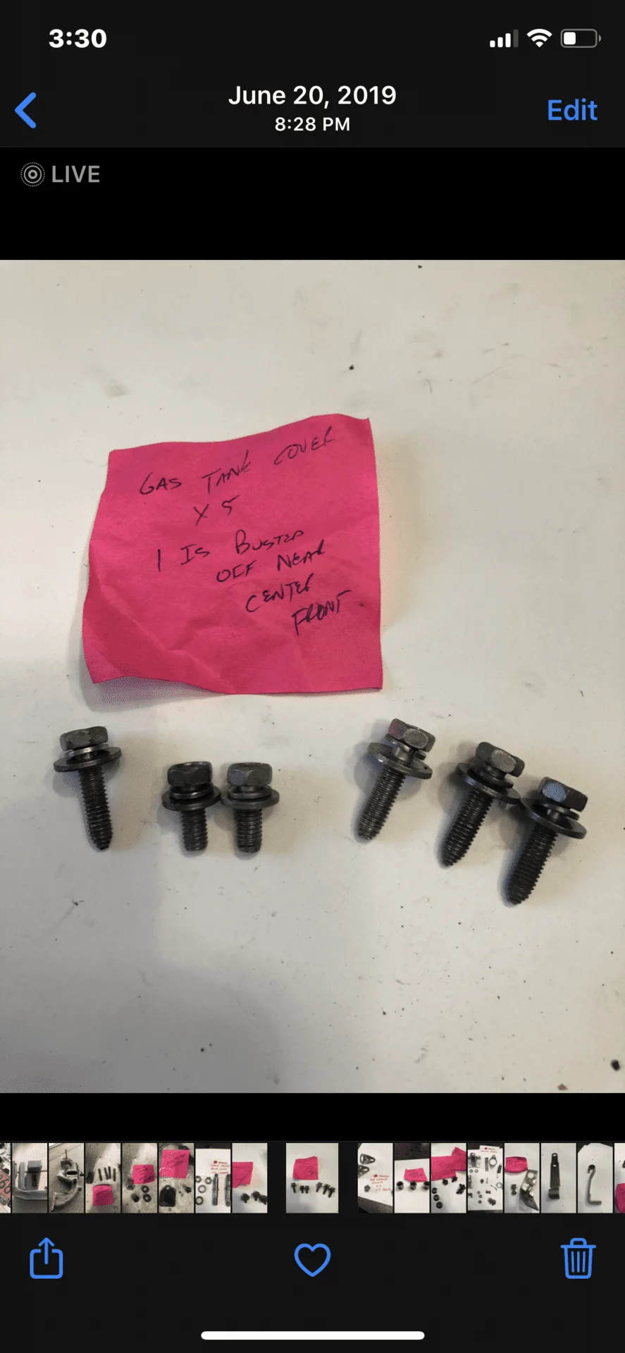

Here is a photo of the ones that were on my 78. I’ll see if I can locate them in my garage after I got them back from plating

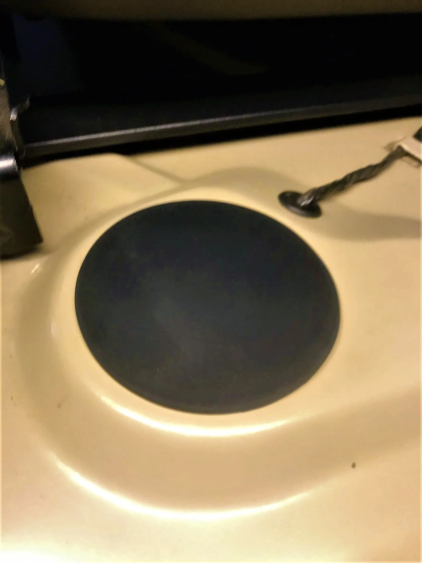

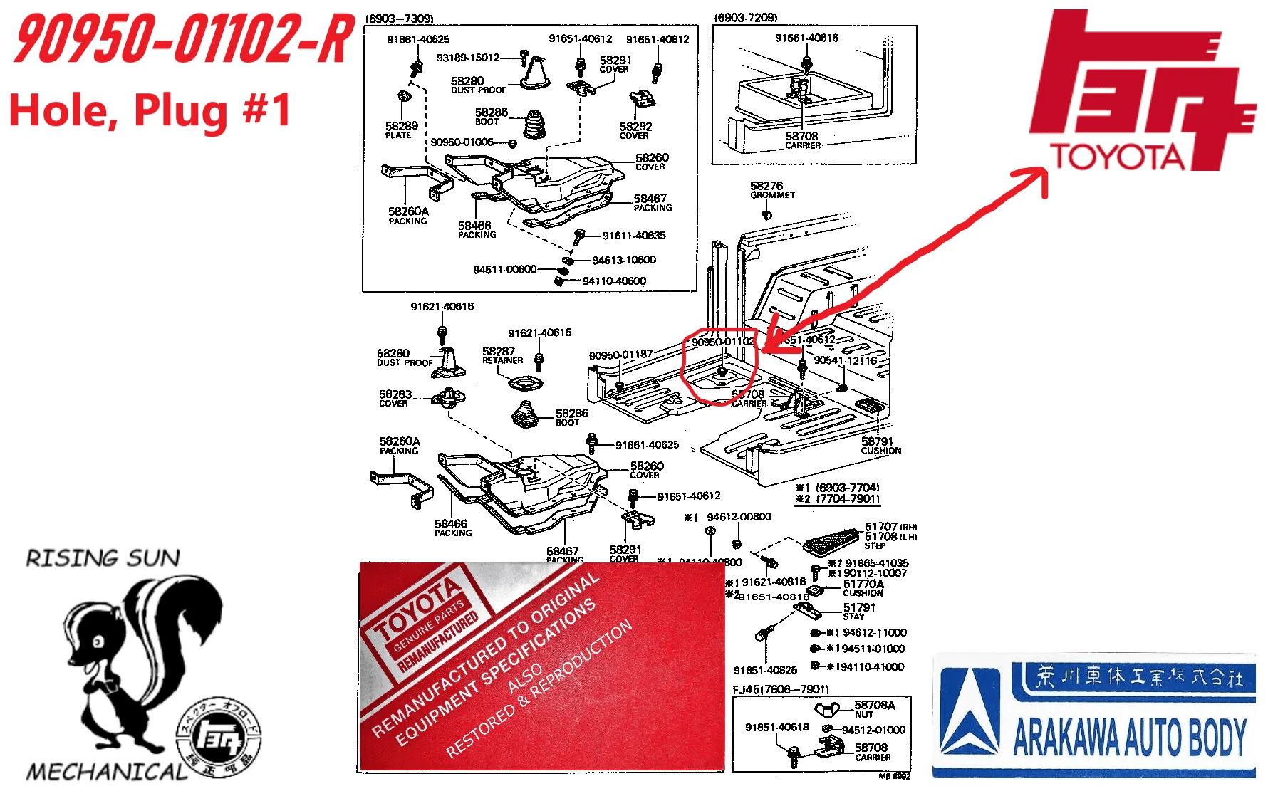

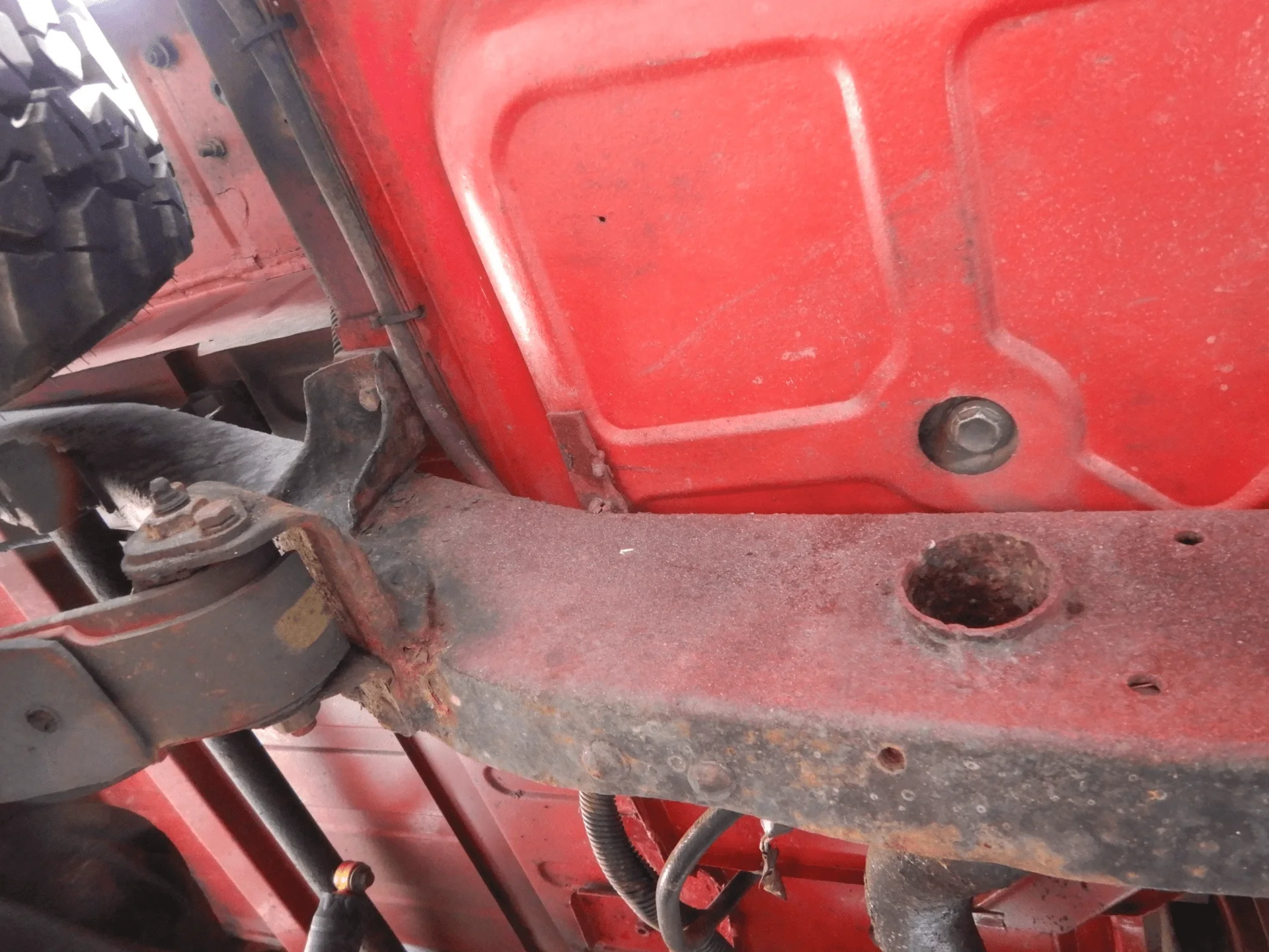

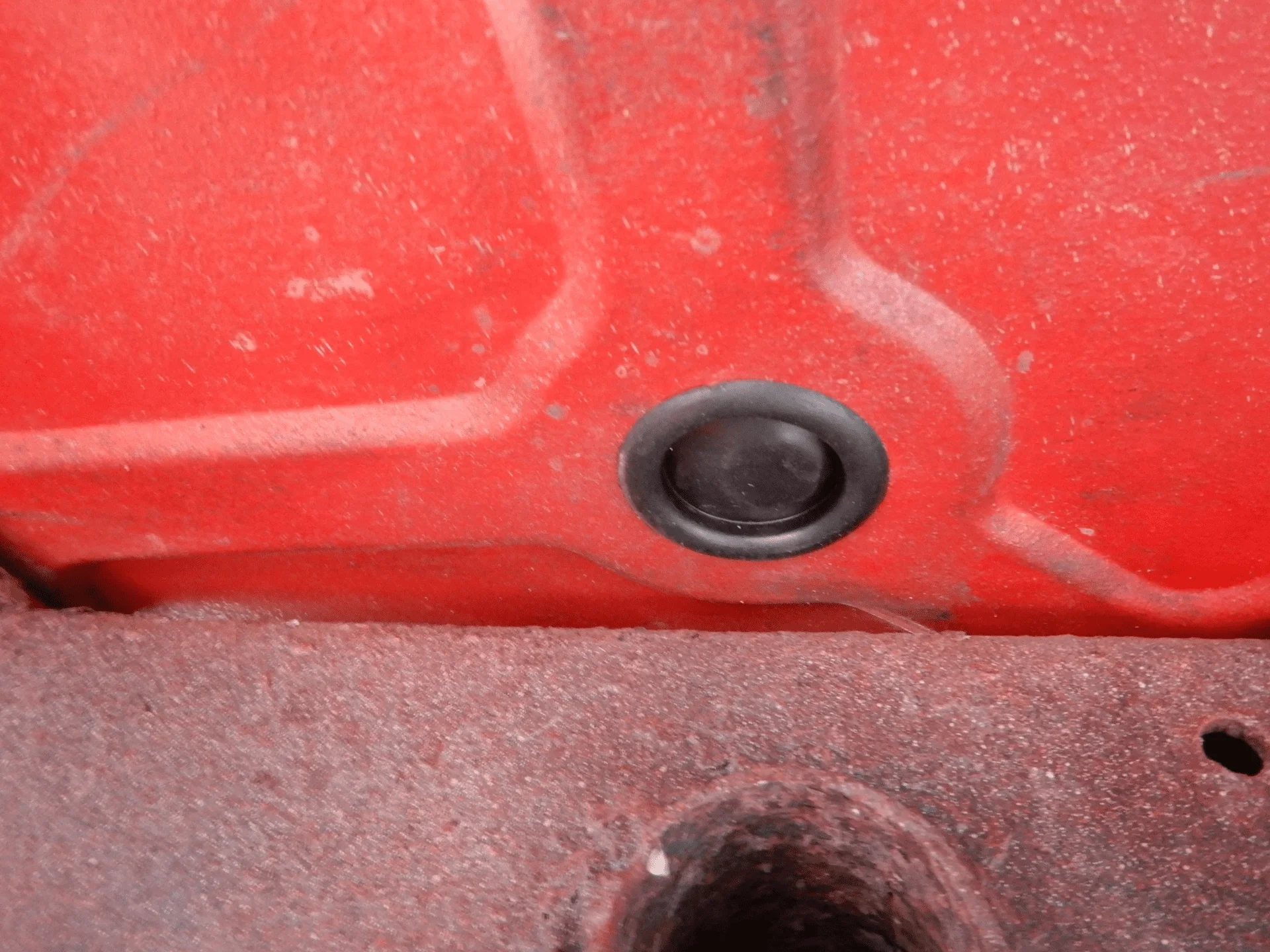

is your Sending Unit access hole Grommet / plug present ?
and
Under body gas tank drain service plug sealed by the proper Grommet's ?
keeps mice out and cold , water mud too ........
91611-40620, still available from Toyota. Captive split washers and larger OD flat washers. 6mm X 1.0 pitch, 20mm long under the head.
