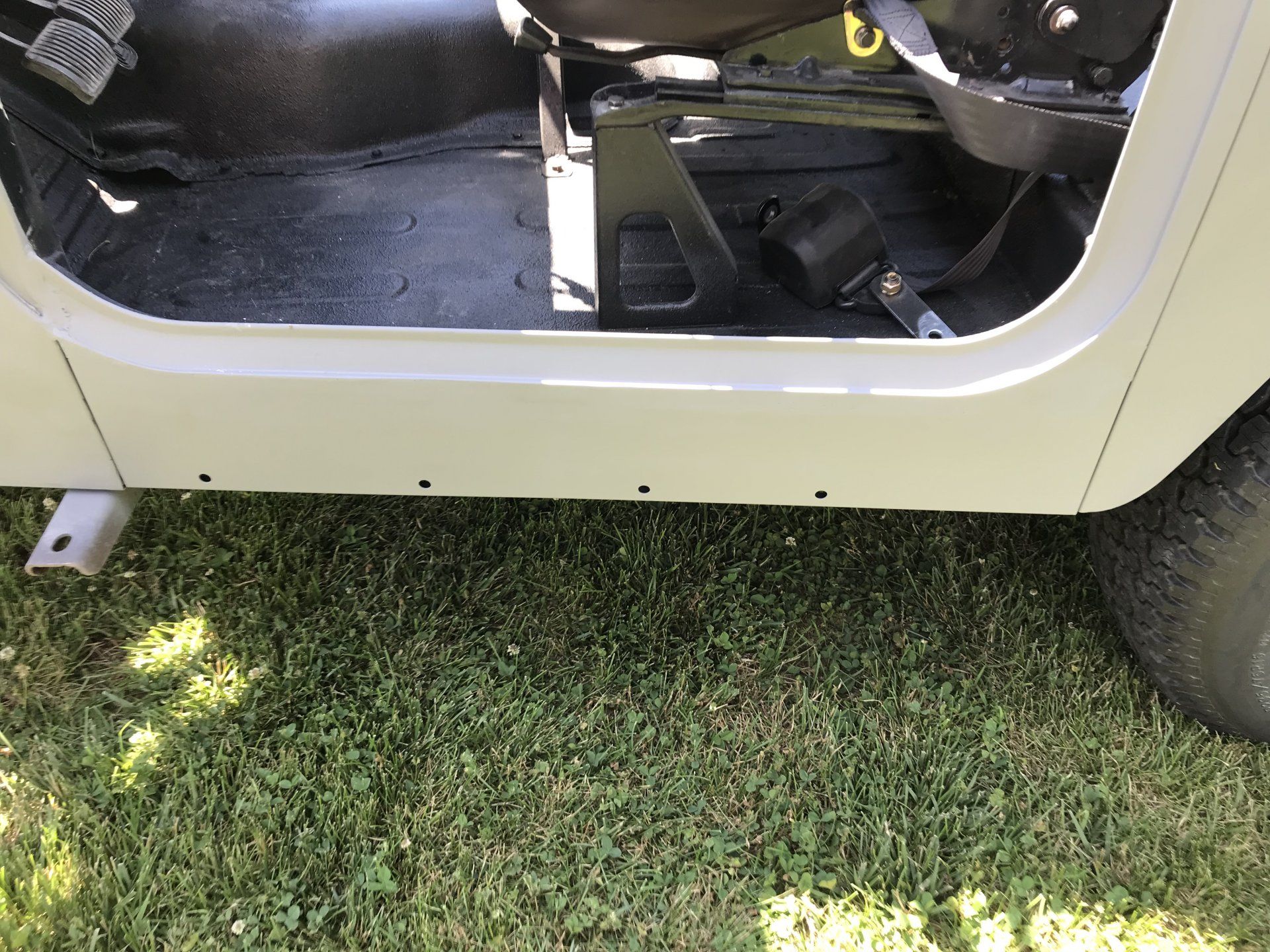

Updates on actual work getting done! After deciding our plan of attack, we went after the rocker panels. There was NO metal left on the drivers side so we ended up having to take the replacement panel and add another strip of metal so we can weld it in. Passenger side had just enough for us to weld to. Which leads to an exciting update... the passenger side is all welded in! I know there are still many hours of body work ahead, but to just get everything spot welded in is an awesome feeling. In other news, our "Days since Landcruiser related injury" had to get reset to 0 after today. My dad set himself on fire while welding! Attached picture shows the aftermath.

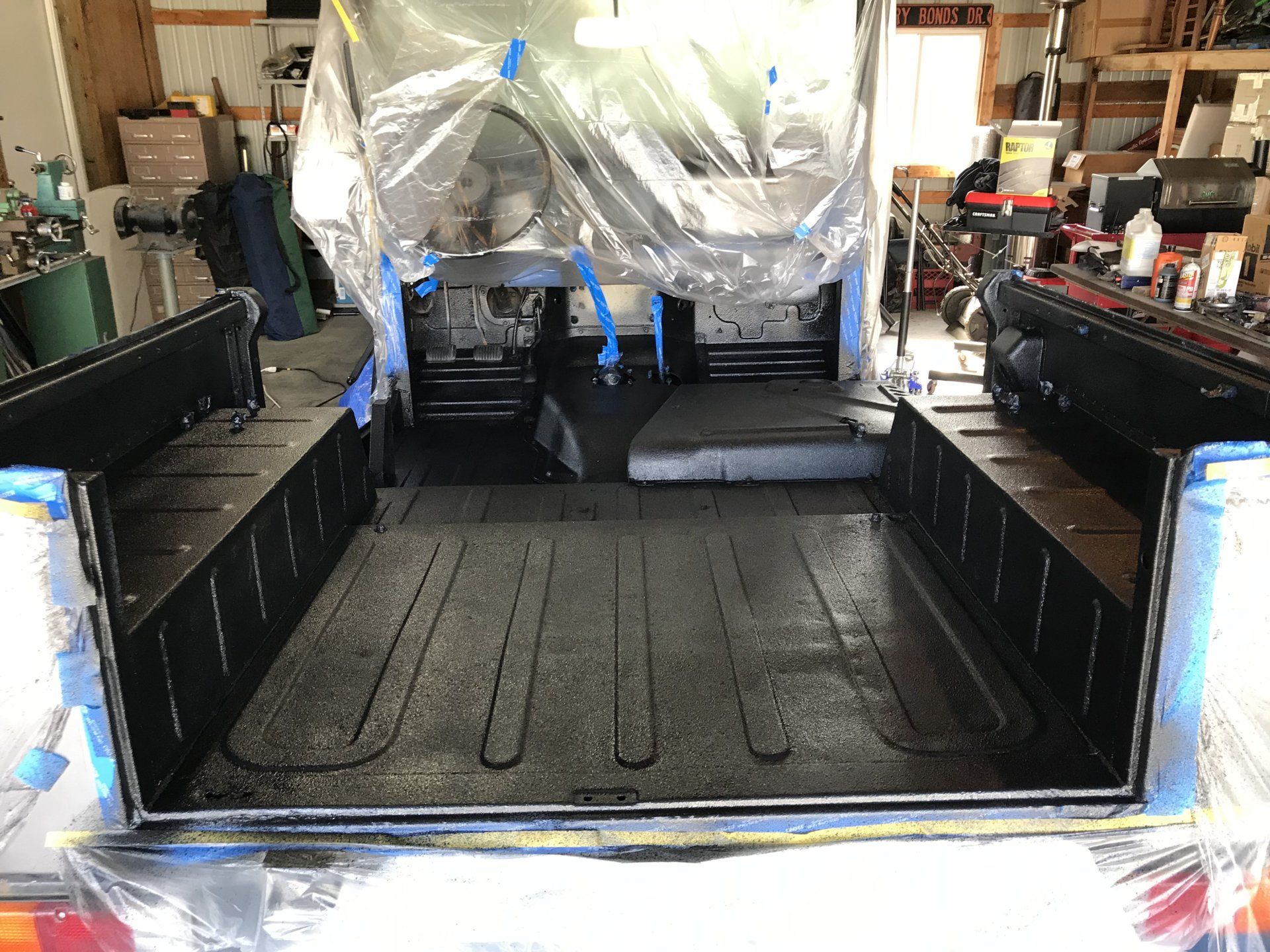

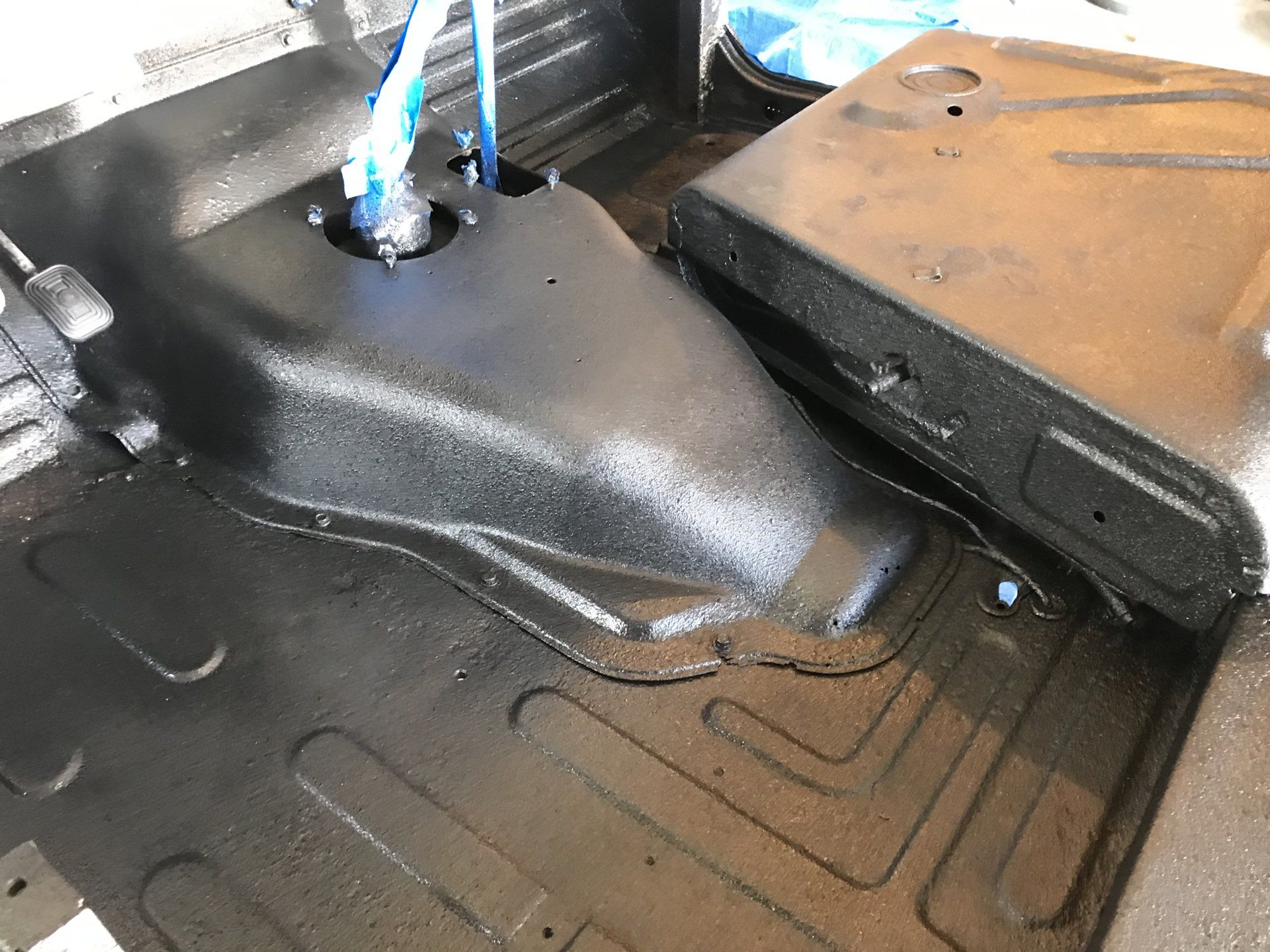

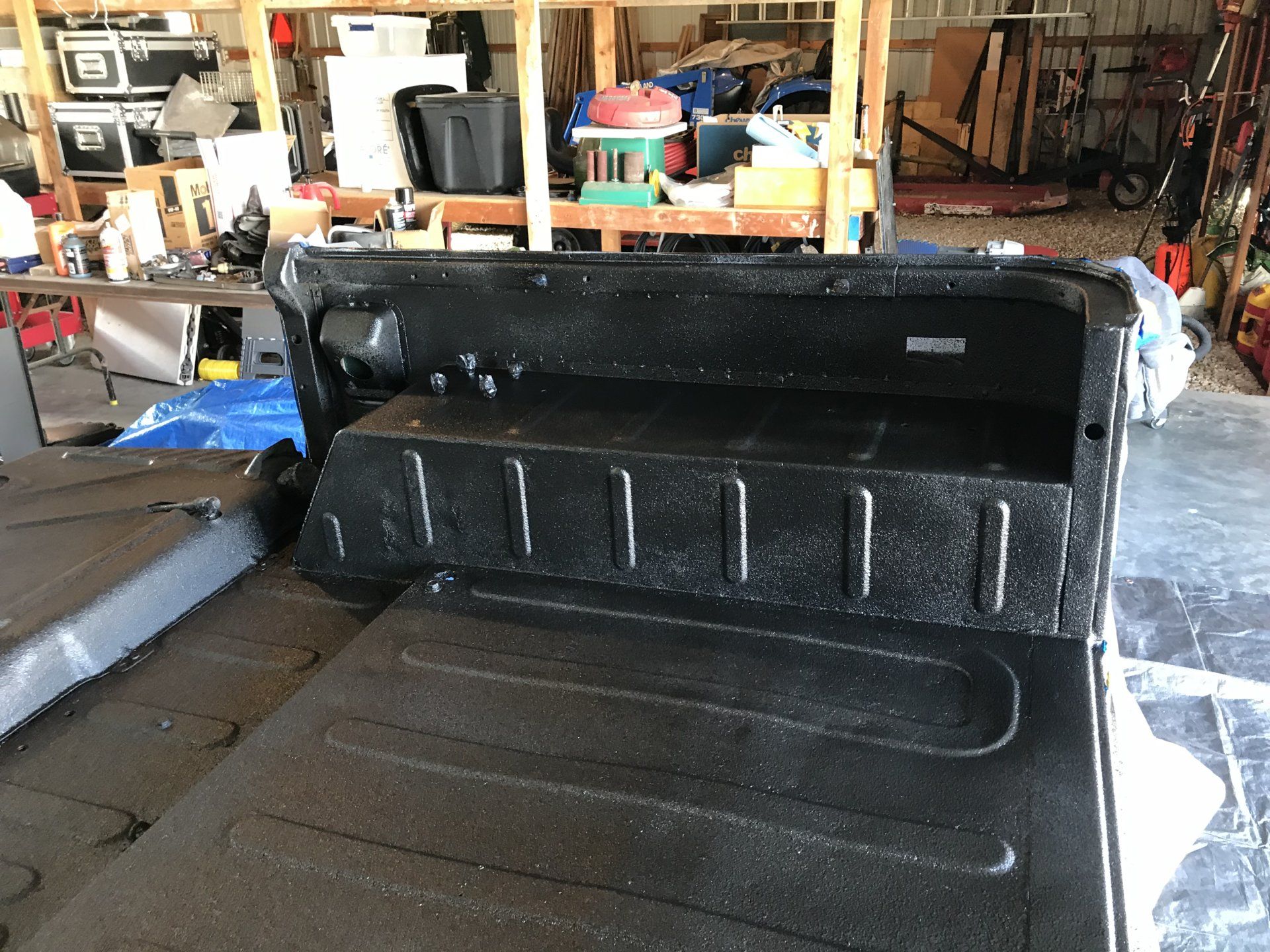

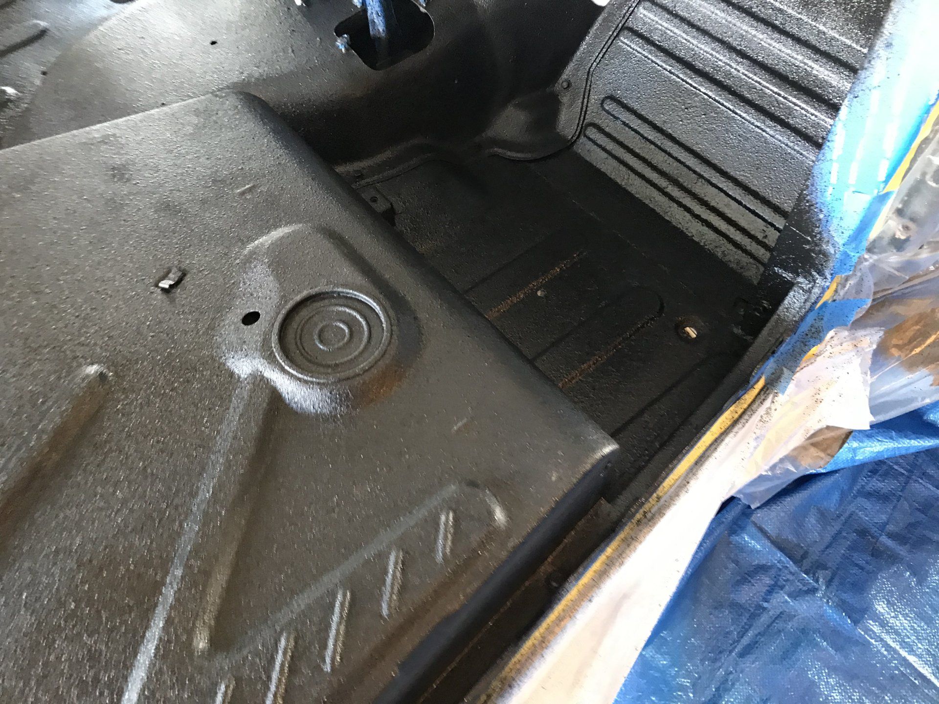

So, in what would have been an exciting day, we got all the prep work done to spray in the raptor liner. Then after the 3 hour prep, we open the first liter of raptorliner and it is a off white color. Interesting. Is the color on the bottom and it turns black when you shake it? Does the hardener change it to black?
Nope. Neither of those. I accidentally bought the 'Un-Tinted' variety of Raptorliner when I ordered it. Appearantly it can be tinted using 2k paint or packets that Raptorliner will sell you for $25 a liter. No thanks. So I went ahead and reorder the BLACK 4 liter set off Amazon and it should be sometime before May 10th.
Also in related news, Amazon will not let you return things like Raptorliner,so there is that. I guess I will keep it around since it is tintable and find a use for it? Who knows.
So fast forward a couple days and the raptor liner (black) came in and we were able to spray. I highly recommend raptor liner if you are looking to do this to your truck. It is a little on the expensive side, but it really did go on easy and I think that the finished (not 100% cured yet) product looks great.
View attachment 2283580View attachment 2283581View attachment 2283582View attachment 2283584View attachment 2283585

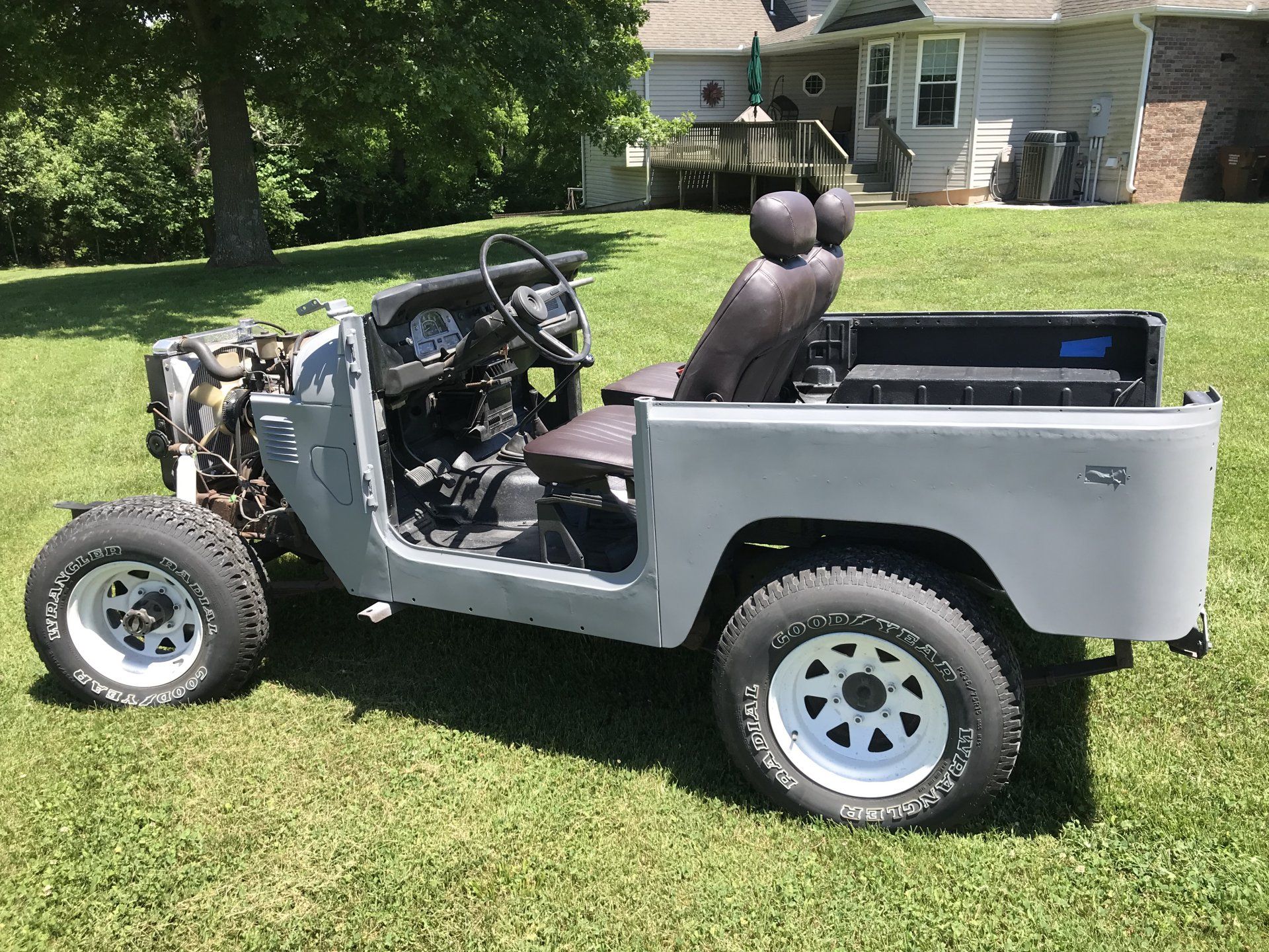

I have heard a bunch of negative things about the replacement fenders, but they went on pretty much bolt on. There is a little bit of separation between the fender and the apron, but we have also spent next to no time attempting to fit. I am thinking we can get it pretty snug. Anyways, think the powder coating on the fenders and sidesteps have a nice contrast to the primer actually!
