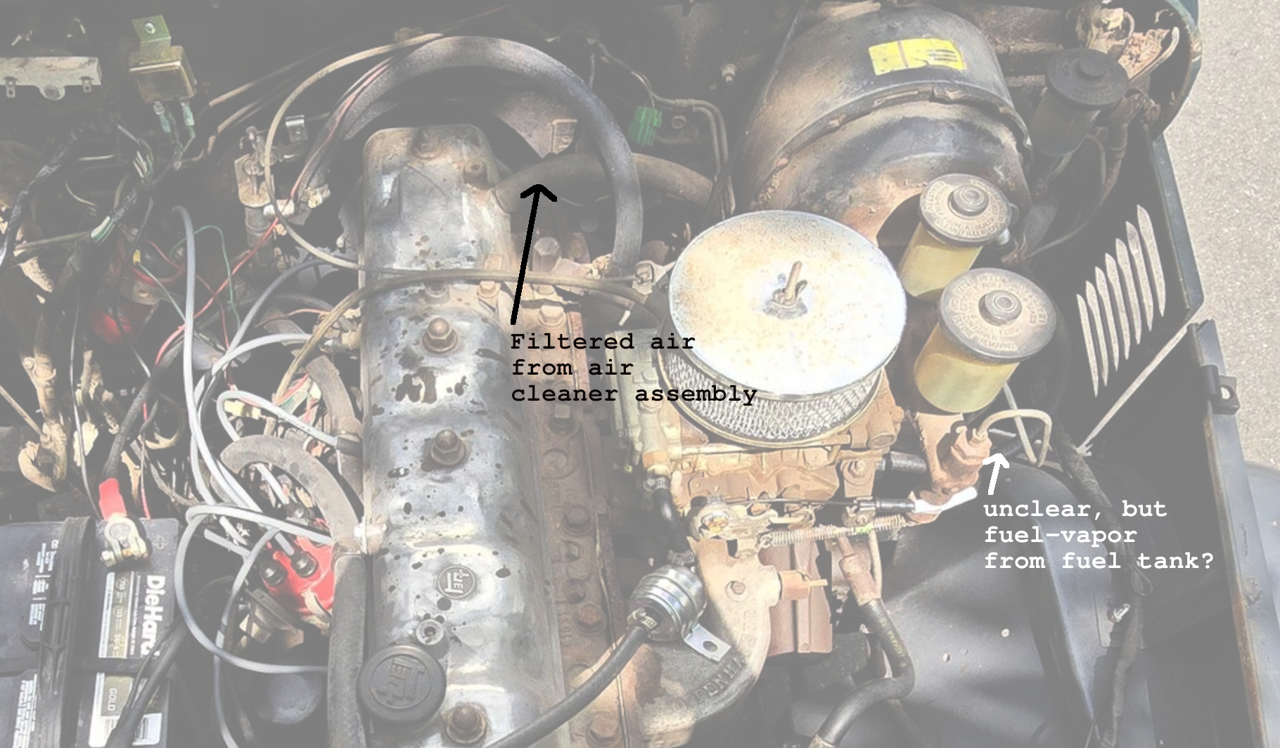

I've been studying this for the past several weeks and I'm hoping you guys can get me clear on the OEM hose routing on my 1976 (which we've discovered has a 1977 2F). I'm finally to a point where I can start cleaning up the engine bay and attempt to restore to OEM. Some reference photos (ignore the fuel line/fuel filter nonsense):

I should have mentioned, a lot of engines simply have a filter on the valve cover. However, it is my understanding that sometimes the PCV system works backwards, like when you are pulling quite a bit of air thru the intake at the air cleaner assembly, at wide-open-throttle, and the engine is experiencing significant blow-by. My Weber, on a minitruck, has a fitting on the bottom of the plate that holds on to the air filter, is there a hole under the air cleaner bottom plate?
The SOR drawing suggest that the upper, oil cooler pipe was fitted to the top of the valve cover, I think. I can't tell what is going on behind your lower radiator hose.
