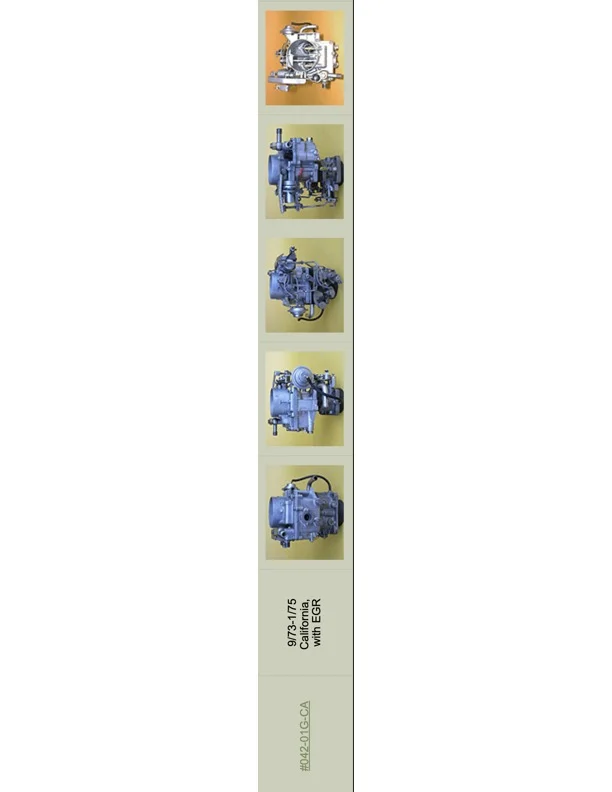

I have identified the carb as a "9/73-1/75, California, with EGR" from SOR.
Thanks in advance!

The emptying float bowl might just be old gaskets at the drain bolts, new gaskets come in a rebuild kit.
