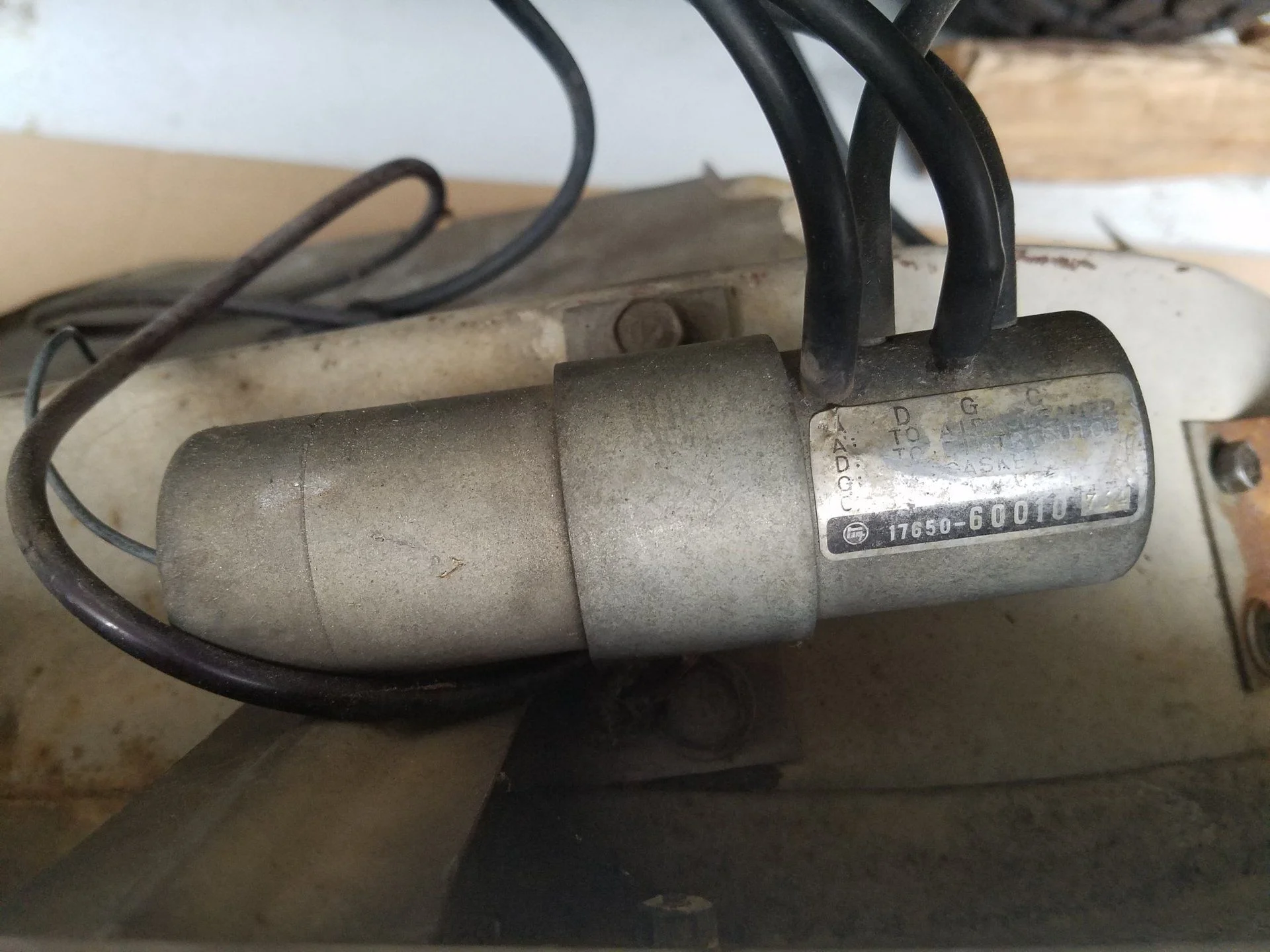

my 12/68 has this on the DS fender. Also a controller up under the dash

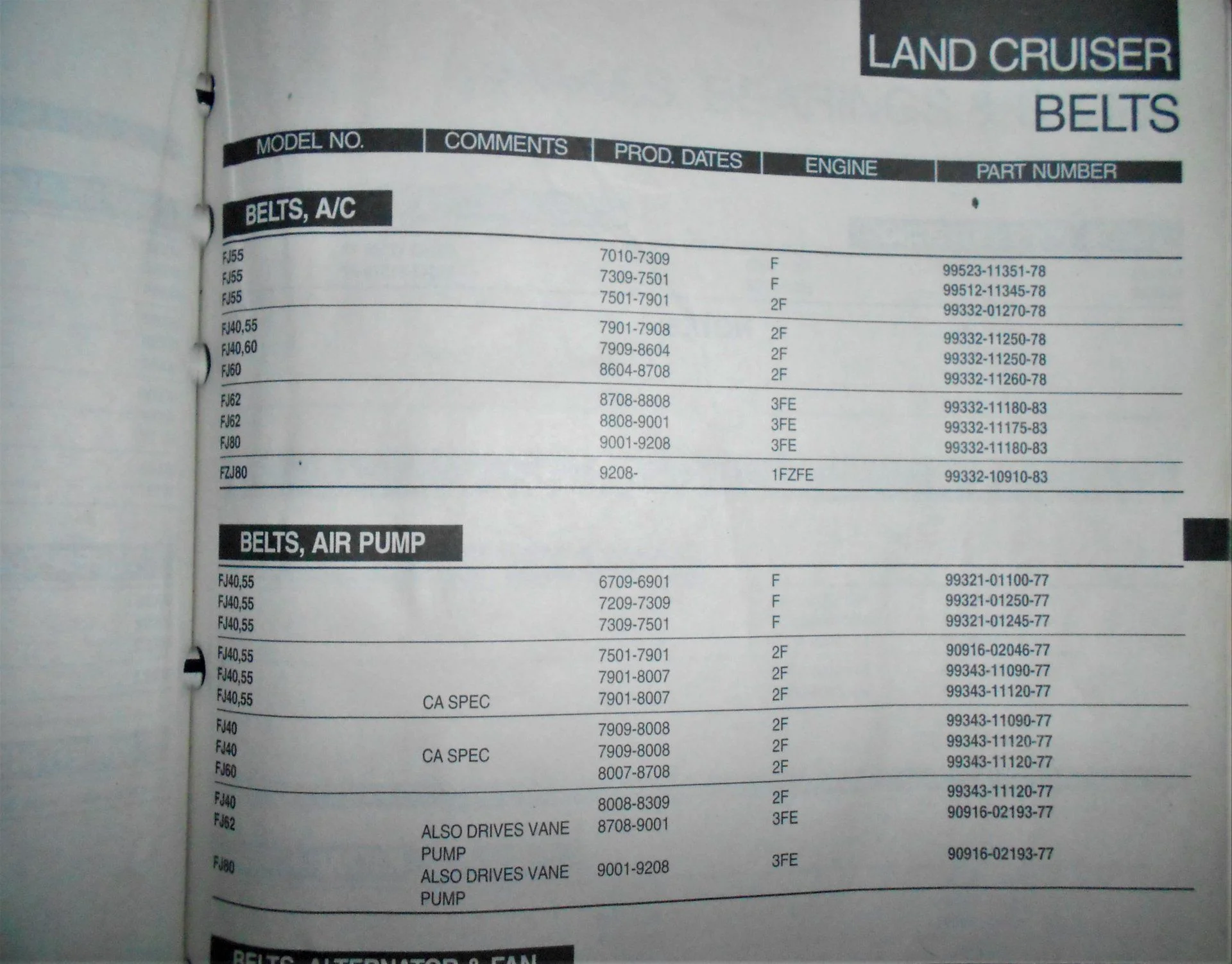

@lcwizard had a 68 FJ55 with a air pump. My 9/67 FJ40 did not have any sign of a air pump when I bought it in 74. It is a 68 model with the changes for 68. Curious if the previous page you posted show a listing for just a belt. I do not believe the air pump was on all Land Cruisers in the US market from 9/69 on. When I use to take my 68 thru emissions they never looked for a air pump.
My "69" 5/68 build date, also had no sign of a air pump or any other kind of smog equipment.
JP
Take Note of My Book Above , The Land Cruiser F Engine's Air Pump Belt's Application / Introduction 6709-6901 , then
NO Air Pump Belt Again Till 7209-Later ,
So I interpret That as Between 6902-7208 A USA Spec FJ40 & FJ55 Did Not have / come with Air Pumps :poof::poof::poof::poof:
Is This a possible Explanation ? o_O

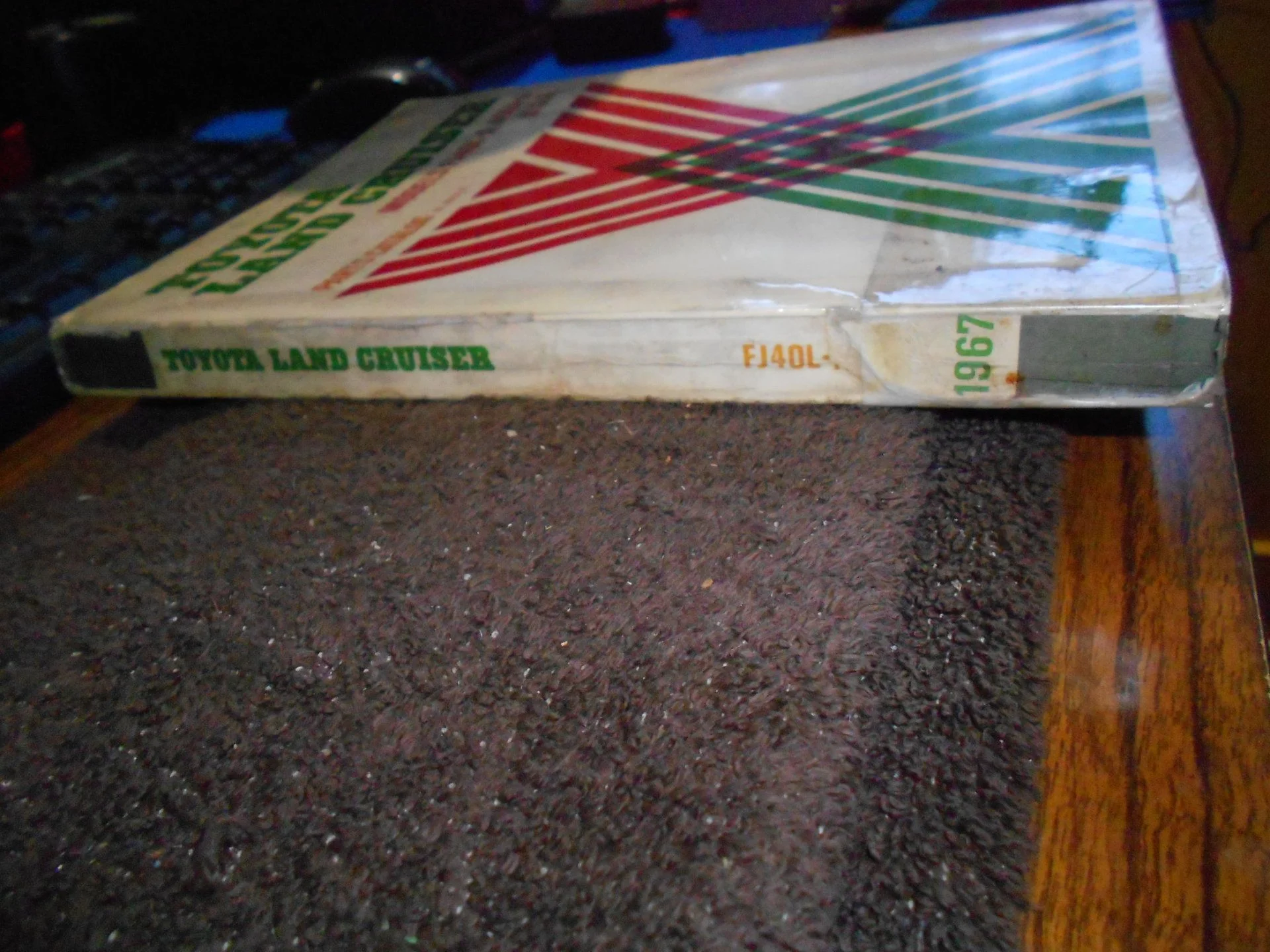

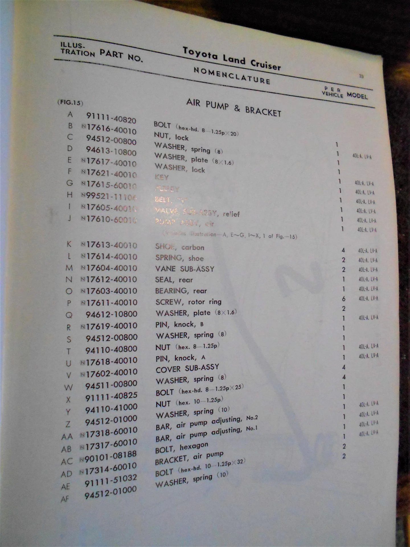

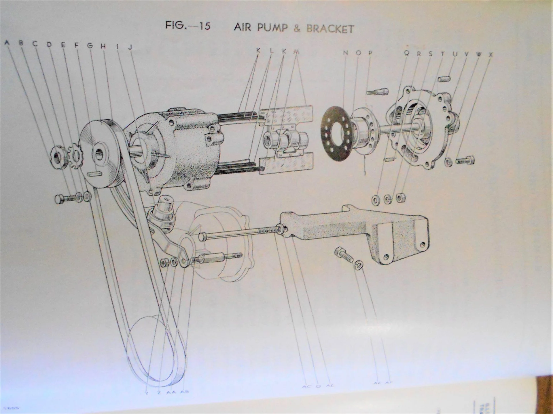

- This is a USA Spec. 1967 Model Year Dealership paper parts cataloger BooK ( Publication #93658-67 ) for FJ40L-A & FJ40LV-A
( This is Not A repair / service manual )

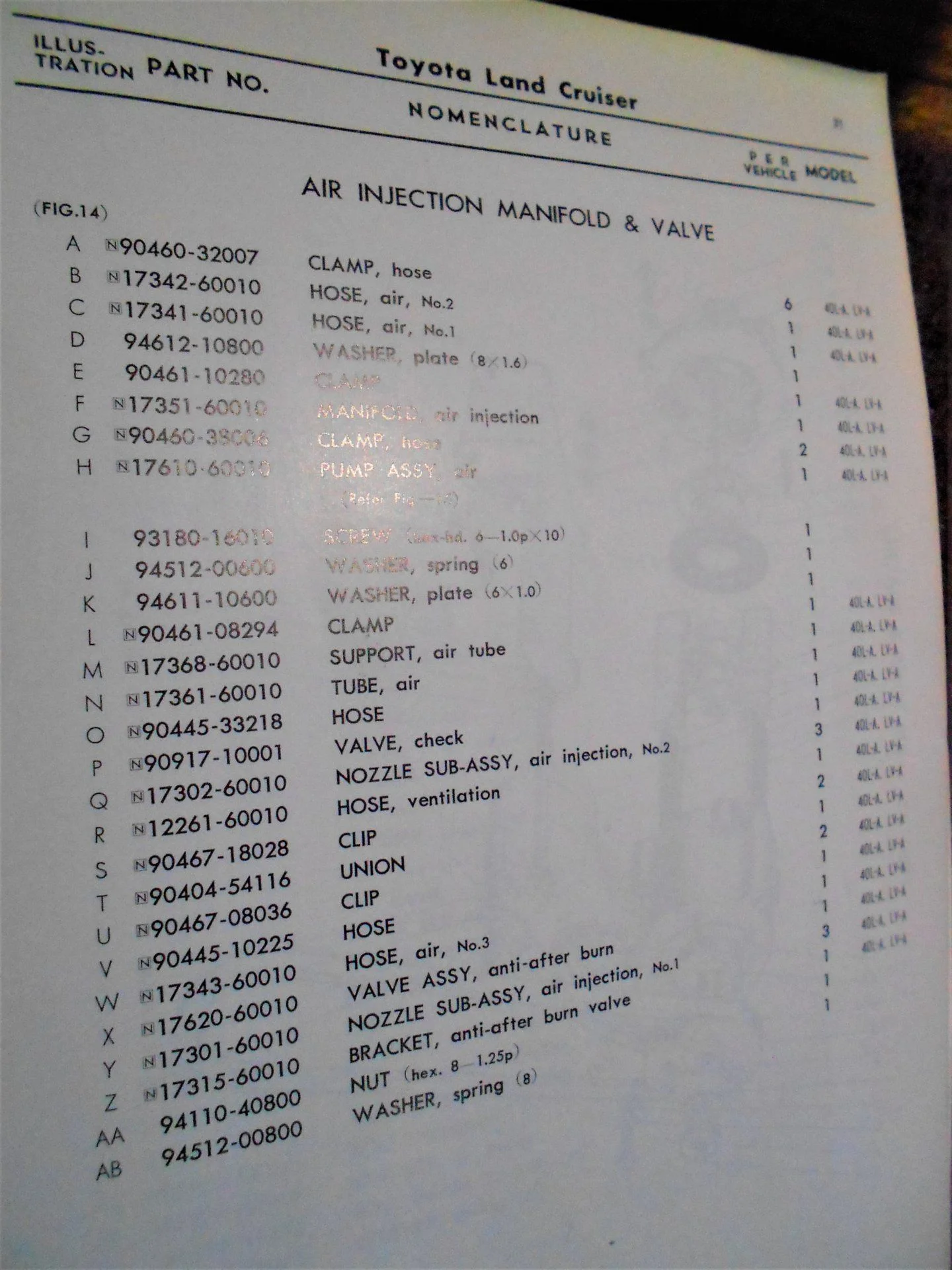

Interesting your diagram shows a hose connecting to the air cleaner. I have not seen the second fitting on a one barrel paper element air cleaner. The over fitting is for the positive crankcase ventilation system. It provided filtered air for what was being drawn out of the crankcase thru the PCV valve then into the intake manifold.
Take Note of SST #'s A & H
(note: this is out of the same 1967 Parts Cataloger as above )
Does The Presence of 2 Service ports on top of this 1967 Air cleaner Box shed any light ?
( Note : there is only 1 kind / option of air kleaner box in the 1967 parts cataloger )
Take Note part # F (hose)
is that the 2nd hose U refer to ?
my 12/68 has this on the DS fender. Also a controller up under the dashView attachment 1638777
My 3/1969 also has this Vacuum Switching Valve and NO air pump at all. And I know it never had one from purchase. Perhaps Toyota really did not need them with a VSV and transistorized drive of it. ? Then in 1972 emissions may have gotten tighter as they do ? Just a guess.
