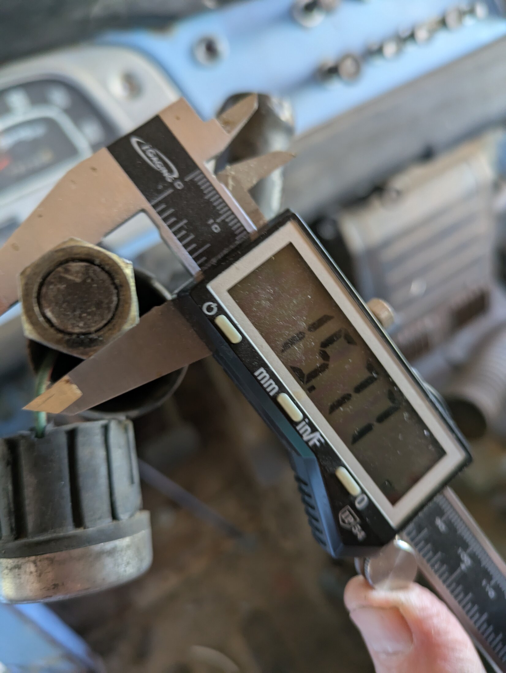

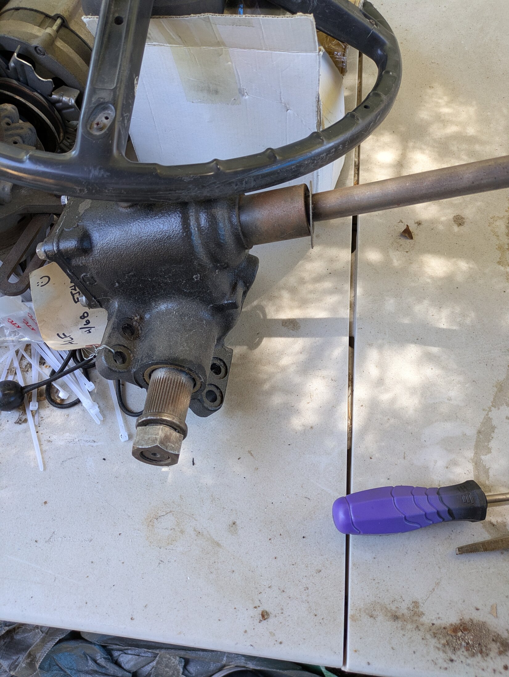

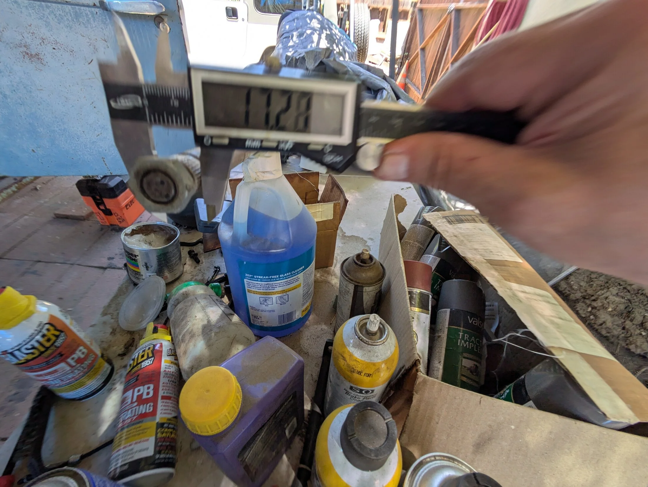

I got a rebuilt Steering Box from a MUD Vendor some years ago and am now just getting around to putting it together...
But I found the splines on the end of the shaft for the steering wheel are larger than the one that was removed.
Are there differences in these one-piece boxes over the years?
The larger one is 17mm +
The one that fits is 15mm+

View attachment 3945260View attachment 3945255View attachment 3945256
What is the spline count? There was a change around 9/69 from 36 spline to 33 spline for the steering wheel.
edit: it was 7/69 that it went from 36 to 33.
