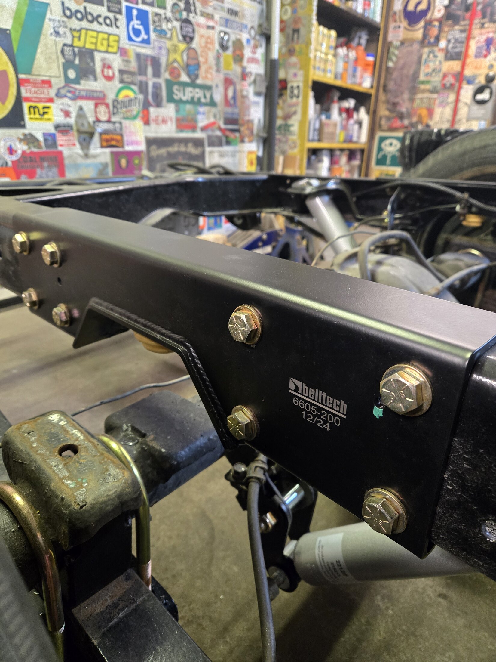

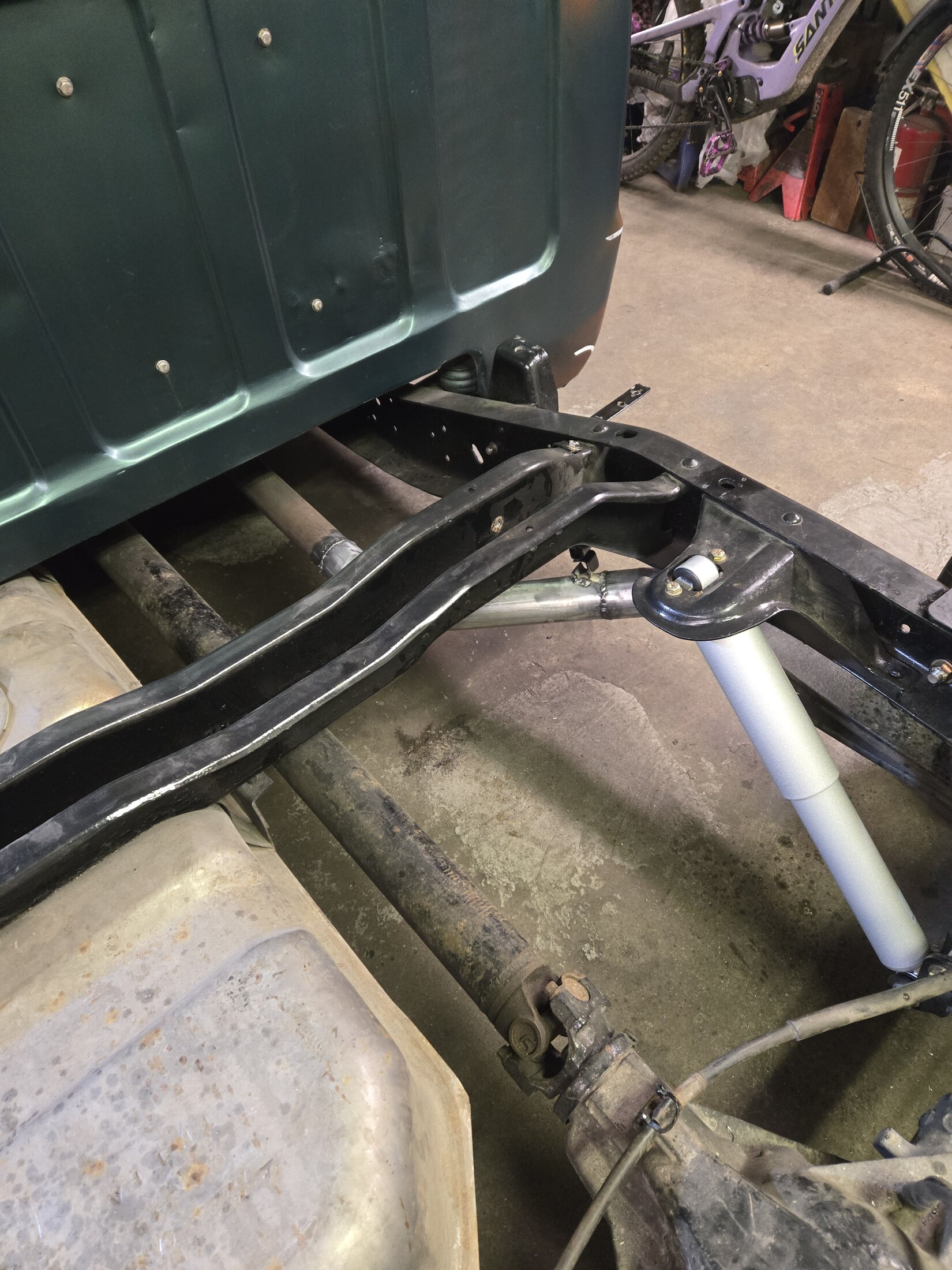

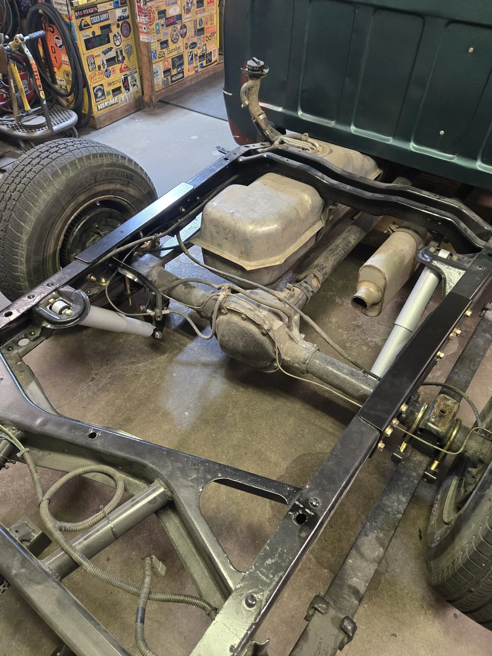

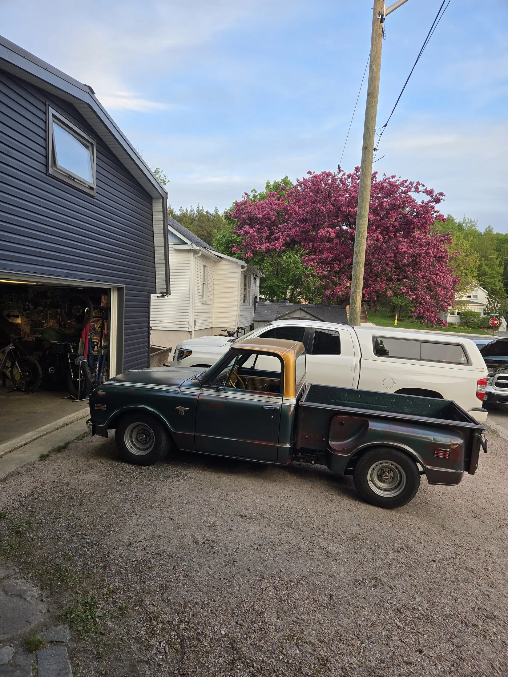

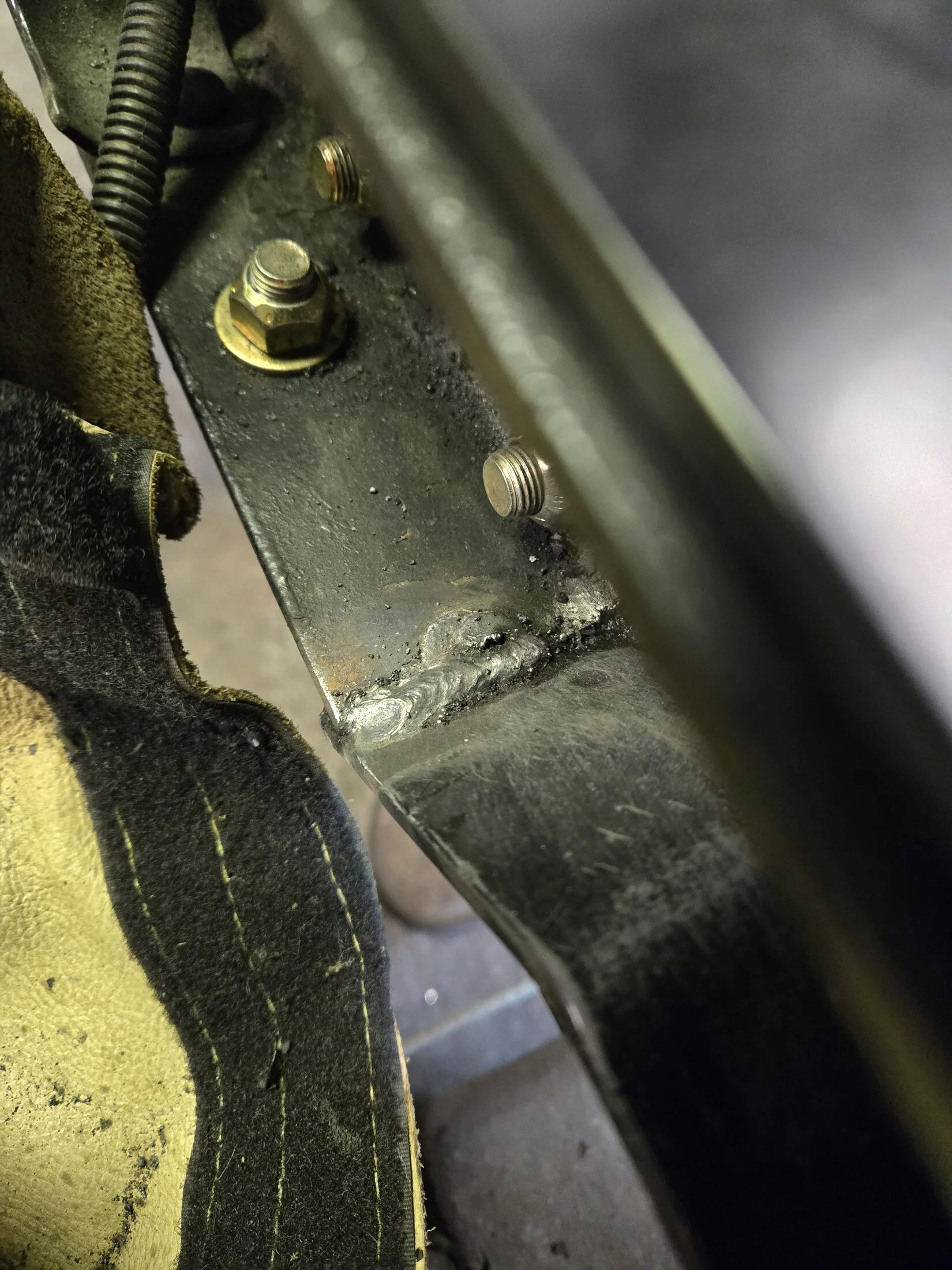

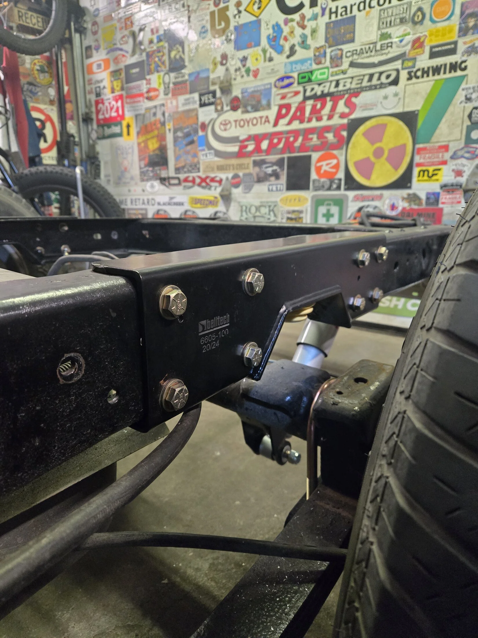

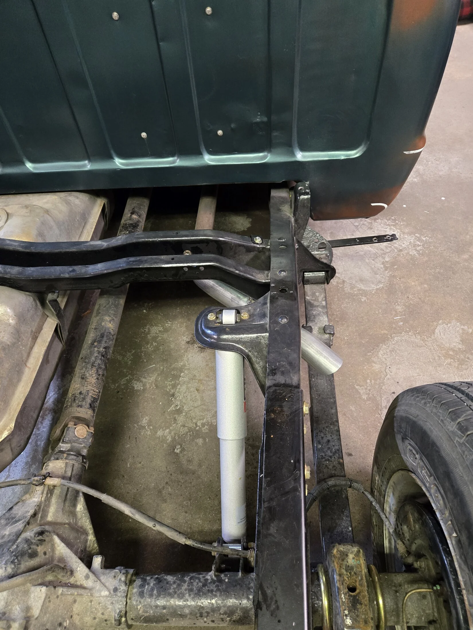

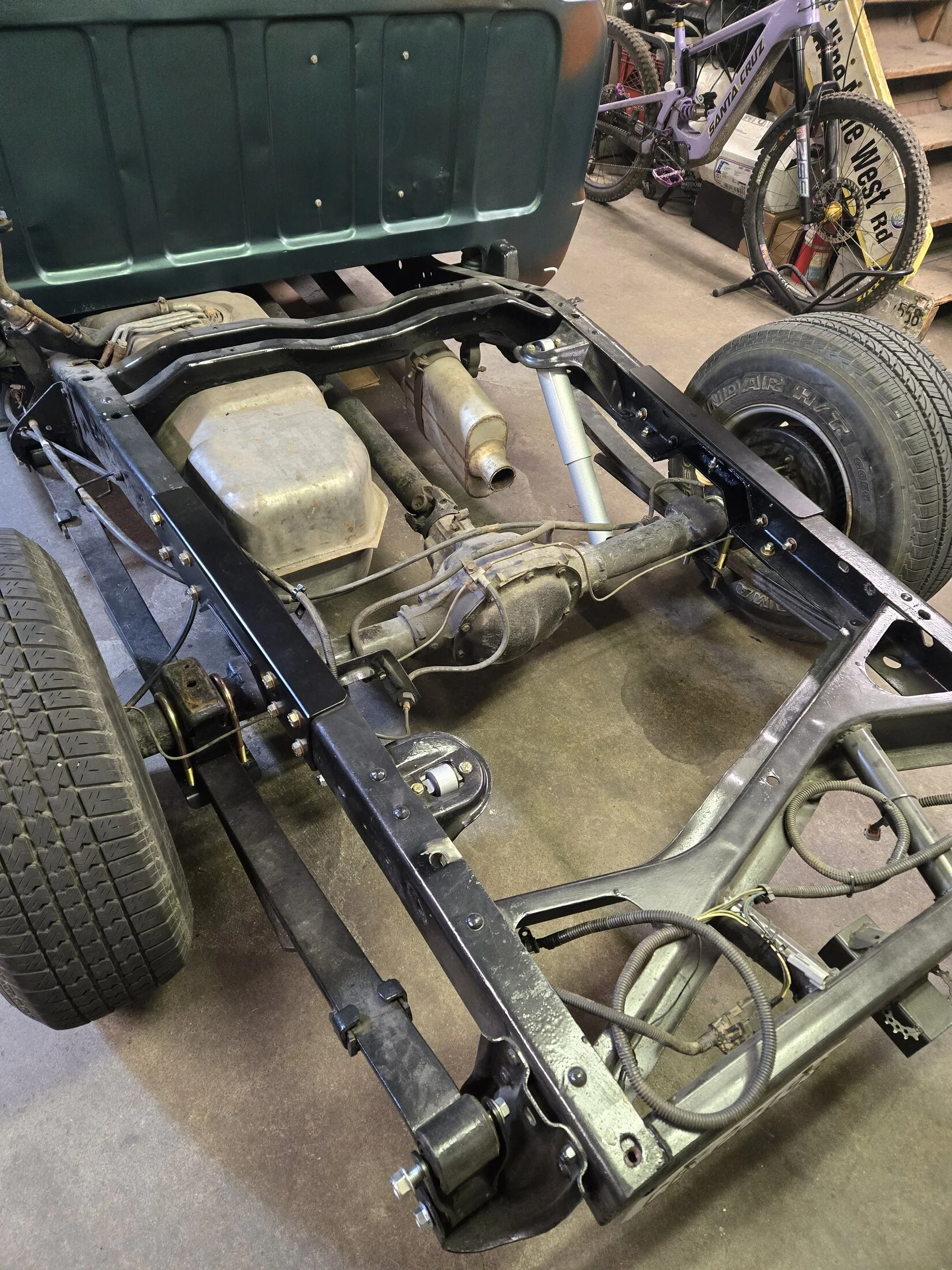

Notched, shock extended and bump stopped. I never wanna drill another hole again...
Added a couple welds for safety.
D

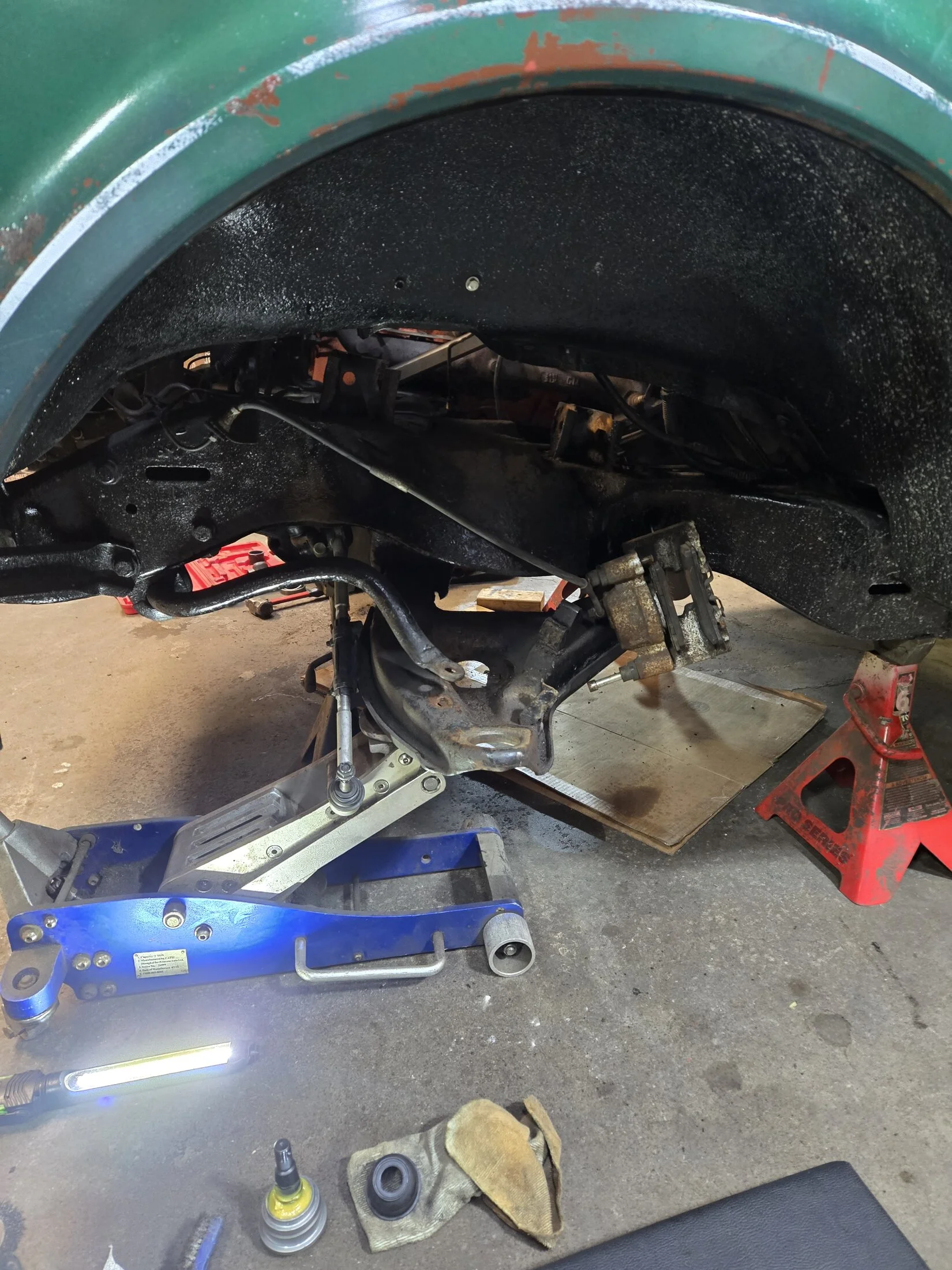

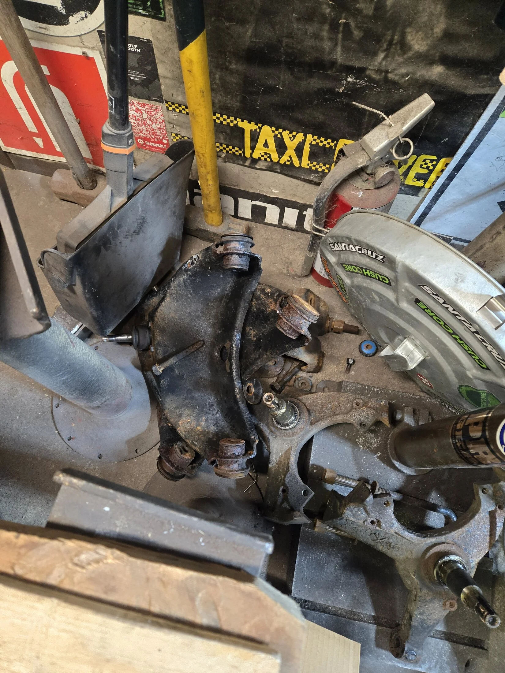

Holy crap, the upper arm bolts weren't seized to the bushings... Ps was seized to one of the cam washers and broke but that was better than having to cut it...

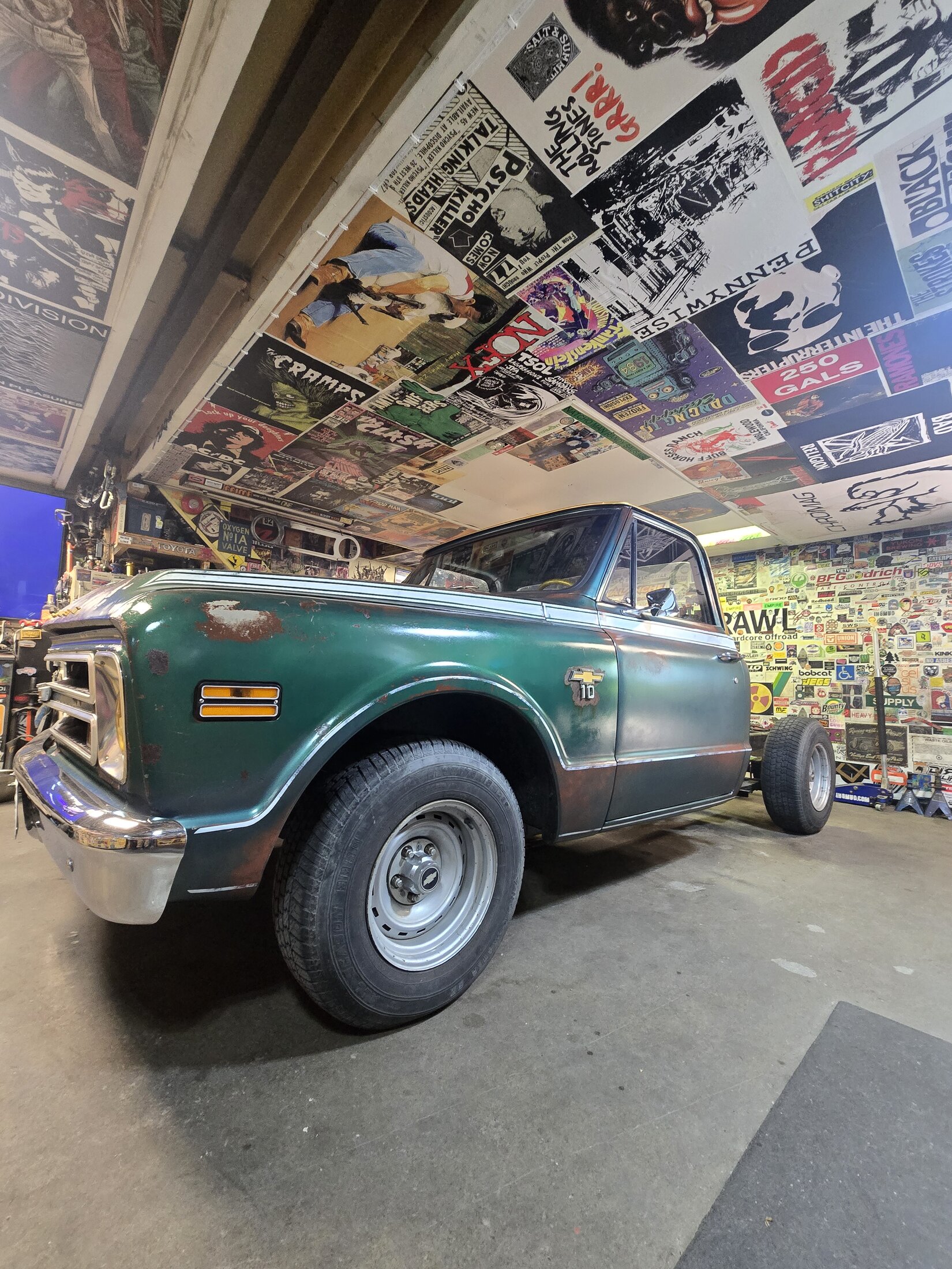

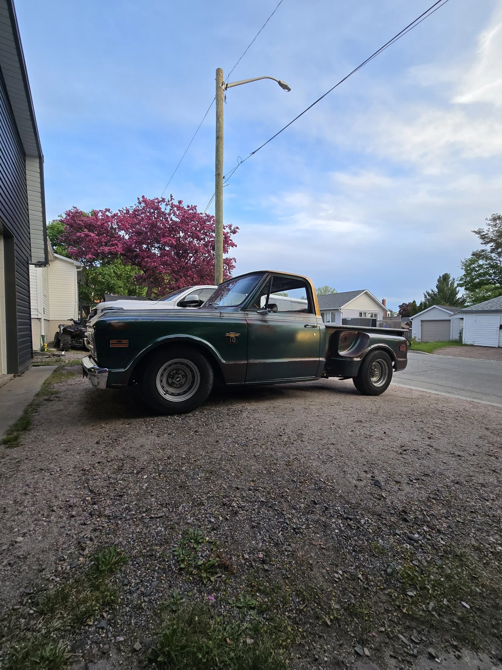

It's on the ground and sitting right!
I have to track down some cam bolts and washers for the upper arms since we stripped a washer and now I don't trust the other three lol. Broke one of the original bolts when we were taking it apart so can't use those.
Otherwise I just have to double check everything and try to get some help over to get the bed back on..

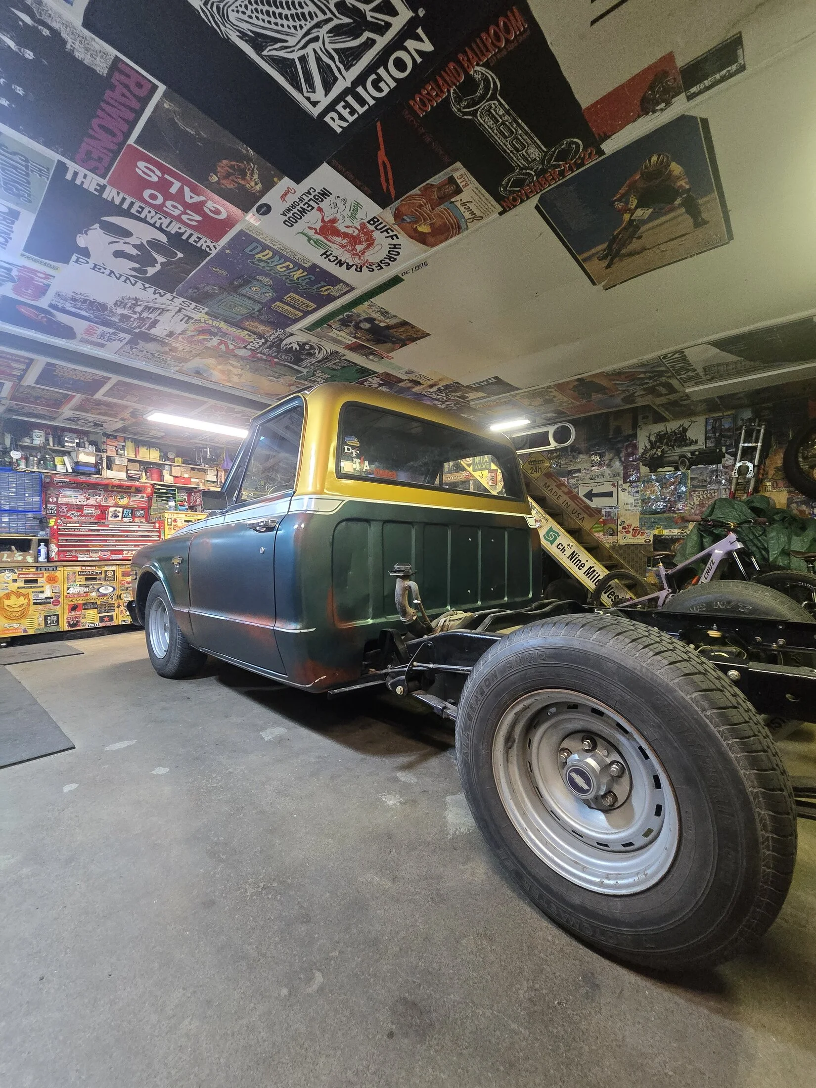

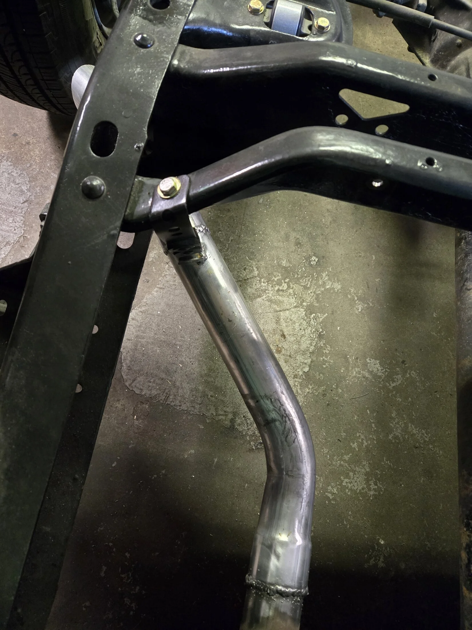

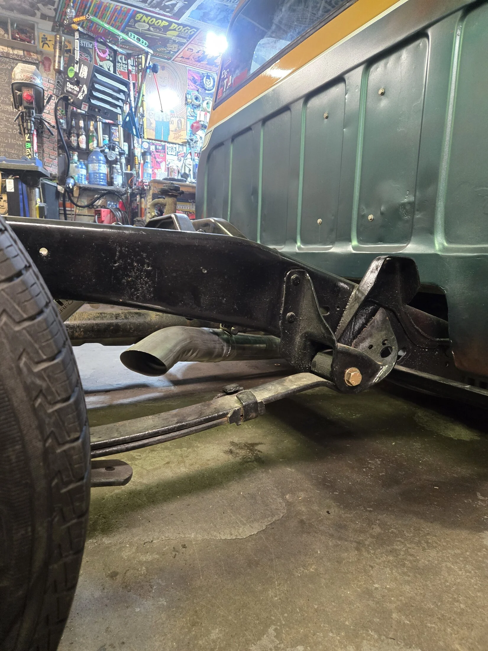

Finished off a long list of odds and ends yesterday. Torqued a million bolts, repinned the douche connector we ripped apart, then made up a quick sidepipe. I guess I also deleted the muffler... Anyways the pipe is pretty well invisible when the bed is on but sounds... better? Lol

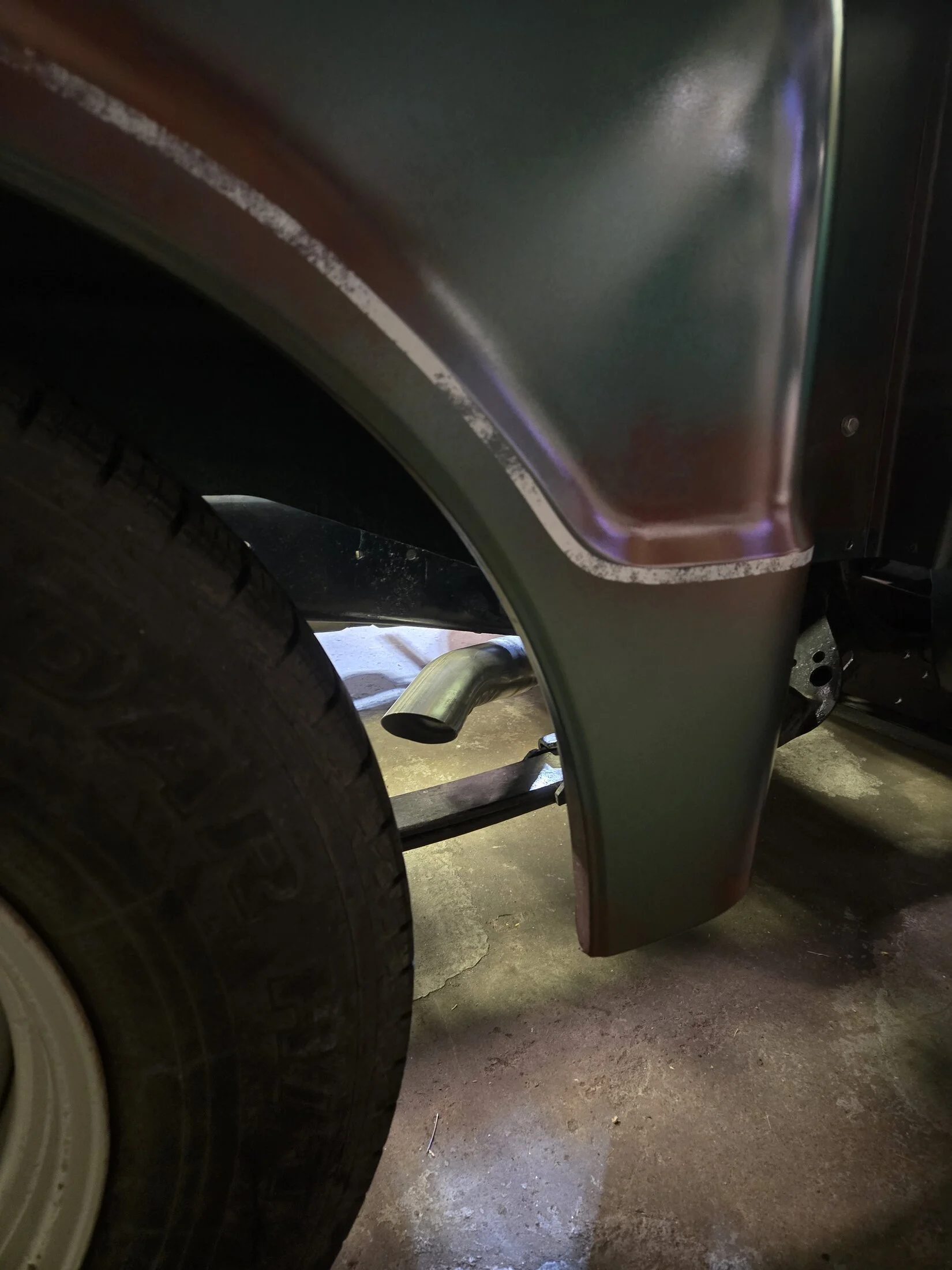

Couple buddies were nice enough to come help put the bed back on after supper and the only snag we hit is the shackle bolts being too long. A quick grind solved that and the bed was on and bolted in. I was worried the ps rear was gonna rub the fender lip after lowering but it doesn't. Probably would if I put a lot of weight in the bed so I may be borrowing my buddies fender lip rolling tool...
Still have to finish putting the bed together but im pretty pumped how it turned out.

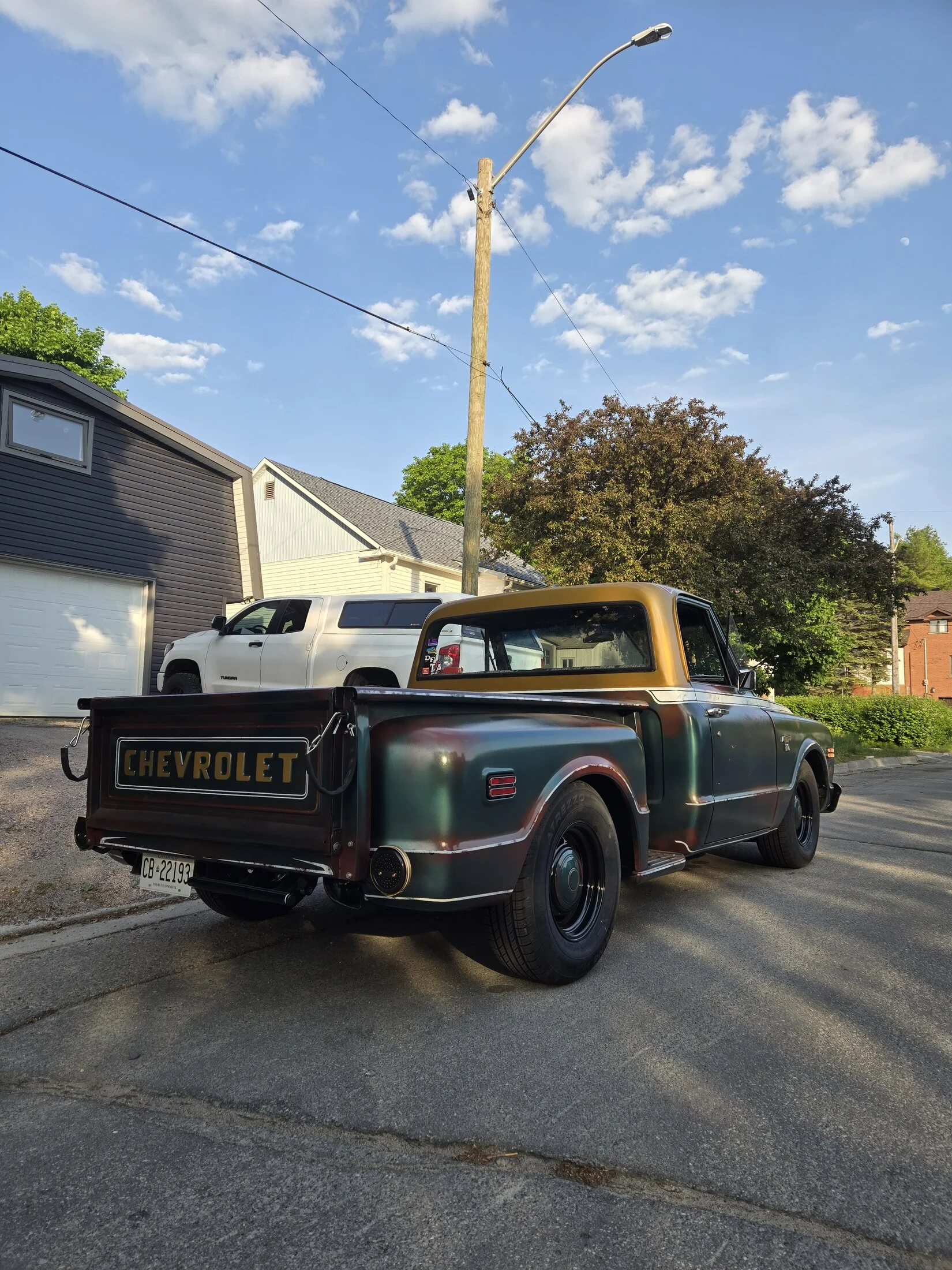

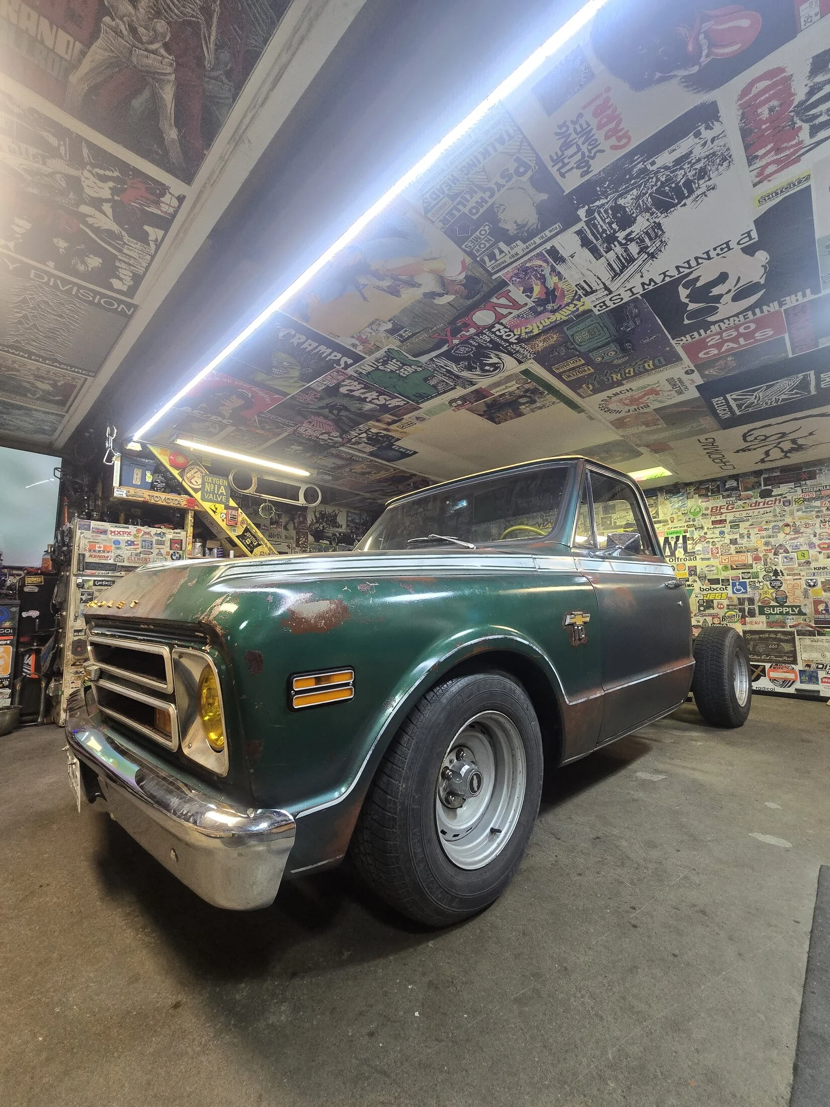

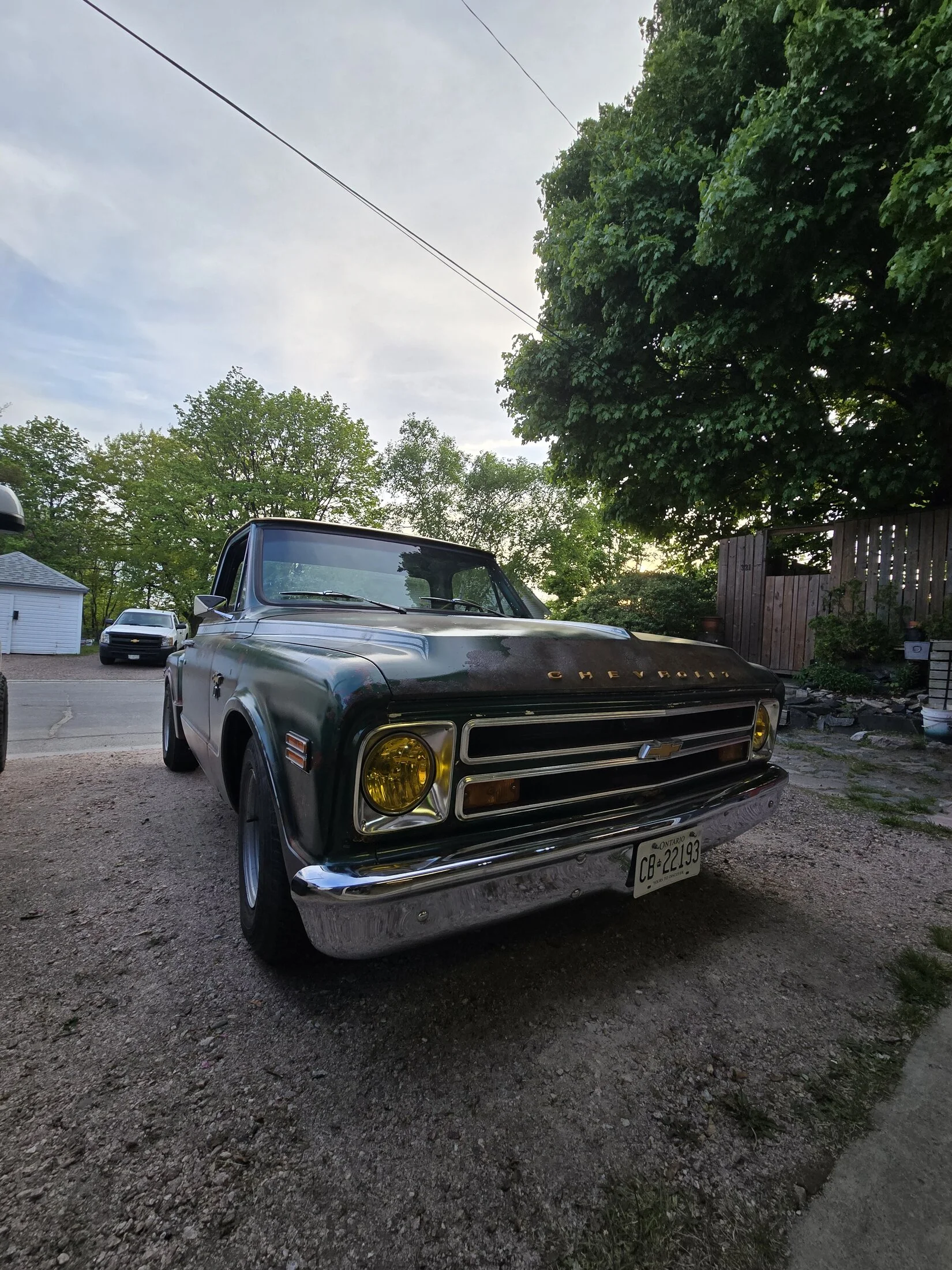

Full frontal glamor shots.
D

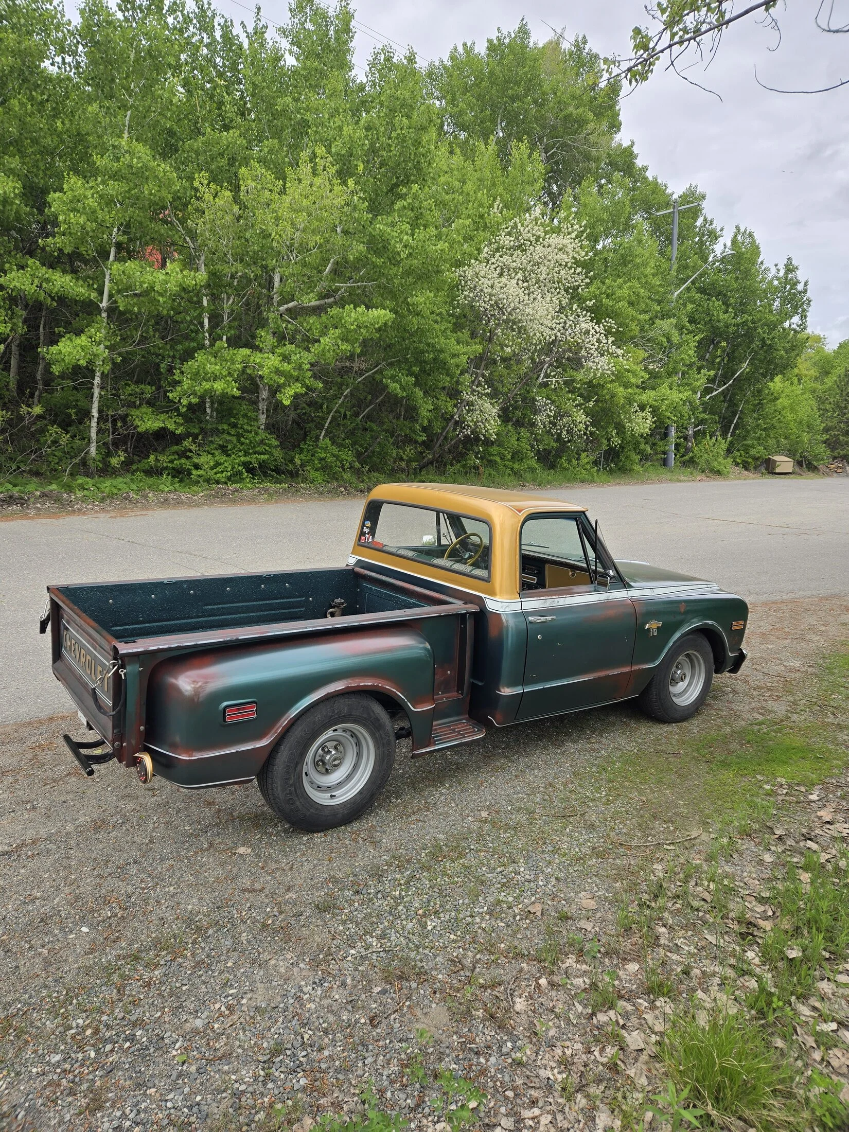

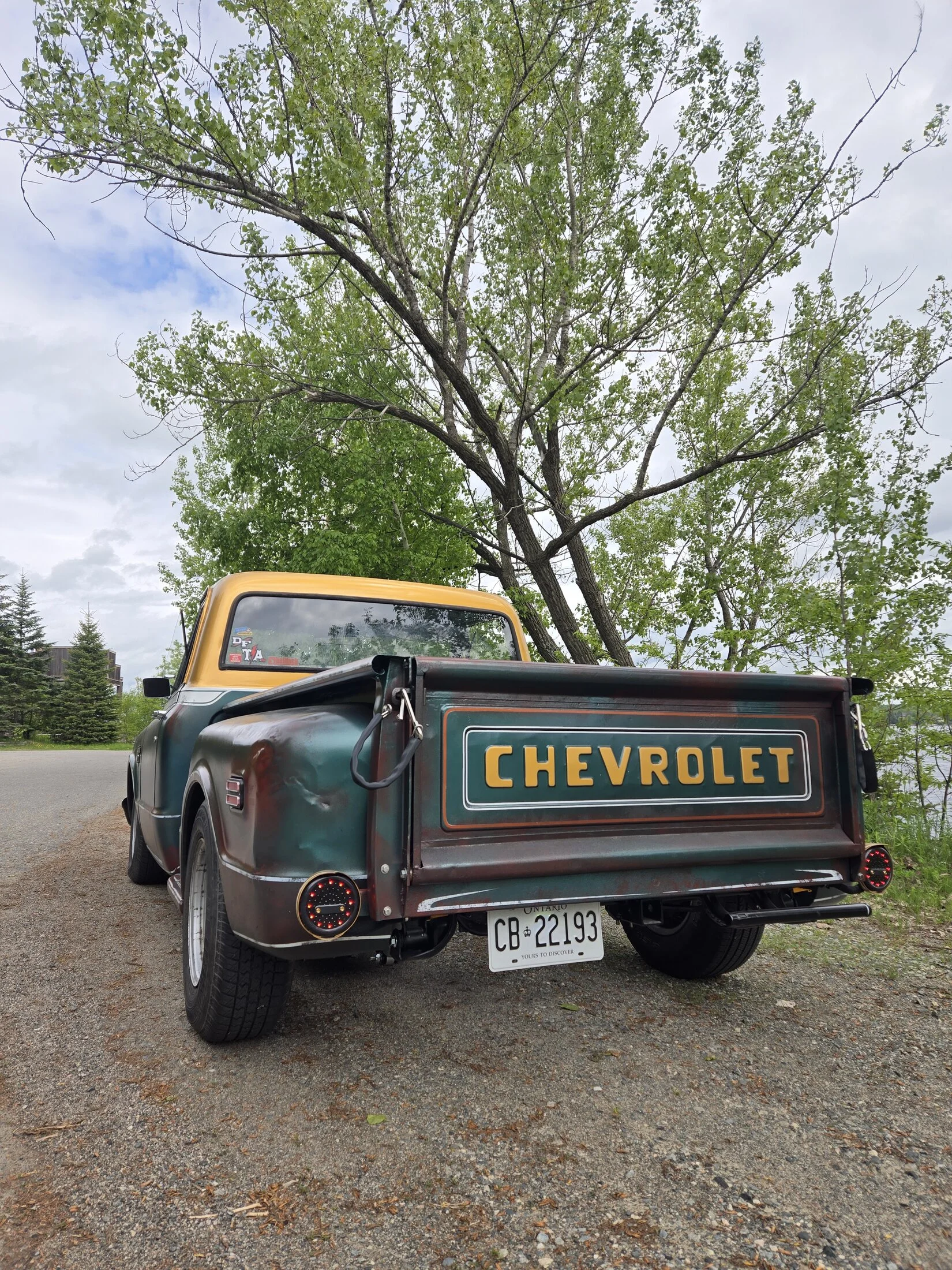

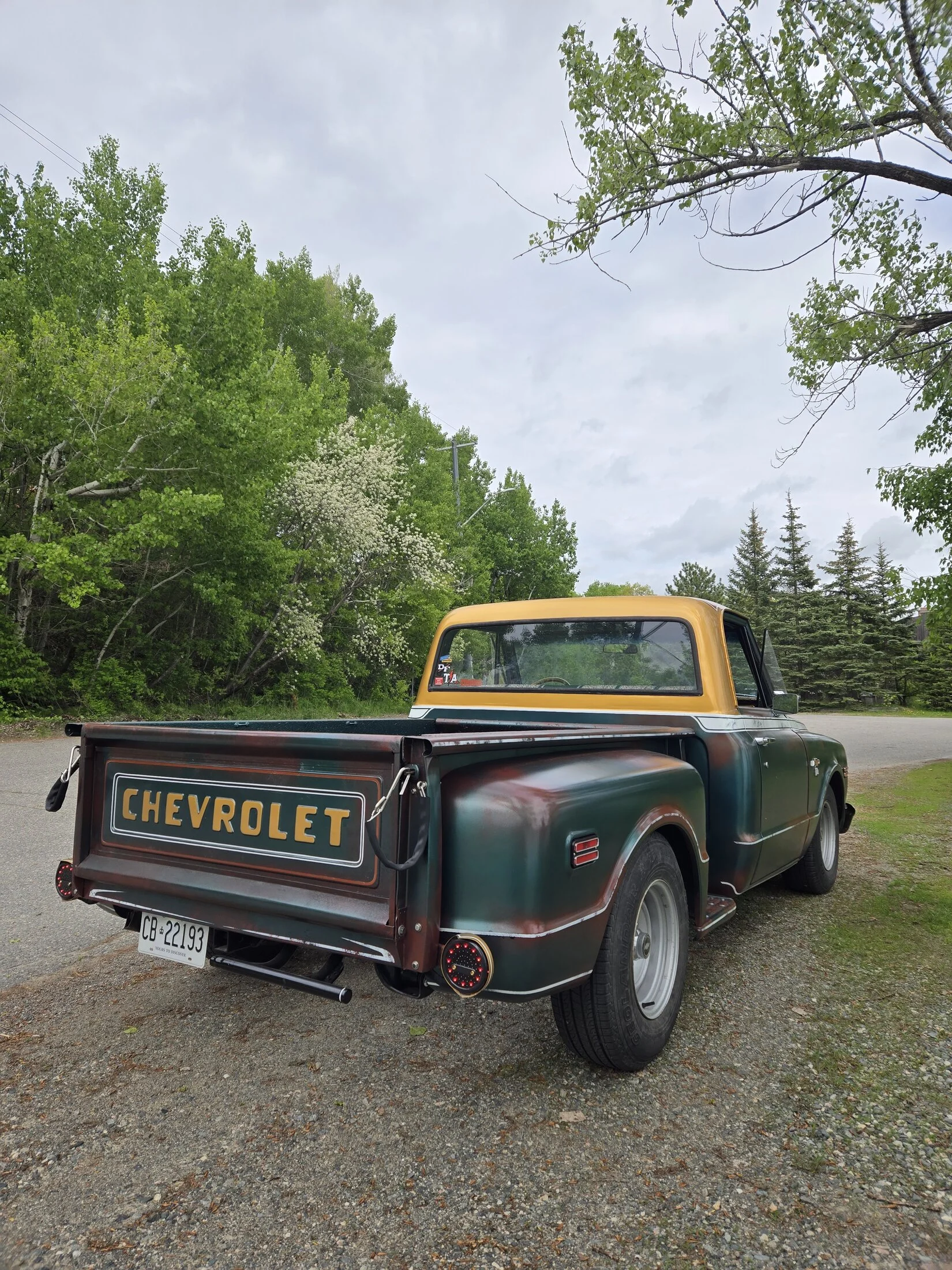

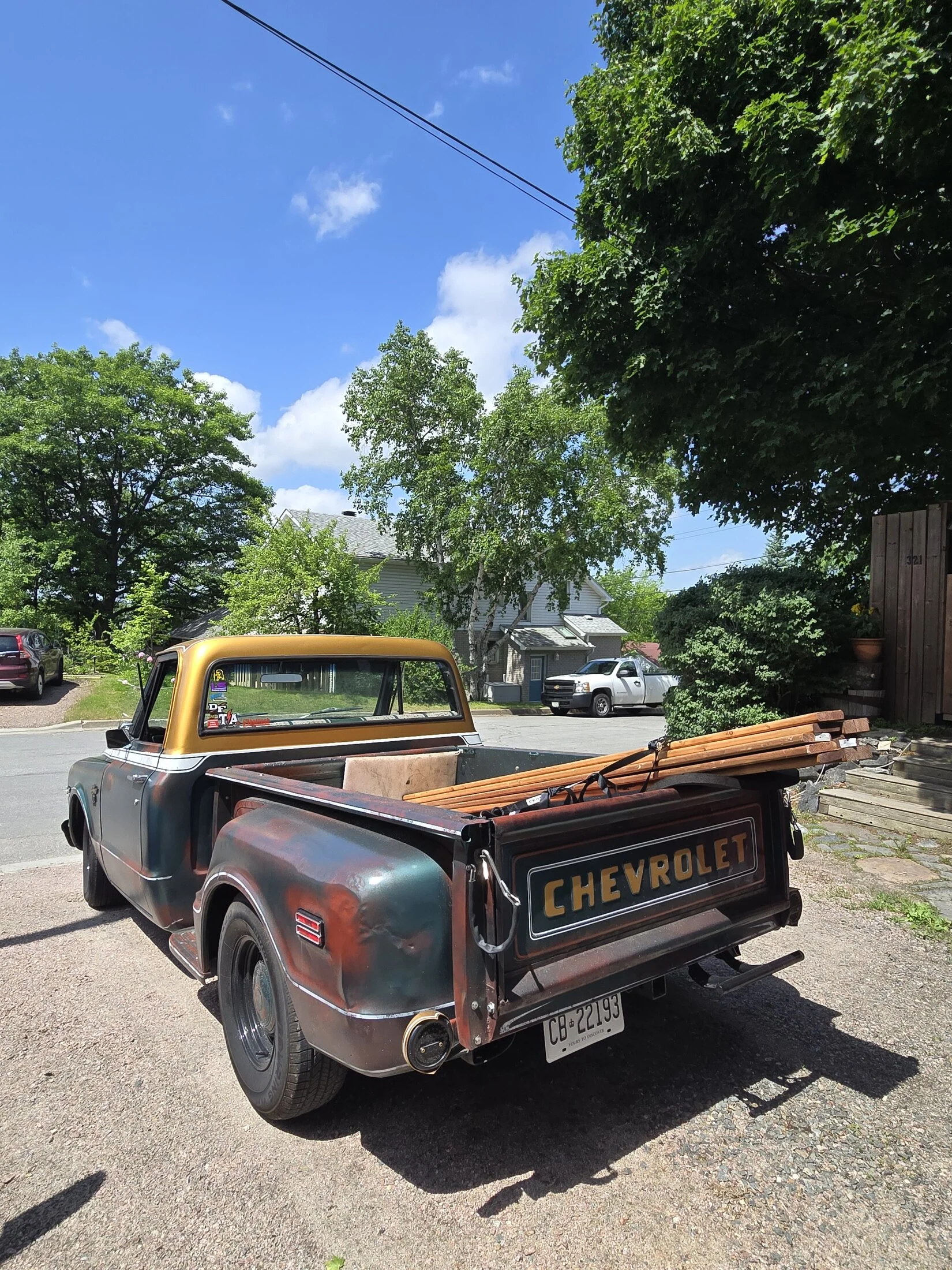

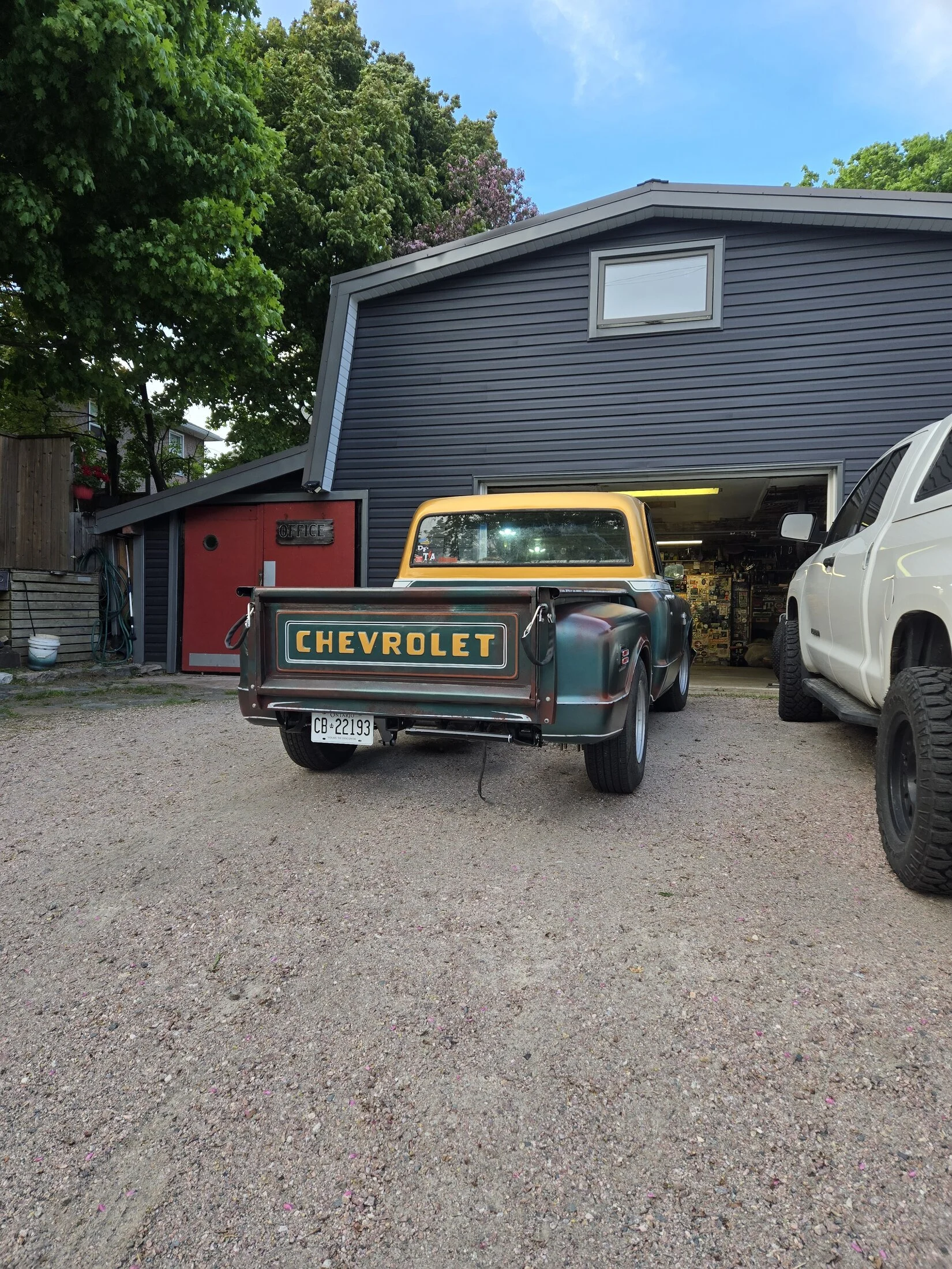

Back shots.
D

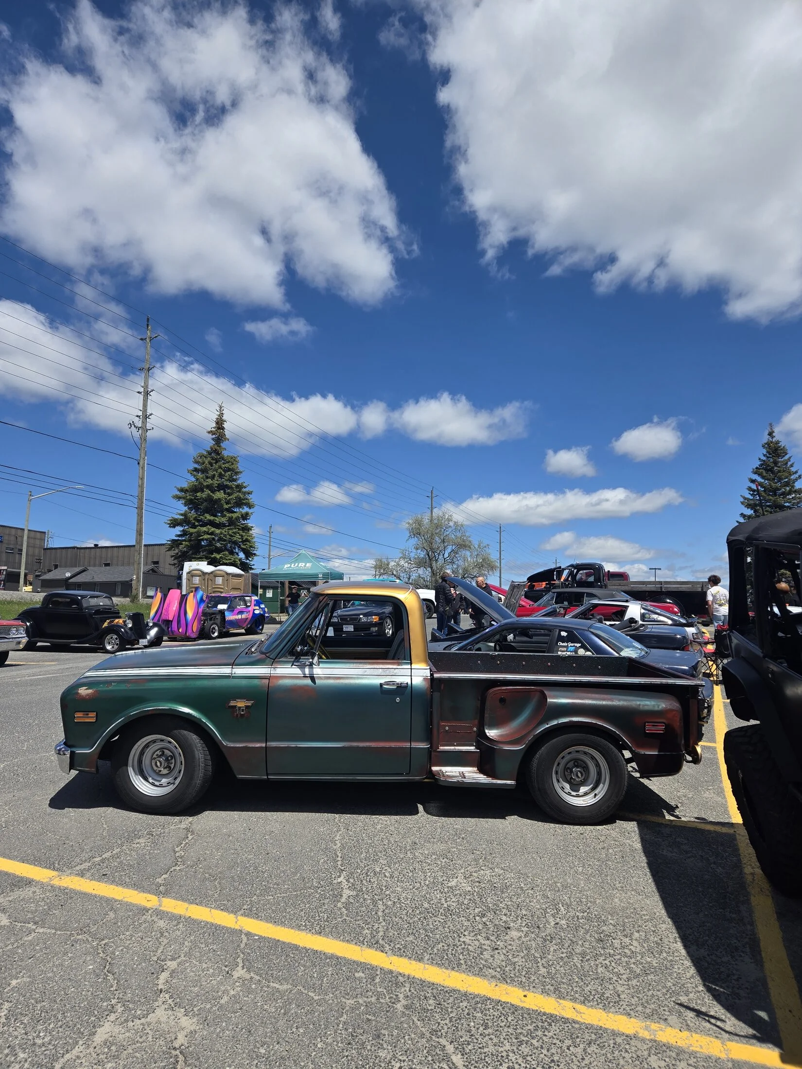

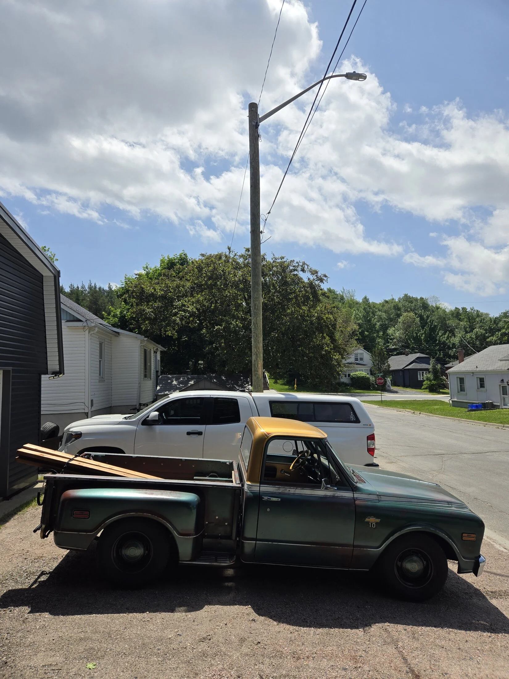

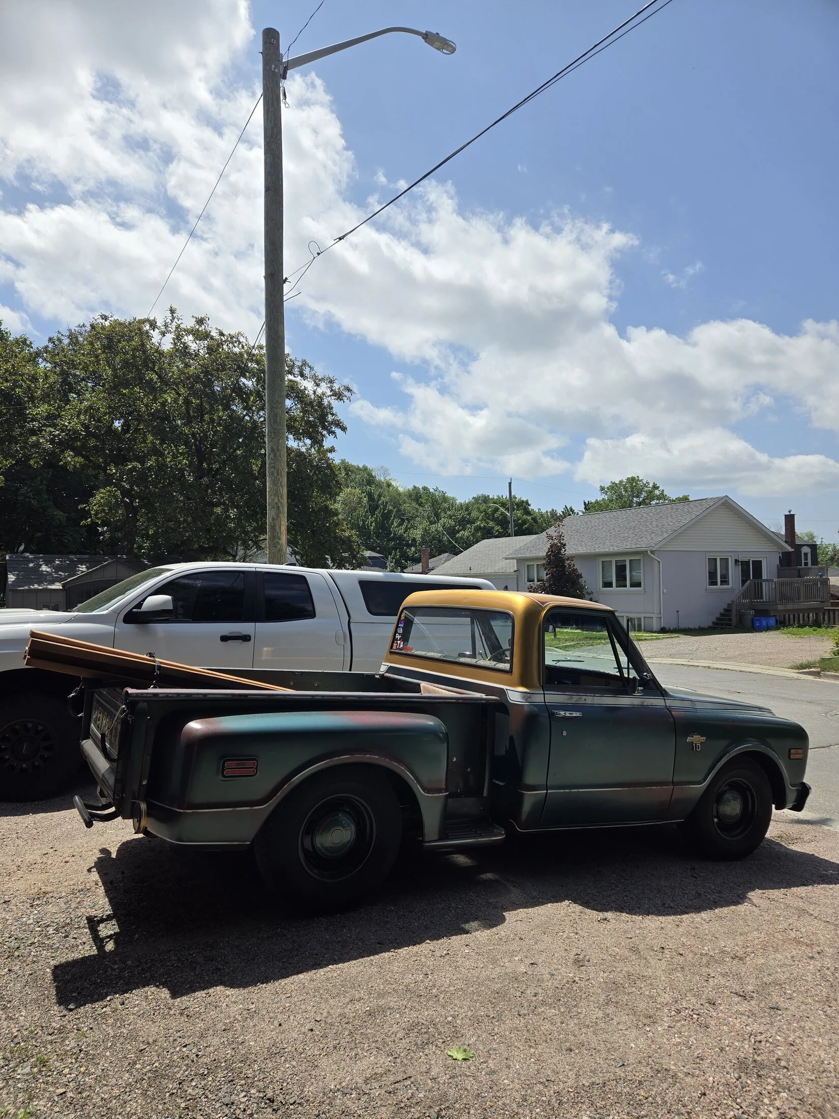

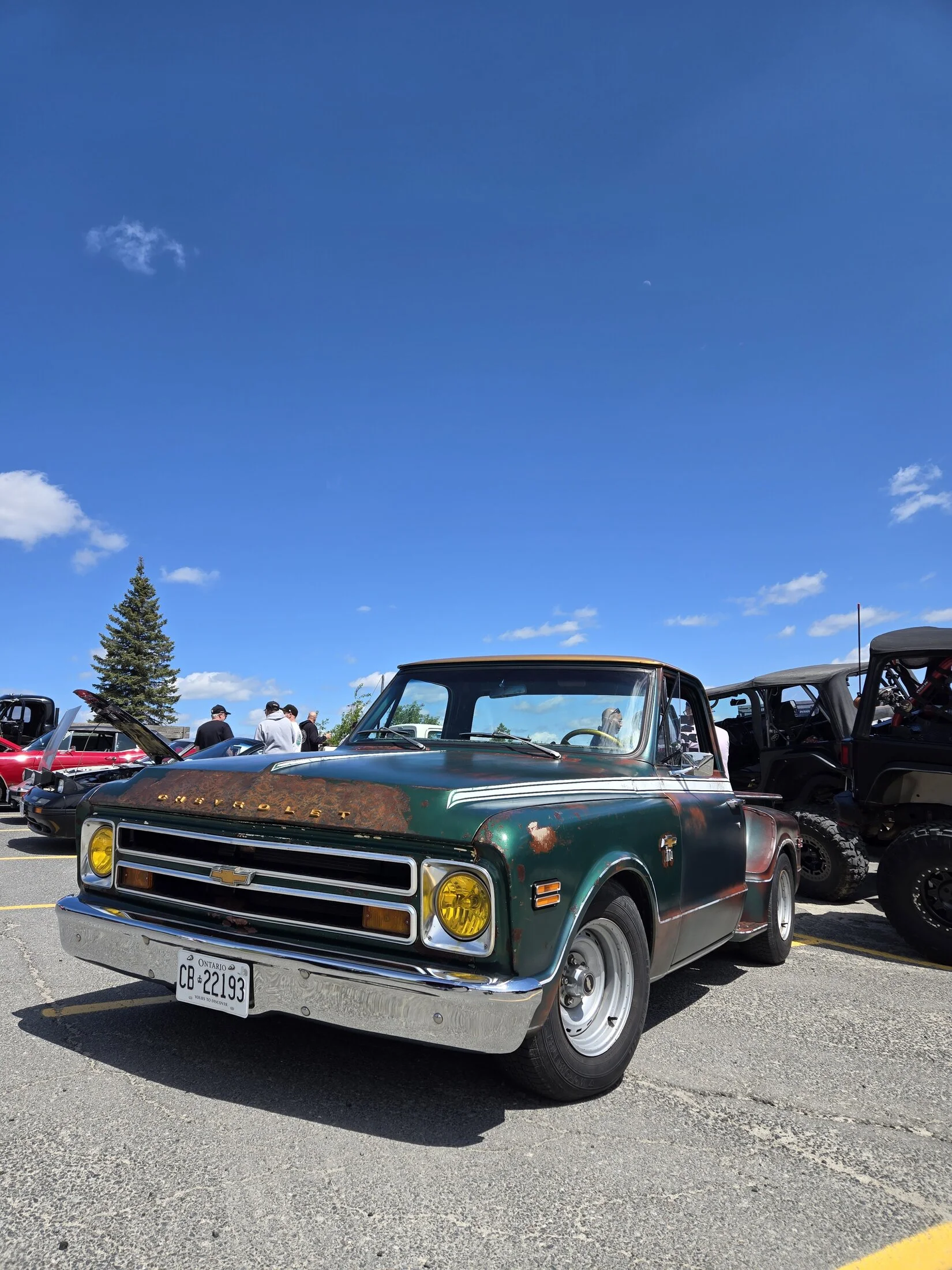

Hung out at the car show with my joop buddies a bit yesterday.

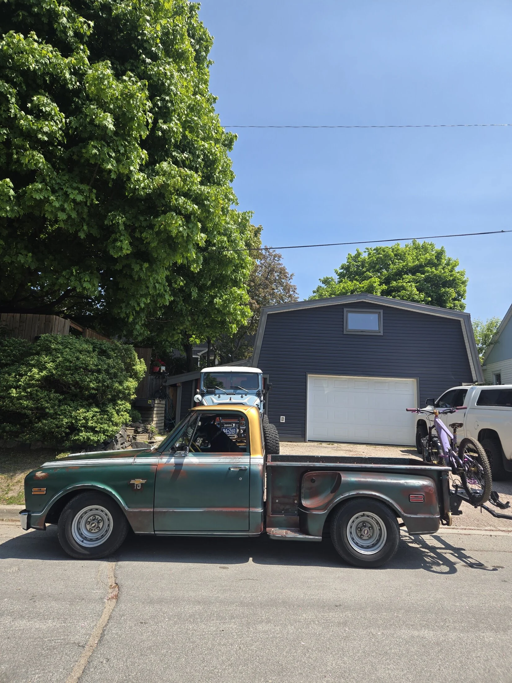

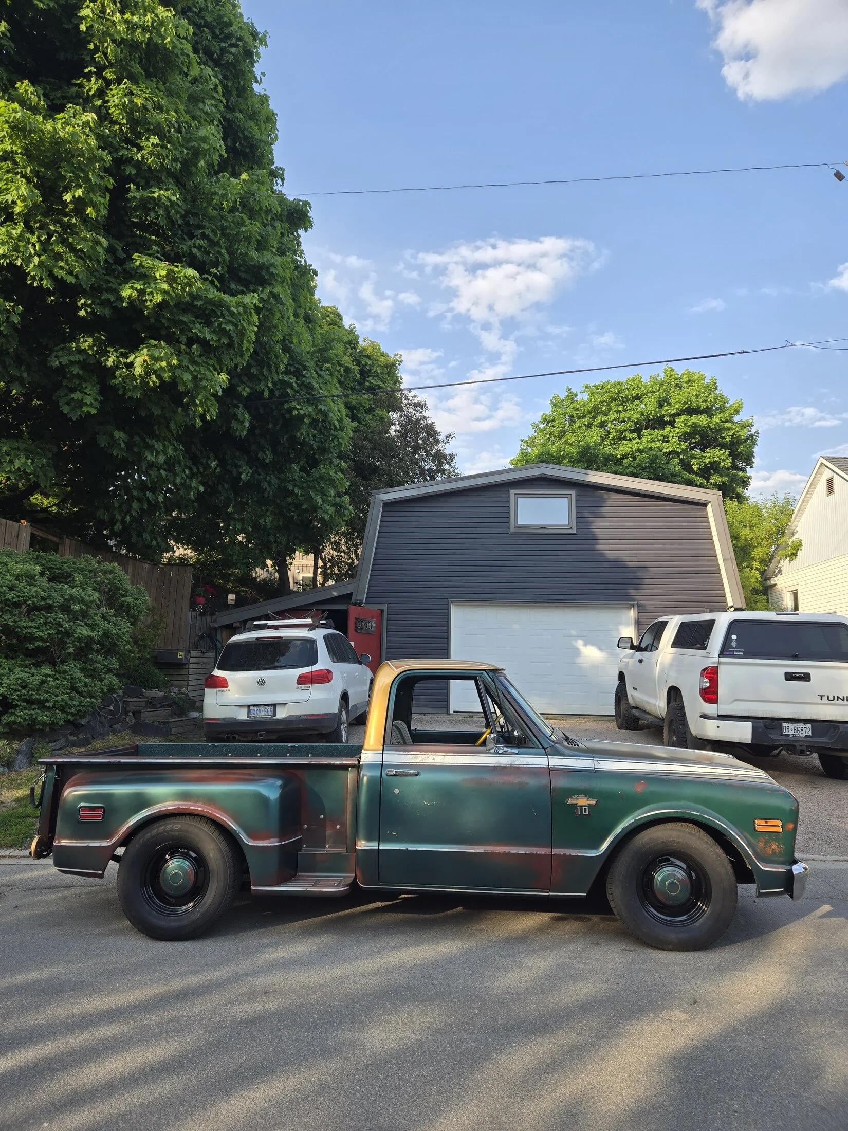

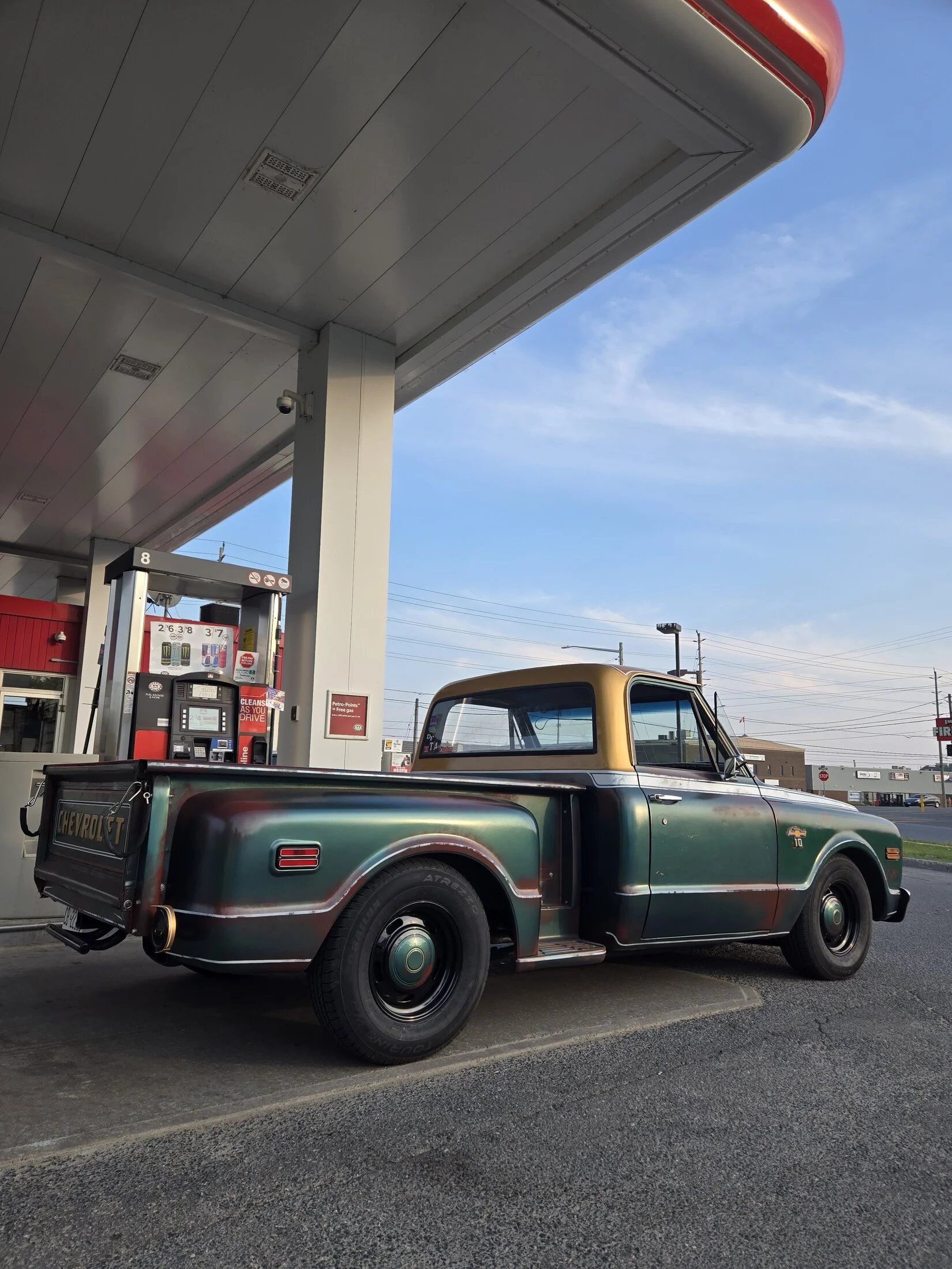

Daily driver things.
D

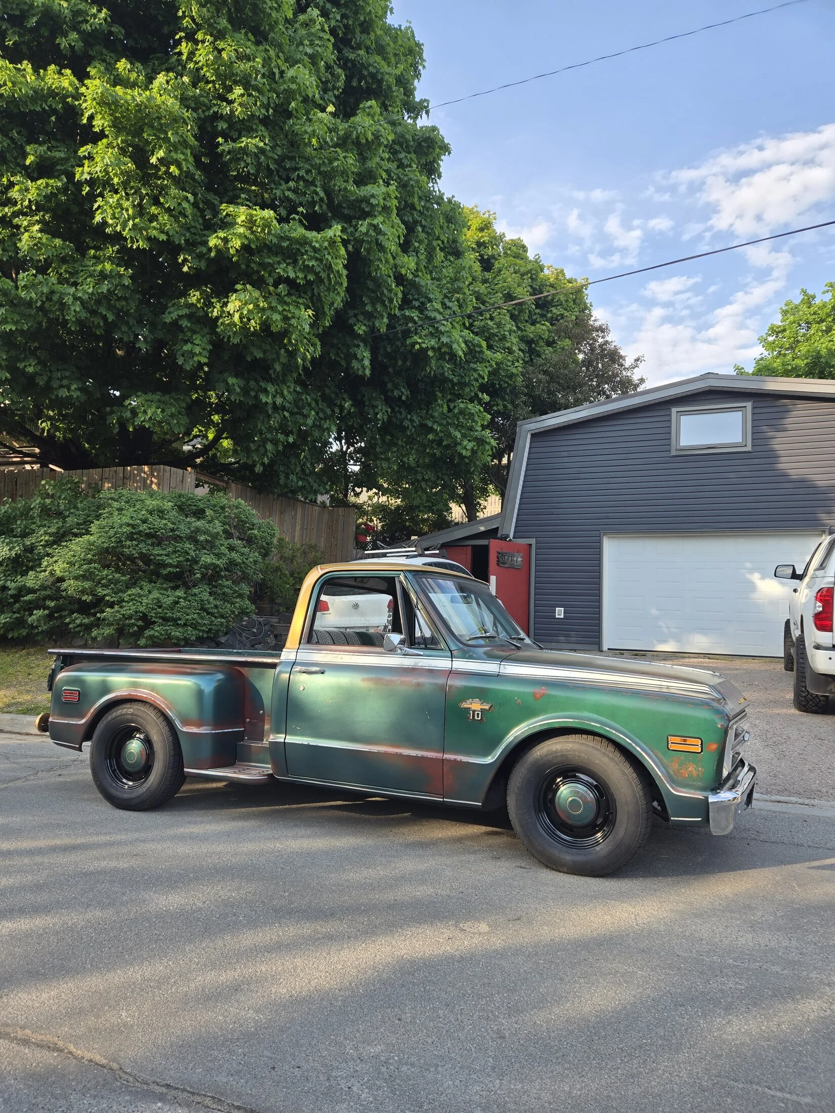

Finally got tires for the black steelies, it looks like its supposed to now. Wheels are 7" wide instead of 8 so they tuck a little better to boot.

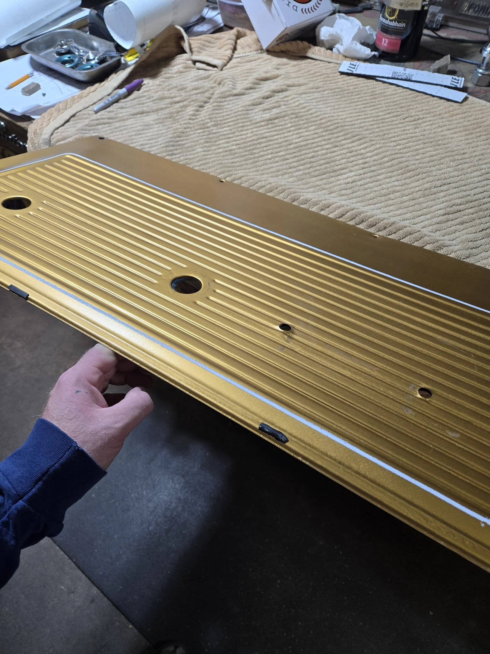

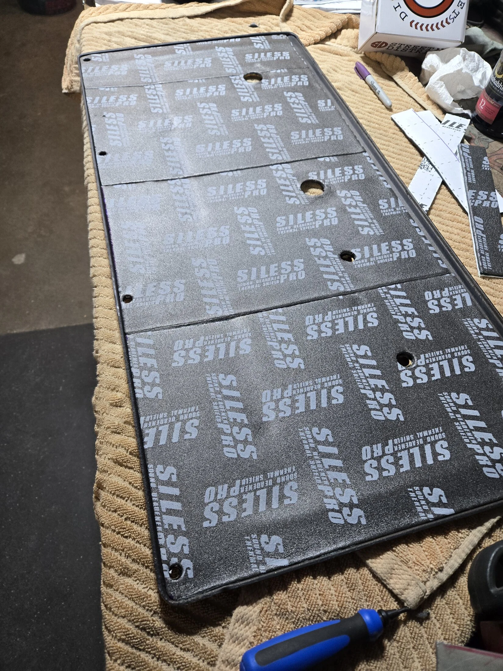

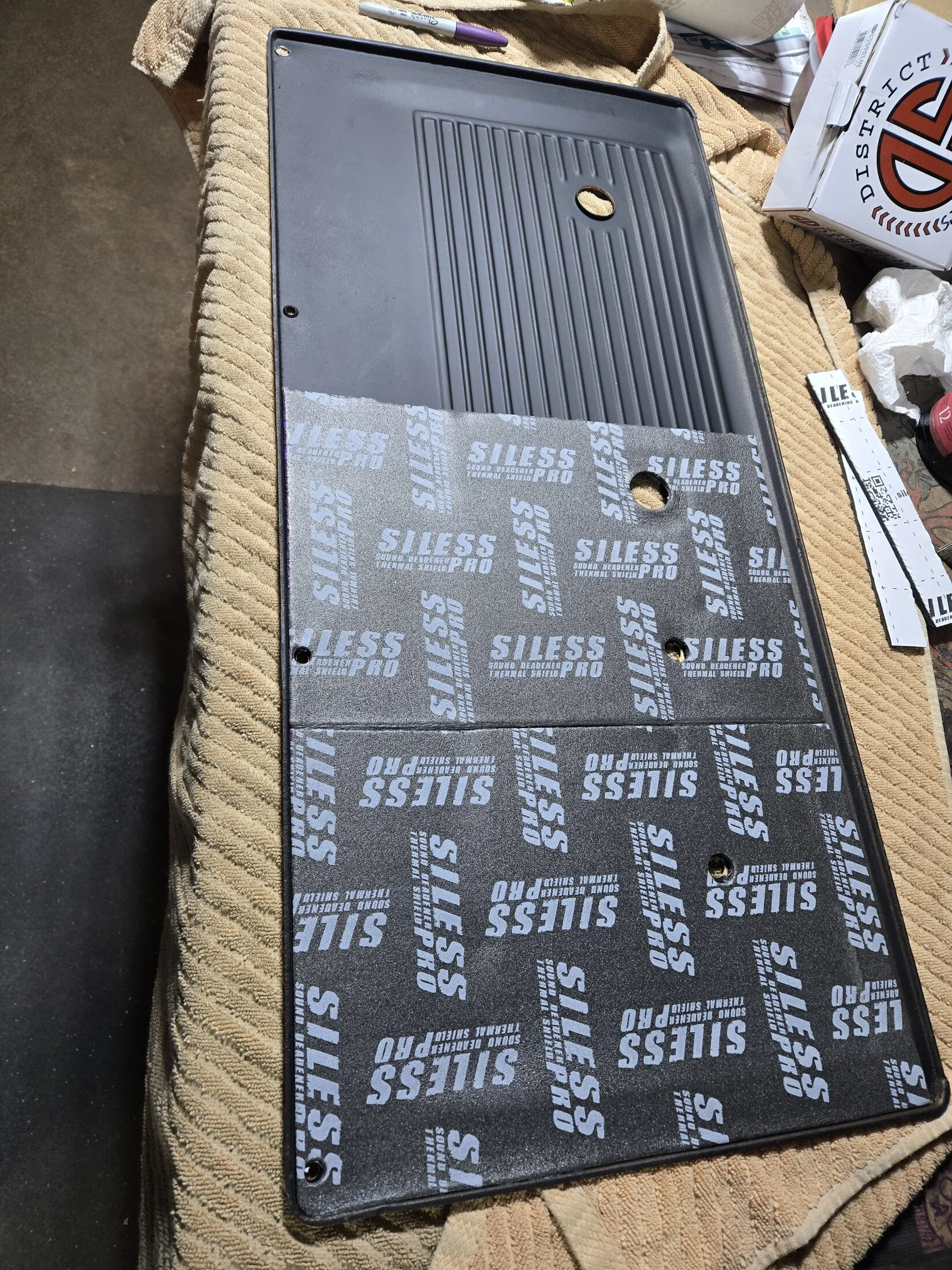

Fixed a driver door that didnt want to lock anymore, turns the striker plate on the cab end had moved in a bit. Took the opportunity to throw some sound deadening at the door panels and holy crap did that ever make a difference.

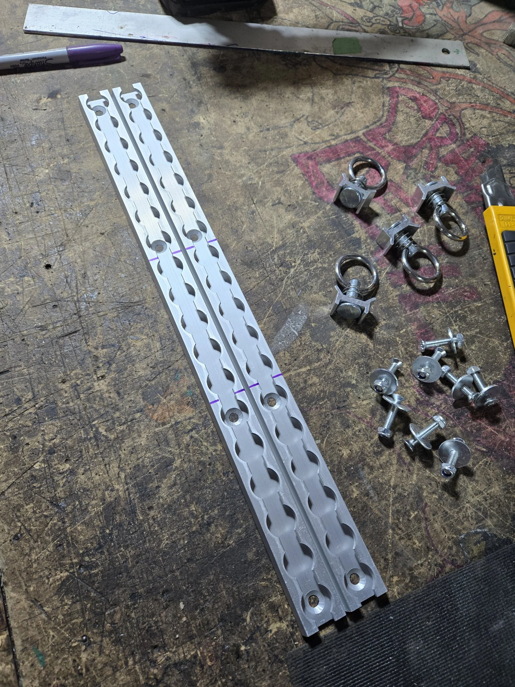

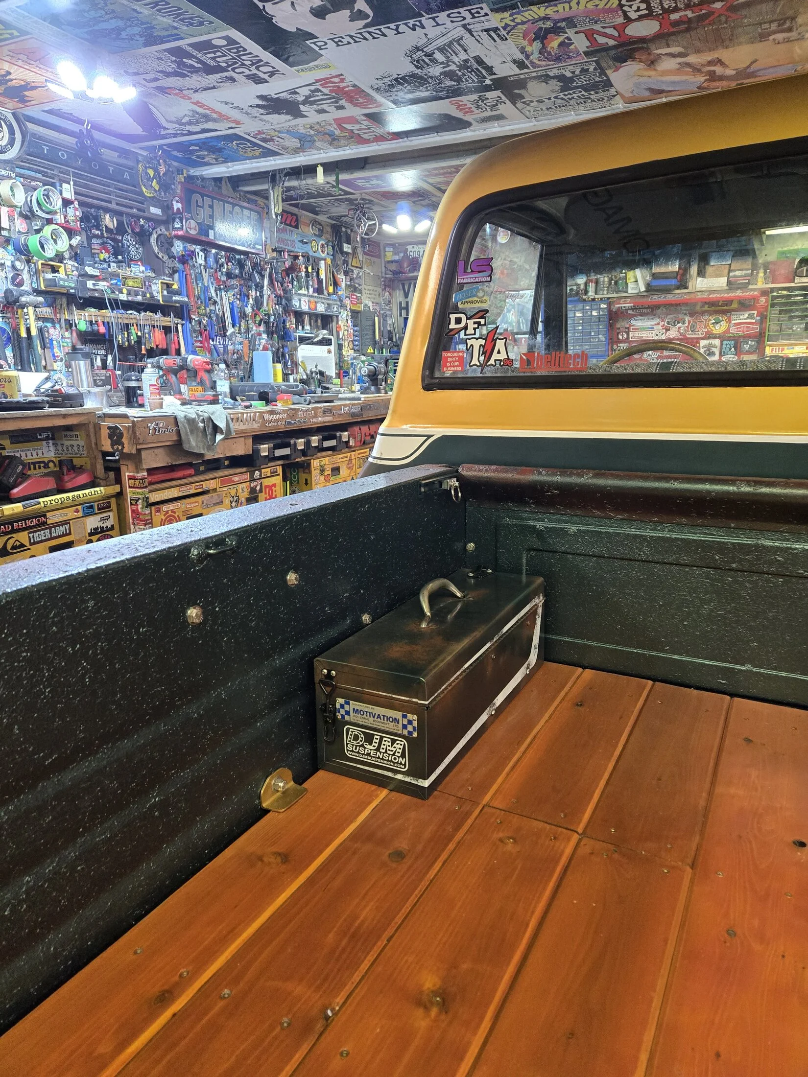

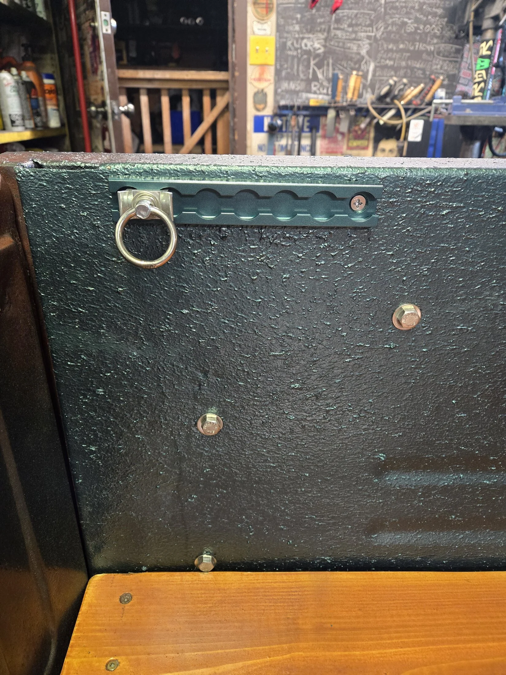

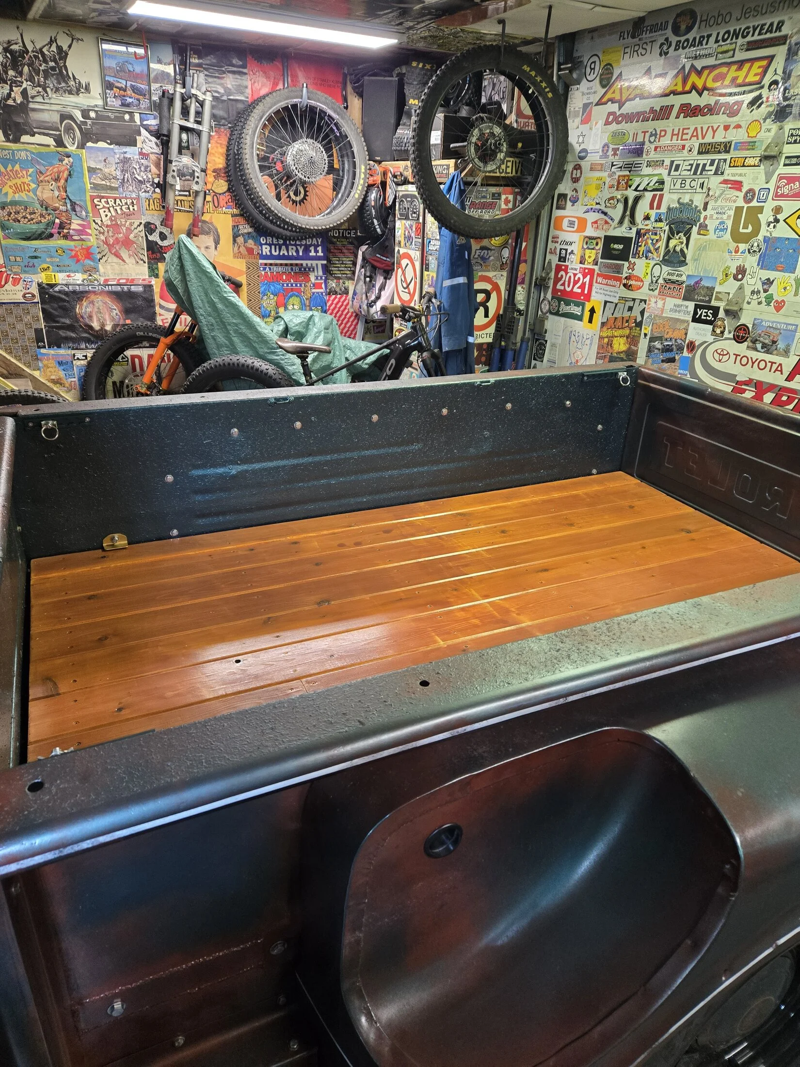

Threw on the adjustable tie down track things I picked up on a whim the other day and they turned out pretty mint.
D
