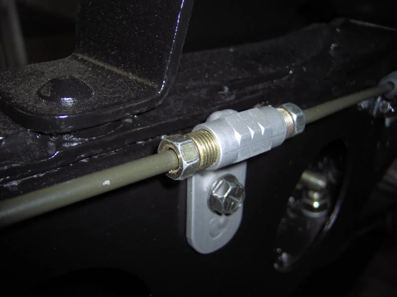

Next I needed a brake line longer than 60" but 60" was a long as I could source locally. I didn't want to buy a roll of brake line because I don't have the straightening roller tools plus I wanted to finish up with the type of line I started with so, I was able to find locally some steel M10 x 1.0 brake line couplers. (most are brass) I made a tab and welded this to the steel coupler. Then mounted the coupler to the frame. This long hard line runs from the double 90 to the rear brake hose bracket.
