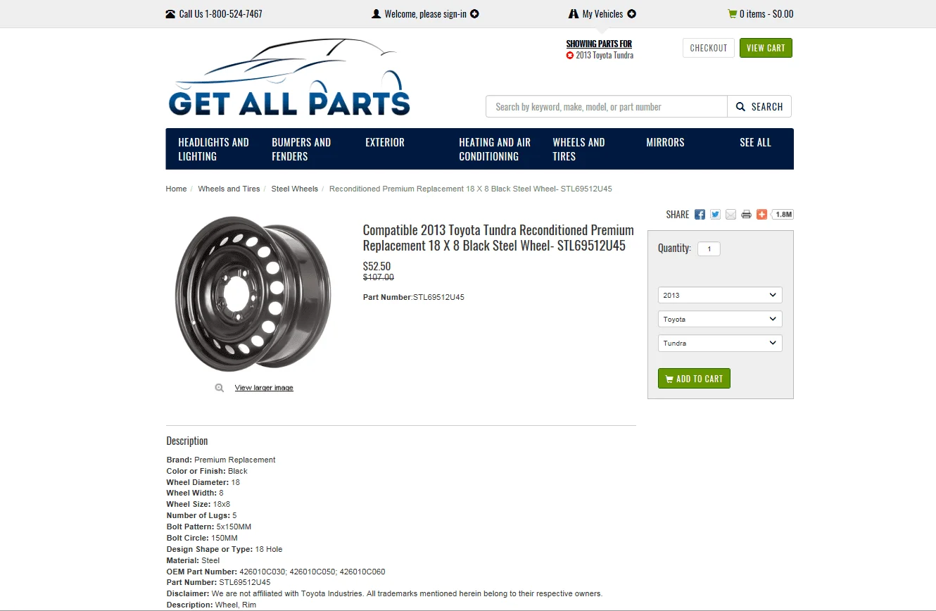

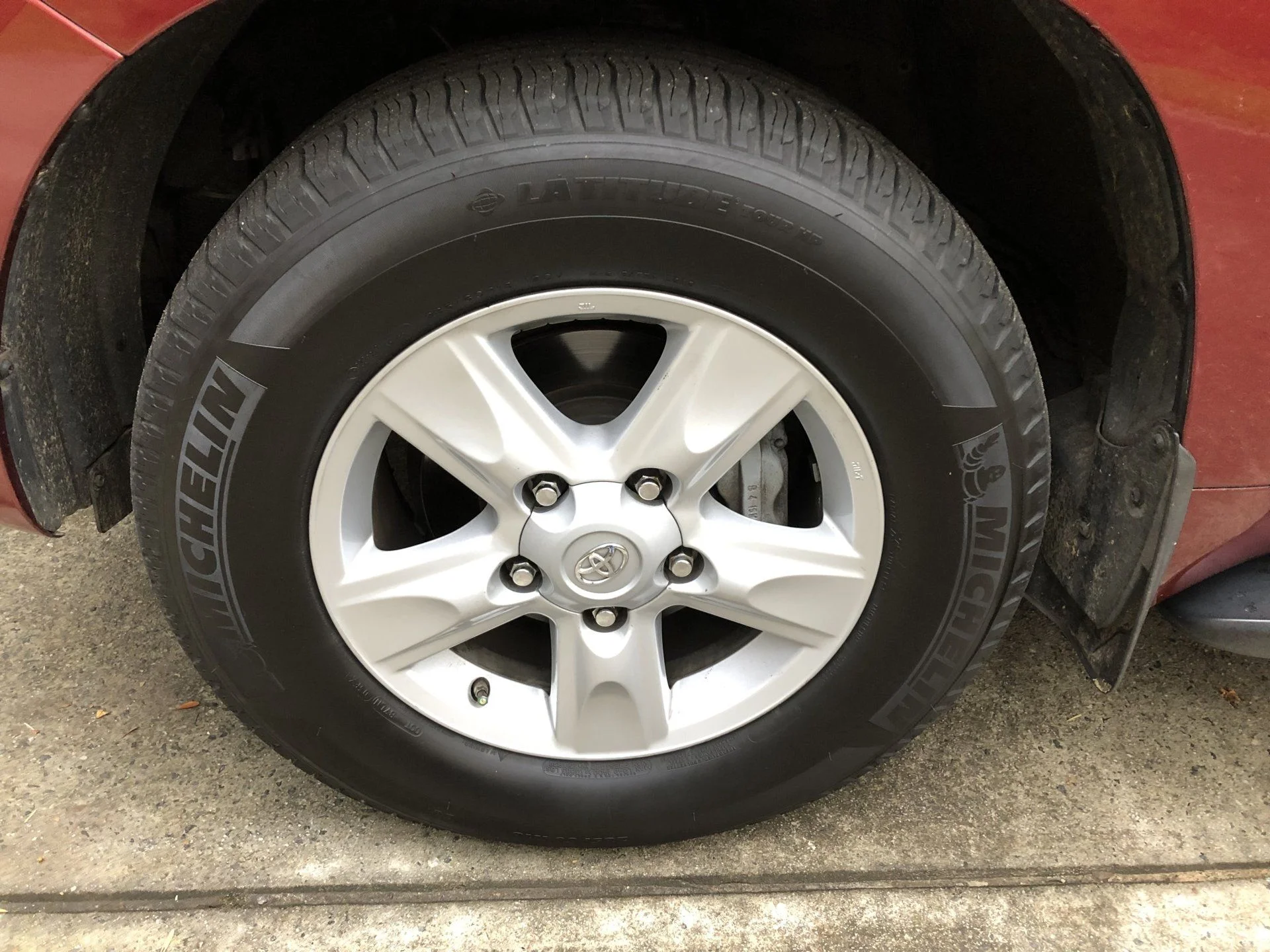

Alright guys, I know I've seen pictures of them when they are the 5 spoke style steel rims on a 200/570. But I can't necessarily find any information about the dish style.
If my searching is correct, I'd need acorn nuts, compared to the stock washer style on the LX.
BUT if I'm correct, it should bolt right up, and with the stock tire size (I think that's what's on them) it shouldn't rub. Haven't adjusted the LX in anyway. Just these have a more aggressive, winter thread if I'm reading correctly.

Yeah any stock 5x150 Tundra wheel will fit. Not sure I would go with steroids though given how cheap you can find TRD Sport 18” wheels. I’d get Hakka R3 SUVs for dedicated winter tires.

Correct on the acorn nuts. Torque is also different...~ 100 ft.lbs. for the nut-with-washer used on aluminum wheels, and ~ 150 ft. lbs. for steel wheels, e.g. Tundra. Hex sizes may be different, so keep 5 washer-nuts on board if you're not changing the spare...conical nuts on my winter Tundra steelies take a 19mm / 3/4" socket, washer-nuts use a 22mm. I mounted the steelies this afternoon, and tossed a long flex handle with a 19mm socket and 5 lug nuts into the left side tool box.
hth

yep ya need new lug nuts and then bolt them right up... I slapped some on my 100, good lookin wheel!
What wheels are those? Standard Tundra steelies? Black?
If that was for me, yep just Tundra steelies off the internet, 200 for the set free shipping...
Do you have a part number? Did you paint them or they came standard. I've done a websearch but haven't turned those up. Are they 5x150?

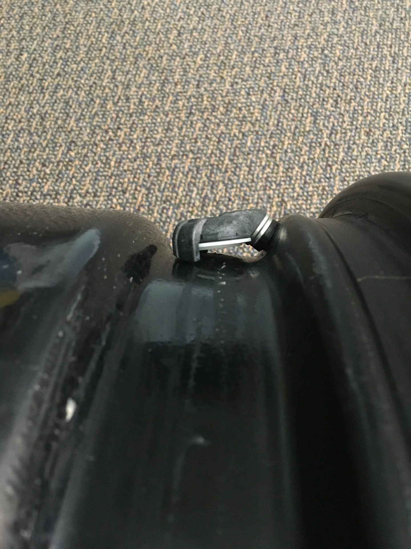

So. If I’m correct. The steel sensors and the aluminum rim ones are different correct?
If the seller has some off a 09 aluminum rim tundra.
I know I’ve read something about that, but they appear to fit in the images he sent so now I’m doubting my memory. But I’m not sure if they snug down more than he has them just placed in there.
I guess their isn’t a way to just turn off the system for this trip so they don’t blink the whole way saying it’s all flat?
Yes, they are different.
It appears that the sensor in your pics is the 40 Degree sensor which is not correct for use on the TRD 17" wheels - what you need is the 20 Degree sensor (Part# 42607-33011 or equivalent).
See pages 3 of 12 and 4 of 12 of this Toyota document to see which sensors you should have and how they should look when installed: https://www.toyotapartsdeal.com/ins...er TRD Alloy Wheel PTR45-34070-34120 IssF.pdf
Sensor Part# is on page 1.
HTH
That doesn't look like a good fit. Quite a gap there. You can always shave off the feet on the sensor. Or get other sensors like @gaijin suggests. I will add that aftermarket sensors are often adjustable angle.
See pages 3 of 12 and 4 of 12 of this Toyota document to see which sensors you should have and how they should look when installed: https://www.toyotapartsdeal.com/installation/40362D86F9D917D98825767800785BB2_Tundra_Sequoia_Land Cruiser TRD Alloy Wheel PTR45-34070-34120 IssF.pdf
HTH
I may be wrong, but these aren't 17" rims. they are the basic steel 18" ones. From what it's saying it needs the 40* ones on the steel ones.
(a) If previously removed sensor is 20 degree
sensor, proceed to step 3 (c). If
previously removed sensor is 40 degree
sensor (e.g. Tundra styled steel wheels),
you must install new 20 degree sensors
into accessory wheels. When installing
new 20 degree sensors, you MUST
