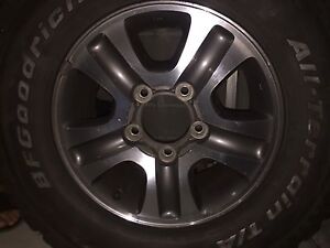

Yes, stock is +60mm offset. If you really want OEM 17's, you can get them. You just need to dig for them.

I have never seen OEM 17s for 100. Any pictures?
I really appreciate the link, will call tomorrow. If they have 5, I'll be pulling the 34x10.5R17s off the FZJ80 (so I can get 37s for it :clap:).
Using OEM 17s, the "34s" (actually closer to 33s) will fit right?
If you are talking about 285/75R17's... I think it is a great size for the 100 and most tires in this size are either close to or pretty much 34's.
