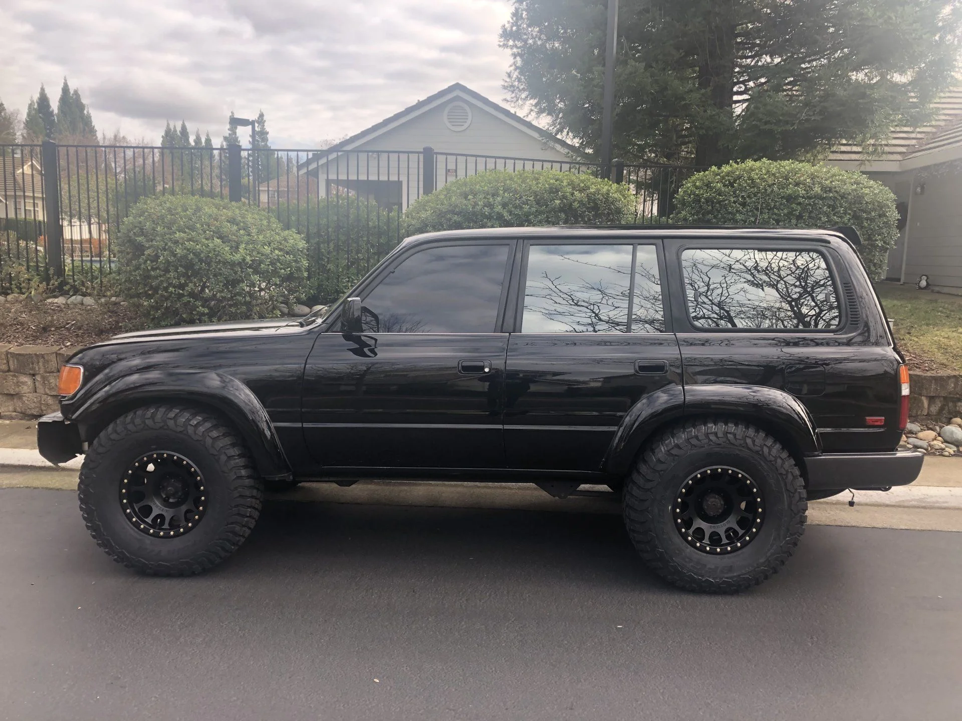

Test fitted my new wheels today. They are 17x9, with -38mm offset, 3.5 BS. Tires are pretty much flush. So to stick out without spacers will be hard to find.
my wheel sticks out about 2" from the flares, they measure 80" outside tire to outside tire. they are 17 x 8.5 with 3.25" BS
